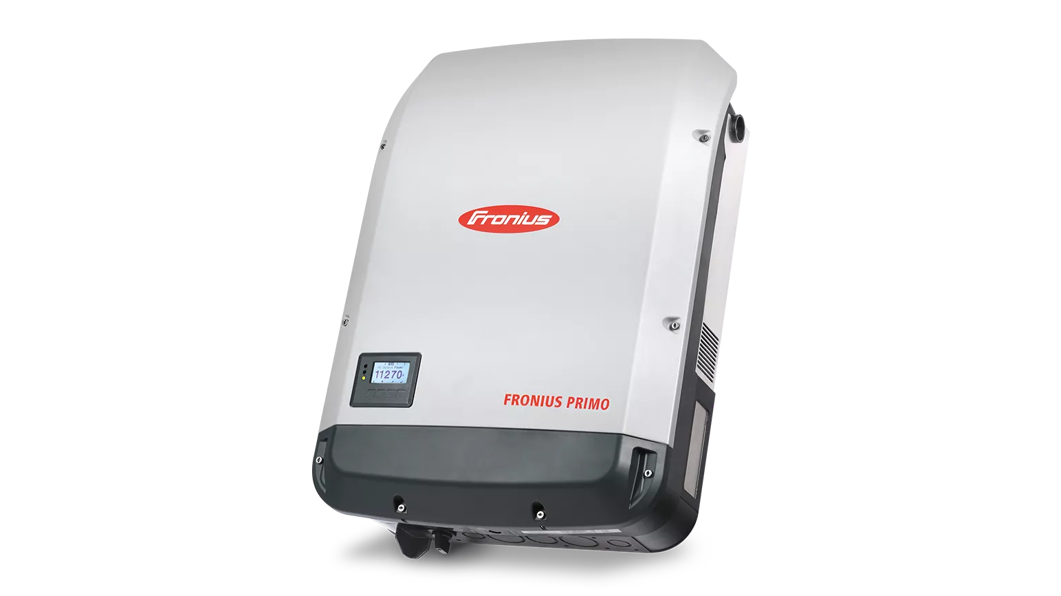

Fronius Primo UL
The communicative inverter for private households.
The Fronius Primo inverter series has been specially developed for the demands of the North American market. With power categories from 3.8 to 15 kW, the single-phase, transformerless device is the perfect inverter for private households. Its innovative SuperFlex Design provides maximum flexibility in system design, while the SnapINverter mounting system makes installation and maintenance as easy as possible. The communication package included as standard, with WLAN, energy management, several interfaces and much more besides, makes the Fronius Primo a communicative inverter for home owners. Standard equipment also includes a built-in arc detector (AFCI = Arc Fault Circuit Interrupter), in keeping with all other North American SnapINverters.
