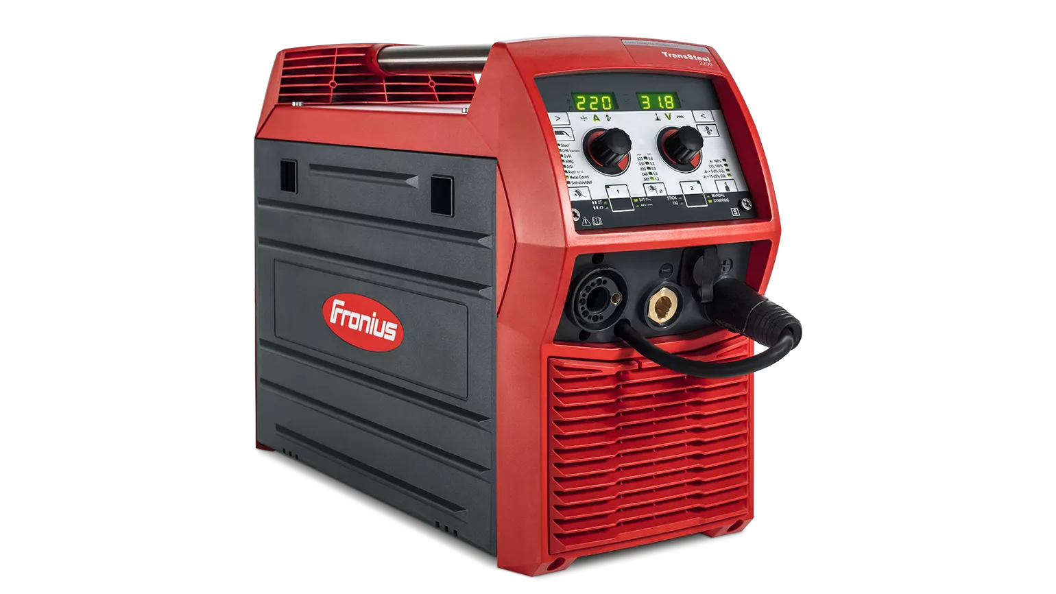

TransSteel Compact
No matter what the welding task - MIG/MAG, TIG and electrode welding with just one device.
Whether a construction site or a workshop, from agricultural enterprises to metalworking companies – for assembly, repair, and maintenance work, the TransSteel Multiprocess series masters the MIG/MAG, TIG, and electrode welding processes to professional levels.
The TransSteel 2200 is a compact, 3-in-1 solution. It is the first single-phase inverter power source from Fronius that is also multiprocess-capable, bringing together MMA, MIG/MAG and TIG in a single device. The TransSteel 2200 is characterised by the intelligent design of the device, ease of use, robustness and a high level of reliability. Weighing only 15.5 kg, it is also one of the lightest devices on the market.

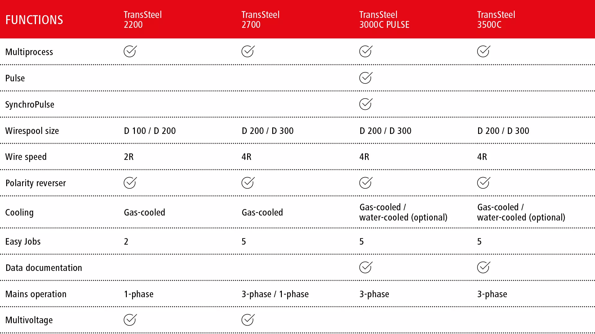

Technical Data
General Data
Mains voltage230V
Mains voltage tolerance-20% / +15%
Mains Frequency50-60Hz
Welding current min.10 A
Welding current max.230 A
Welding current / Duty cycle [10min/40°C]210A / 30% MAG, 180A / 35% MMA, 230A / 35% TIG
Welding current / Duty cycle [10min/40°C]170A / 60% MAG, 150A / 60% MMA, 200A / 60% TIG
Welding current / Duty cycle [10min/40°C]150A / 100% MAG, 130A / 100% MMA, 170A / 100% TIG
Operating voltage min.14,5 V
Open-circuit voltage90 V
Degree of protectionIP23
Dimension / length560 mm
Dimension / width215 mm
Dimension / height370 mm
Weight16,2 kg
Weight incl. packaging19,1 kg
Mains cable includedYes
Earth connectionDinse
Length of mains cable2500 mm

    The TransSteel multiprocess series
    No compromises. TransSteel multiprocess.
    One device - for all manual welding applications
    Combining MIG/MAG, TIG, and electrode welding in one device means you no longer have to purchase any other power sources. There is absolutely no difference in the welding performance of the respective process compared with a dedicated device.
    118 characteristics*
    / Steel, CrNi, AlMg, AlSi, Metal Cored, Rutil FCW, Basic FCW, self-shielded wires
    / 0.8 – 1.2 mm wire diameter
    / Eight different gas mixtures
    Ready to weld in three steps
    The intuitive operating concept enables welders to start work straight away – no prior knowledge of the device is required. All the essential welding parameters can be viewed and adjusted on the front panel. The only parameters that have to be selected before welding begins are the gas, wire diameter and material thickness.
    70% less rework, 30% faster welding
    The Pulse function of the TransSteel 3000C permits faster welding speeds on thicker materials. The pulsed arc also reduces the amount of rework, as less welding spatter is generated.
    * Maximum number of characteristics (TransSteel 3000 C Pulse), will vary depending on the version.
