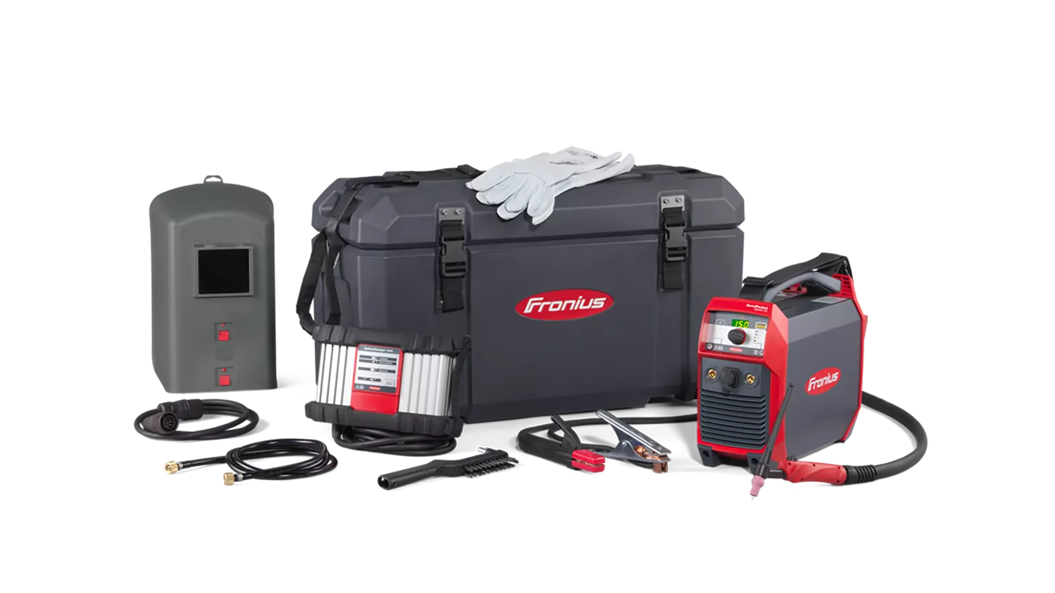

AccuPocket
With the AccuPocket, access to mains electricity is no longer necessary. Welding tasks involving up to eight 3.25 mm or up to eighteen 2.5 mm electrodes can be carried out autonomously. A small, compact 2 kVA generator is sufficient for welding applications on a larger scale. And all without any restrictions on welding power or the quality of the arc. The very latest functional design, with dimensions reduced to a minimum, a low weight and a robust construction, make AccuPocket the perfect partner on any construction site.
Product details
General Data
Welding current min.10 A
Welding current max.140 A
Open-circuit voltage91 V
Degree of protectionIP23
Dimension / length435 mm
Dimension / width160 mm
Dimension / height310 mm
Weight18,81 kg
Interference emission classA
Anti-stick
If a short circuit occurs that causes the electrode to stick during MMA welding, the power source is switched off immediately. This prevents the electrode from burning out.
HotStart
To make the electrode easier to ignite, the current at the power source is increased for a fraction of a second during ignition. The HotStart function was specially developed for welding with rutile and Cel electrodes.
SoftStart
The SoftStart function ensures a stable arc at the start of welding and was specially developed for electrodes that are welded with a low welding current (basic electrodes).
No grid-voltage dependence
The power sources are available in country-specific variants, meaning they can also be used in regions with differing mains voltages. For more information, please contact your local Fronius contact.
