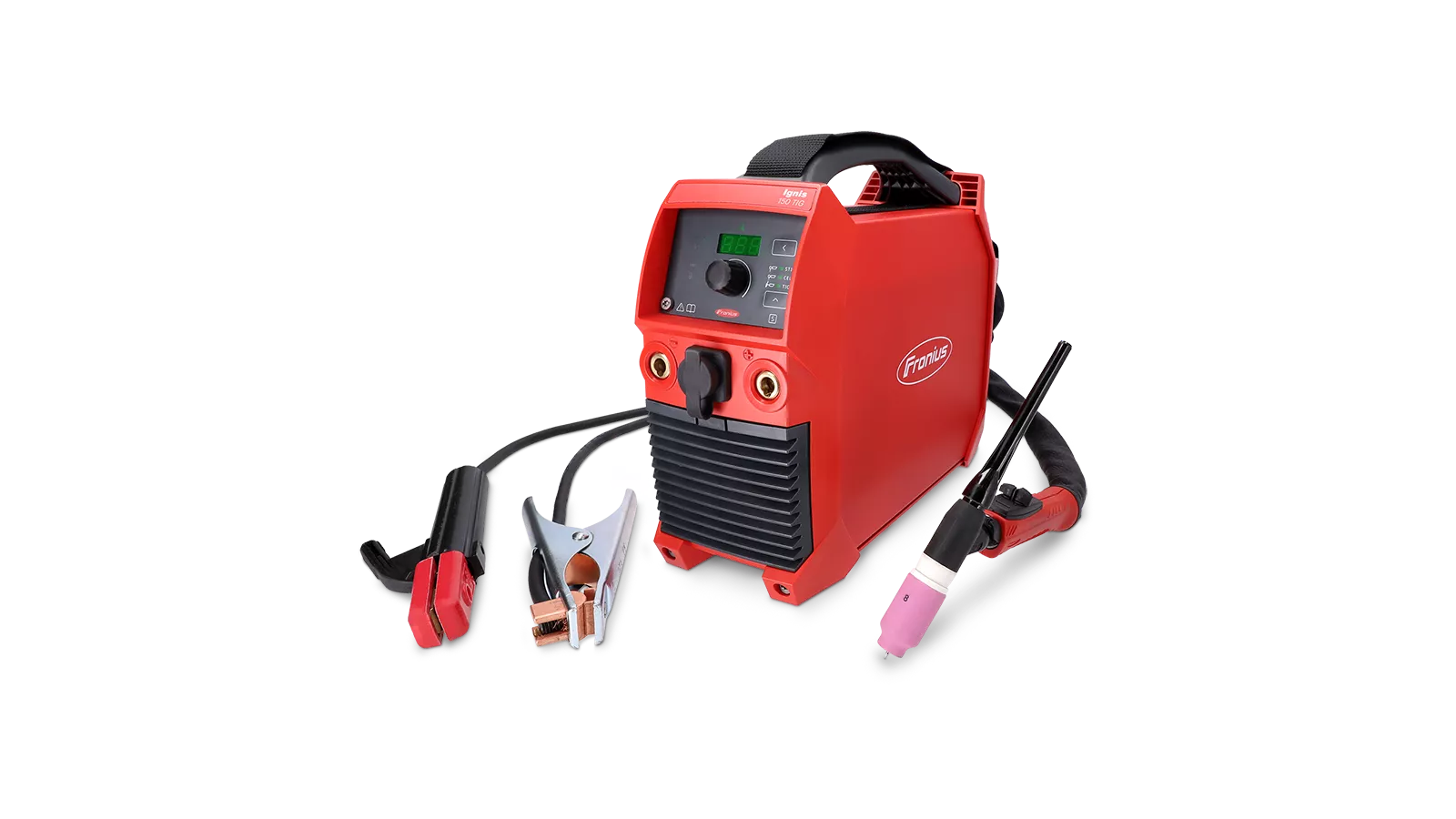

Ignis TIG
Technical Data
General Data
Welding current min.10 A
Welding current max.150 A
Operating voltage min.20,4 V
Open-circuit voltage96 V
Degree of protectionIP23
Dimension / length365 mm
Dimension / width130 mm
Dimension / height285 mm
Weight6,6 kg
Mains cable includedYes
Earth connectionDinse_small
Length of mains cable2500 mm
Maximum working voltage28 V

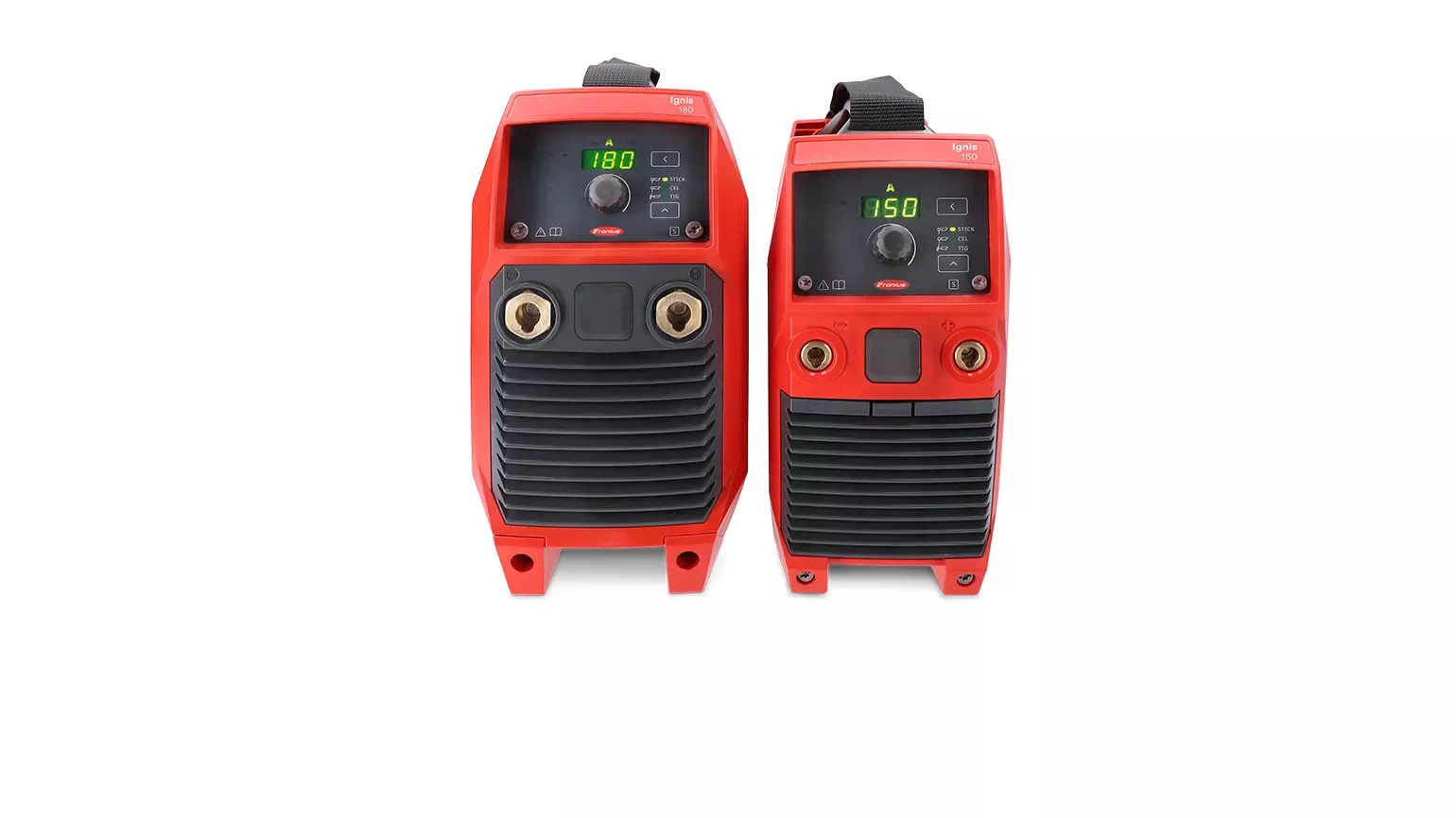

Function overview
Functions
Ignis 150 Ignis 150 TIG Ignis 180 /
180 XT
Ignis 180 TIG /
180 TIG XT
 HotStart x x x x
 SoftStart x x x x
 Anti-stick x x x x
 MMA Pulse x x x x
 TAC tacking function
x
x
 TIG Comfort Stop x x x x
 TIG Pulse
x
x
 TIG Multi Connector
x
x
 TIG welding torch operation
x
x
 Remote control operation
x
x
 Time shutdown
(300 s/900 s/off)
x x x x
 TrackingArc x x x x
 XT variant
x x
