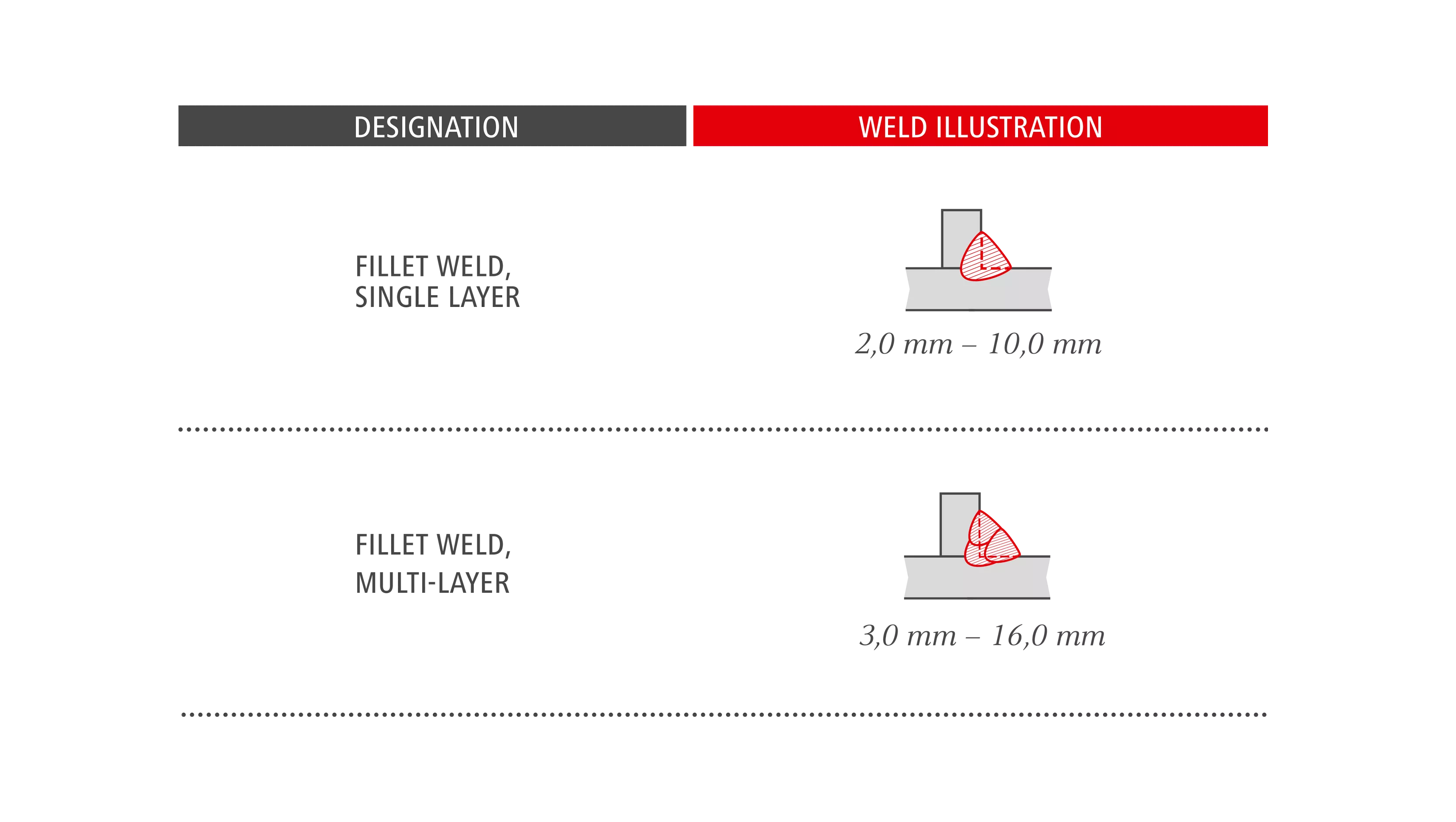

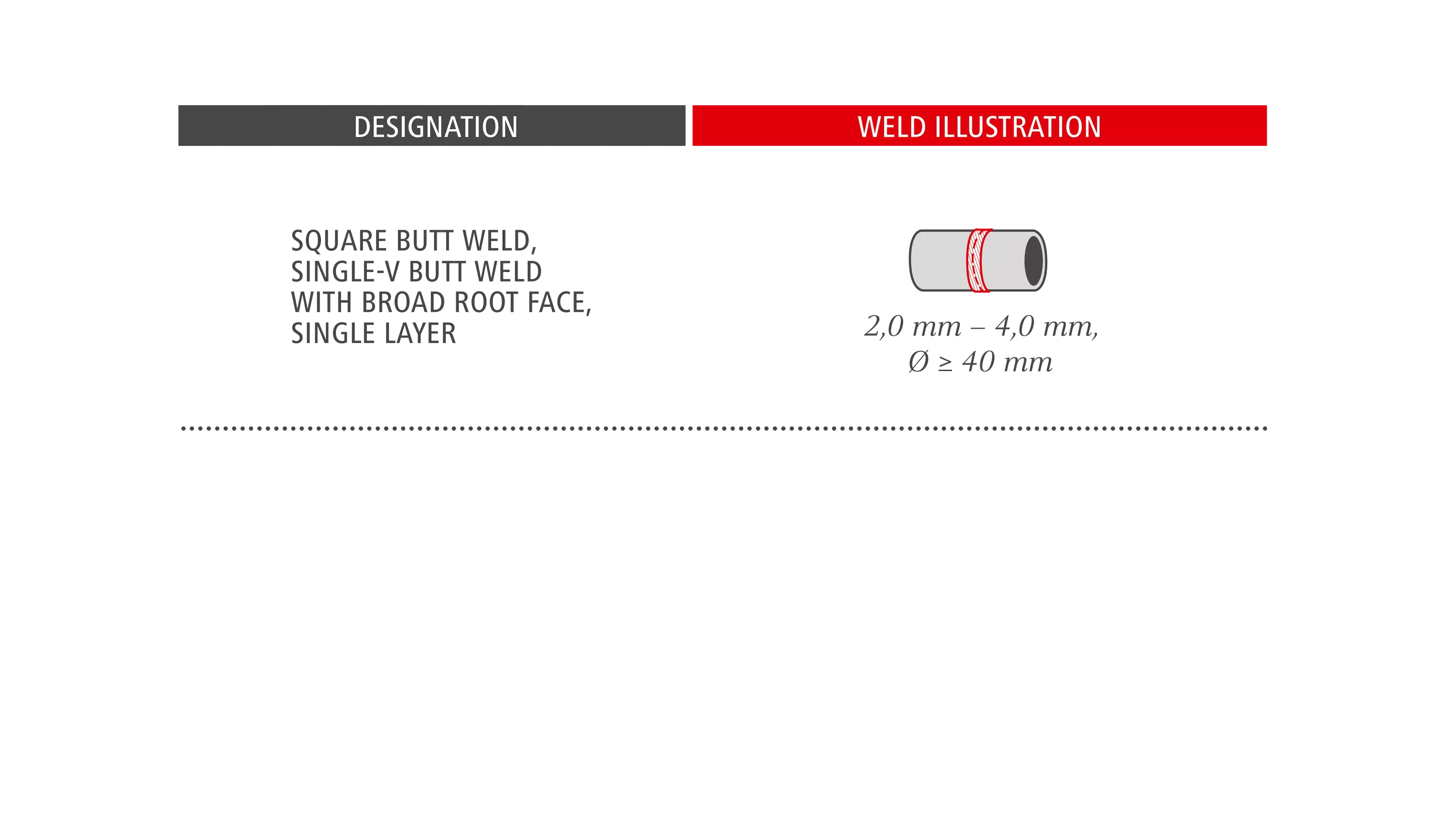

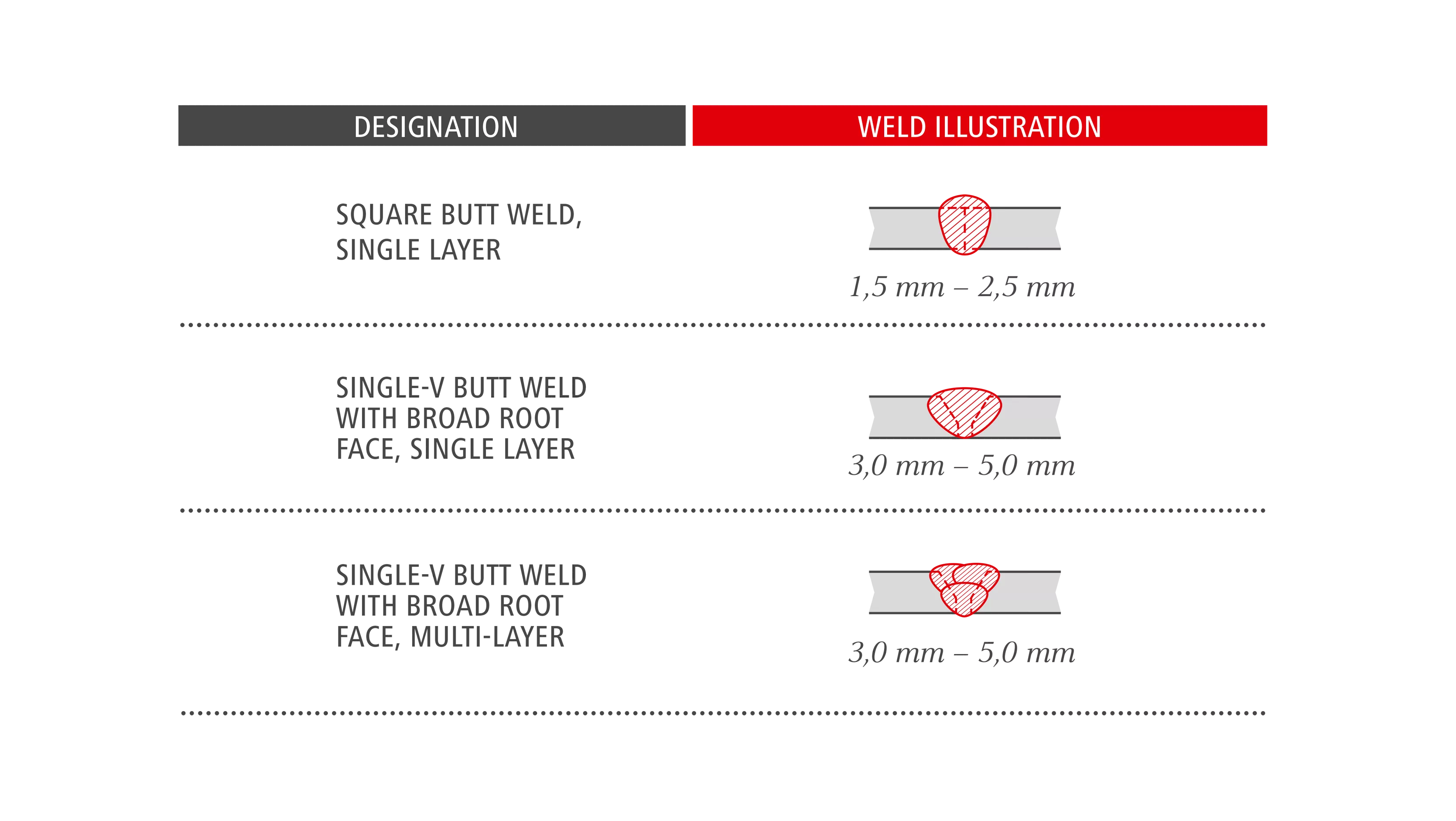

The WPS package steel includes 121 welding procedure specifications for manual applications to material quality up to S460N. Additionally, pipes and tubular constructions are included.
Included welding instructions
- MAG process
 - Material group: 1.3 (up to grade S460)
 - Filler material: G3Si1, G4Si1
 - The PA, PB, PC, PF positions
 - Sheet thickness range 1.5 mm to 50 mm
