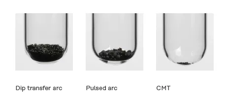

  • 99 % less spatter*

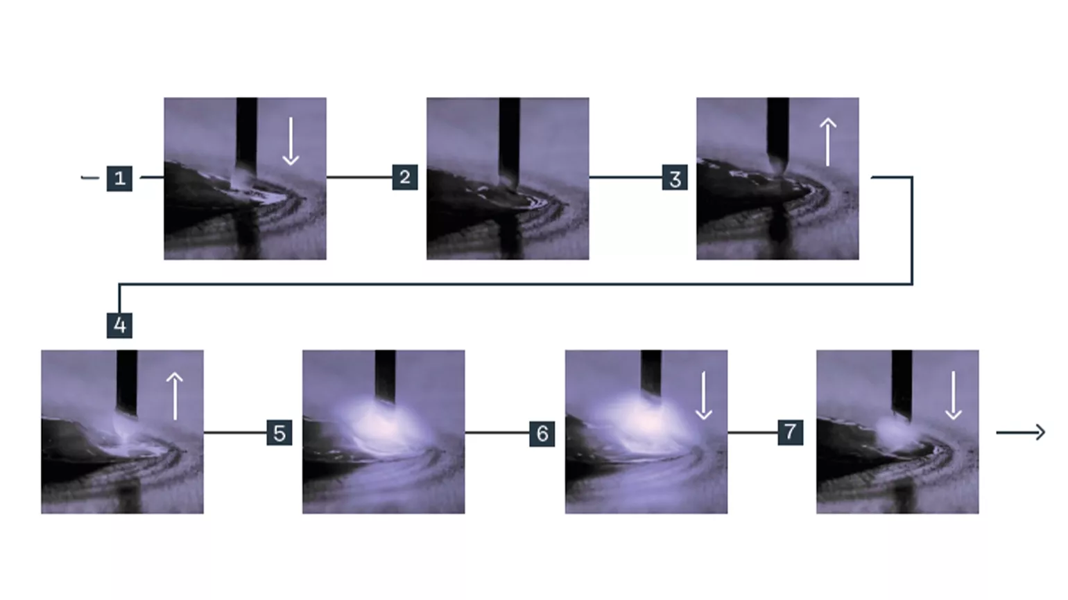

During welding, the wire moves forward and is pulled back again as soon as the short circuit occurs. As a result, the arc only introduces any heat for a very brief period during the arc-burning phase. The result is spatter-free material transfer. The arc remains stable, regardless of the surface characteristics of the workpiece or how quickly the welding specialist works. This means that CMT can be used anywhere and in any position.

Welding does not inevitably have to mean welding spatter and rework. CMT promotes controlled droplet detachment during the short circuit, while the current is kept low. The result is virtually spatter-free material transfer.

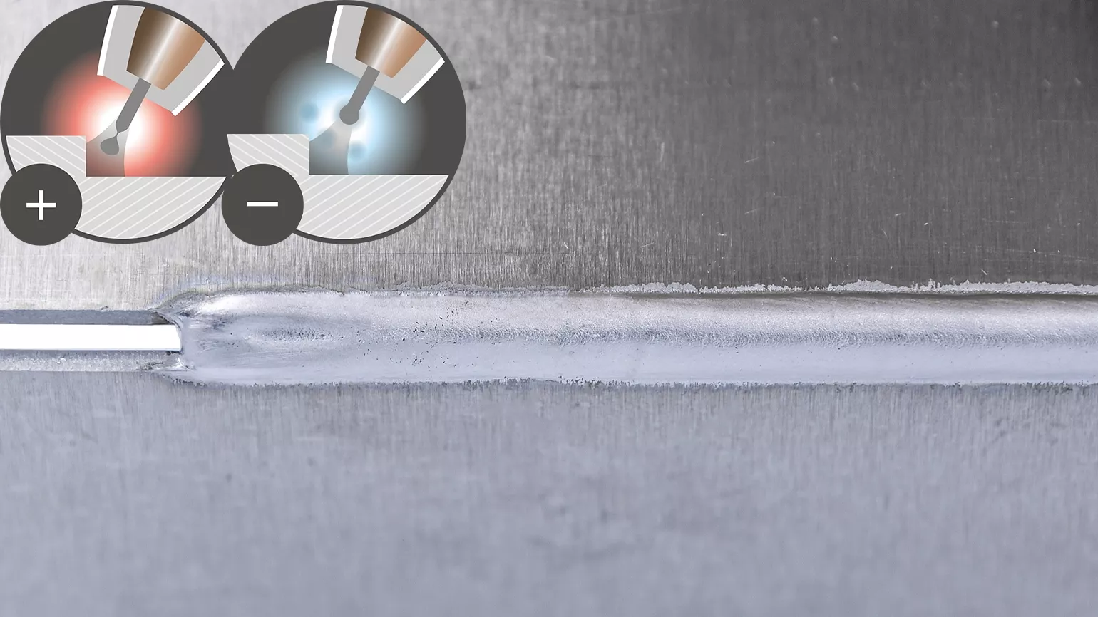

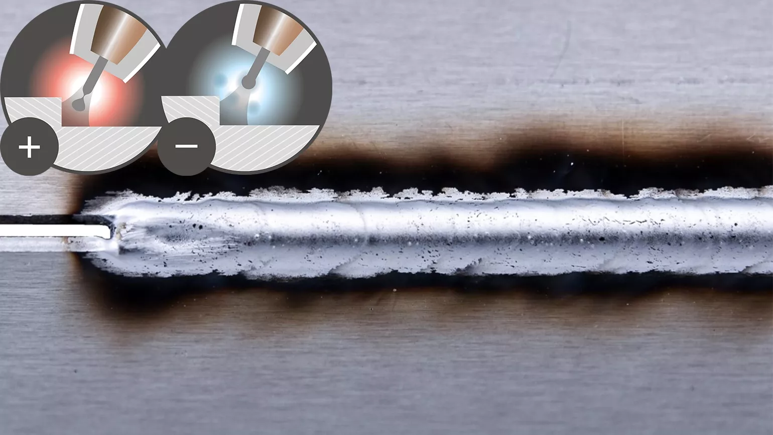

CMT AC - reverse polarity of the wire electrode
Remarkably low heat input with the same deposition rate by reversing the wire movement and the polarity of the wire electrode. You can easily adjust the positive and negative components with the help of correction parameters and thus achieve extremely precise control over the heat input.

The Benefits of CMT AC
CMT AC is the process with the lowest heat input

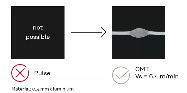

Light gauge (≤ 1 mm) aluminum sheets can be weldedThe low heat input of this process means that weld-pool support isn't necessary to keep the weld from dropping through.

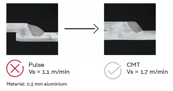

Thin aluminium sheet welding speed
Thin aluminium sheet higher welding speed
