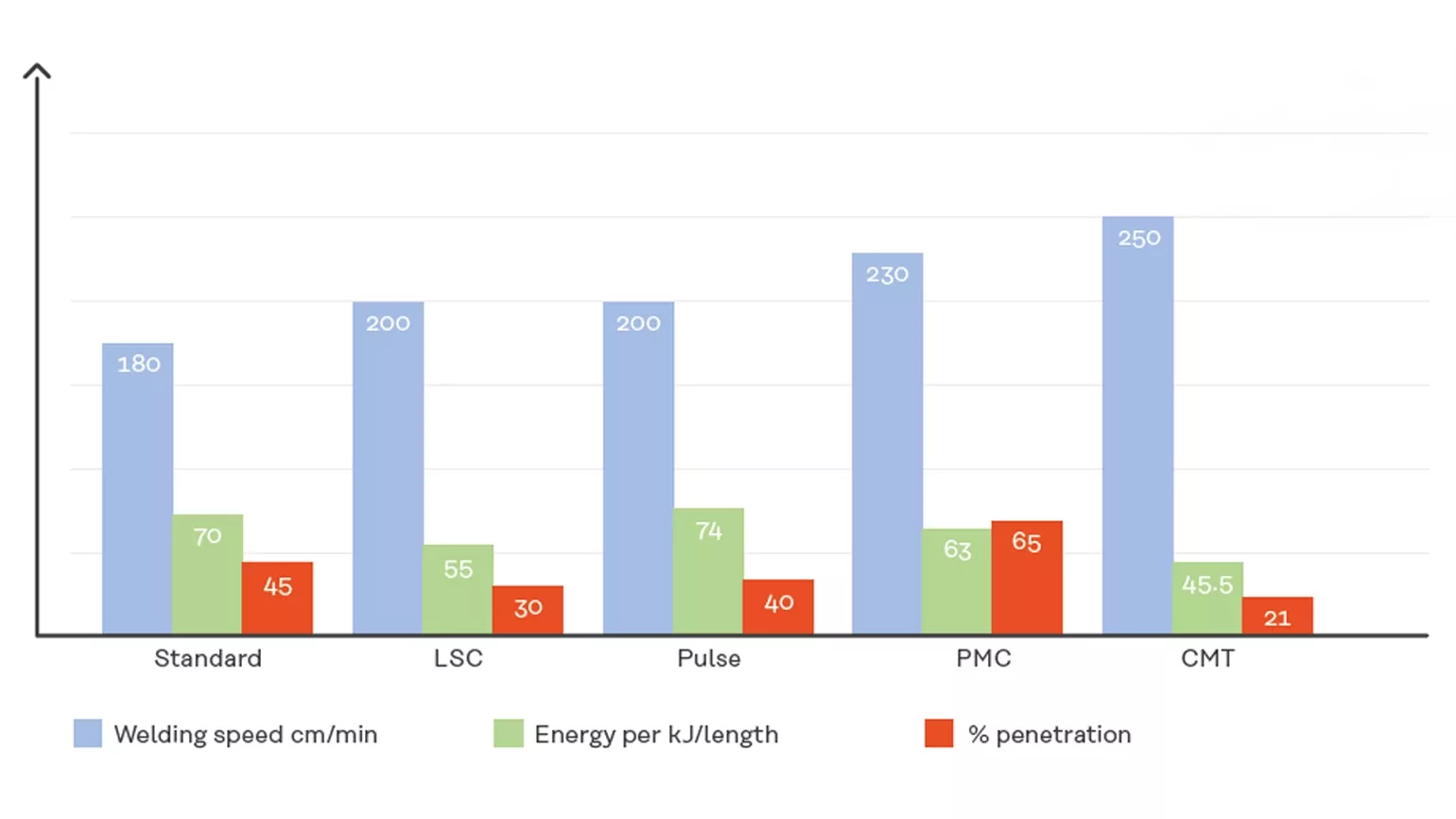

Comparison of Welding Packages
  • TPS 500i
  • MTB 500i W R
  • WF 25i
  • For CMT comparison: additional reel, SB60, Robacta Drive
  • 7° torch contact angle, with slight push and at 15° relative to the workpiece and welding table in 30° PG position
  • Filler metal: G3Si1 (1.2 mm diameter)
  • Shielding gas: M21 (18% Ar + 82% CO2, 12 l/min)
  • Parent material: 2 mm ground steel plate
Welding packages comparison
