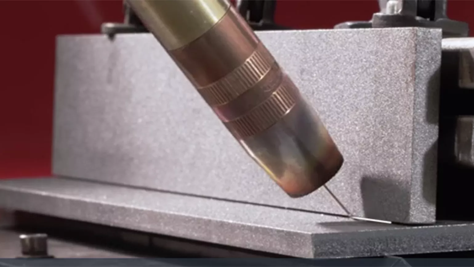

WireSense uses the wire electrode as a sensor.
WireSense delivers a corresponding signal to the robot by precisely scanning the component in advance of performing the weld, so that the robot can adapt its program to the current component position.
The advantages at a glance
Icon WireSense edge detection
Edge detection
  • Detection of the edge position for optimal positioning of the welding start point and end point
  • Component and clamping tolerances are compensated for
Icon WireSense height measurement
Height measurement
  • Detection of an unwanted air gap
  • Detection of sheet thicknesses between 0.5 and 20 mm, both for steel and stainless steel as well as aluminum
  • High-precision and high-speed measurement
Icon WireSense sensor
Wire = sensor
  • No additional optical measuring devices required
  • Excellent component accessibility
  • No wear
  • No maintenance or cleaning costs
  • No calibration between sensor and TCP required

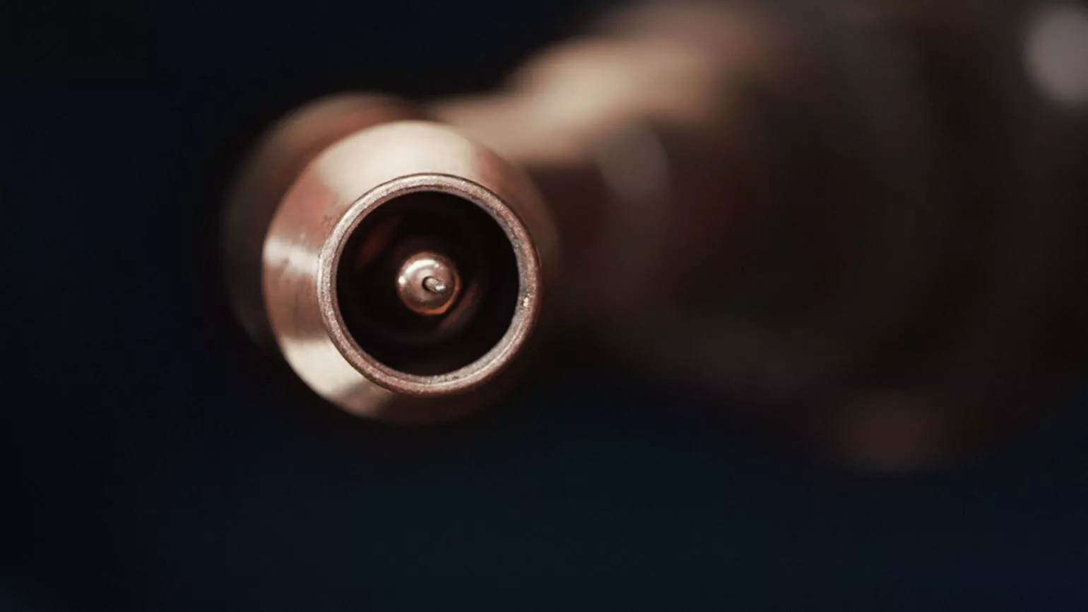

TeachMode helps the welding specialist to program welding positions on the robot. The reversing wire movement prevents the wire bending upon unwanted contact with the component, ensuring the set stickout remains unchanged.
This function is included free of charge with all TPS/i configurations.
Bent welding wire
Stopwatch icon
Save time
If the stickout drops below the defined value, the wire is automatically retracted to prevent deformation. This results in highly efficient component programming.
WireSense
Constant stickout
If the stickout drops below the defined value, the wire will be automatically corrected to the desired length.
WireSense
Suitable for all filler metals
TeachMode is compatible with all filler metals (steel, CrNi, aluminum).

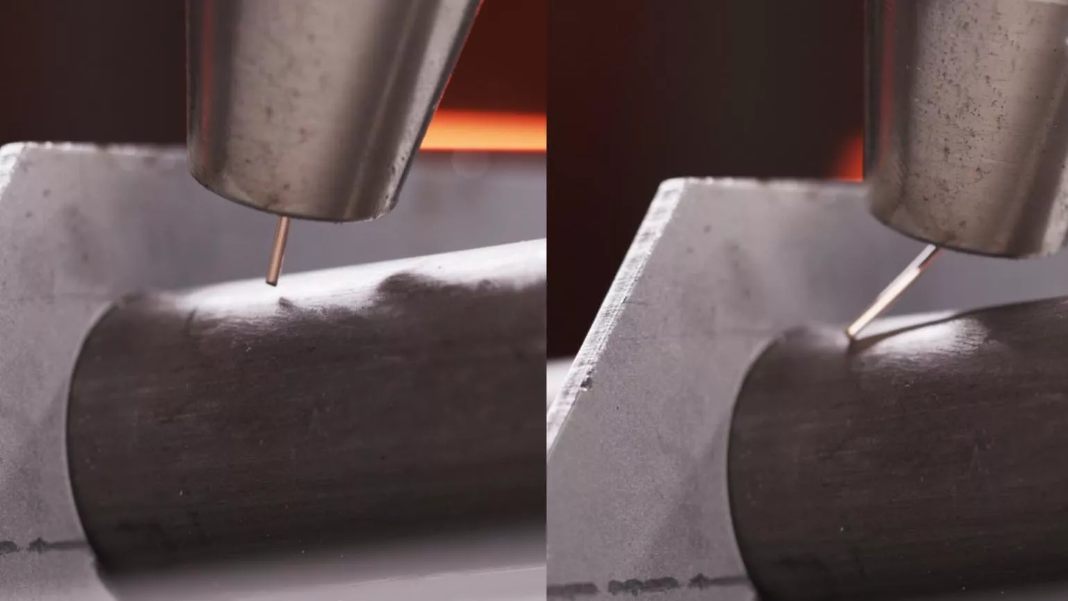

Detect and compensate for component and clamping tolerances before and during welding.
With TouchSense and SeamTracking, the teaching effort is reduced enormously, so that even smaller batch sizes can be produced efficiently for heavy-duty steel structures. The assistance systems also minimize rework, as clamping tolerances or small deviations in the component position are compensated for intelligently. This represents a considerable potential for savings in series production.
The result is a perfect weld seam without the need for rework.
TouchSense
TouchSense determines the precise component position before welding fillet welds and prepared butt welds, whereby the start and end positions are determined by scanning the workpiece with a wire or gas nozzle. After transmitting the signals to the robot, TouchSense calculates the exact seam path.
SeamTracking
Avoid welding defects with SeamTracking, which intervenes as necessary during the welding process. The robot automatically corrects the course of the seam by changing parameters in response to oscillating movements. This ensures precise tracking of the seam path and prevents welding errors due to clamping or component tolerances.
Time costs
Save time and money
  • Less time required for teaching is ideal for smaller batch sizes in heavy-duty steel construction
  • Short changeover times for different component variants
  • Fewer welding errors and less rework
Welding
Compensate for component and clamping tolerances
  • Detection of the component position before starting the welding process (TouchSense)
  • Robot path is adapted to the actual seam position by determining the welding start and end point (TouchSense)
  • Automatic correction of the robot path during the welding process in case of component deviations (SeamTracking)
Flexible use
Flexibility
  • Process-independent: SeamTracking can be used for welding with a dip transfer, spray, and pulsed arc as well as in combination with CMT or TWIN
  • TouchSense process: can be carried out both with the gas nozzle and with the wire electrode
