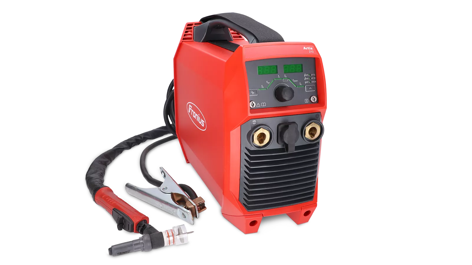

Artis
Technical Data
General Data
| Welding current min. | 3 A |
| Welding current max. | 210 A |
| Operating voltage min. | 10,1 V |
| Open-circuit voltage | 101 V |
| Dimension / length | 435 mm |
| Dimension / width | 160 mm |
| Dimension / height | 310 mm |
| Weight | 9,7 kg |
| Mains cable included | Yes |
| Earth connection | Dinse |
| Length of mains cable | 2500 mm |
| Maximum working voltage | 32 V |
