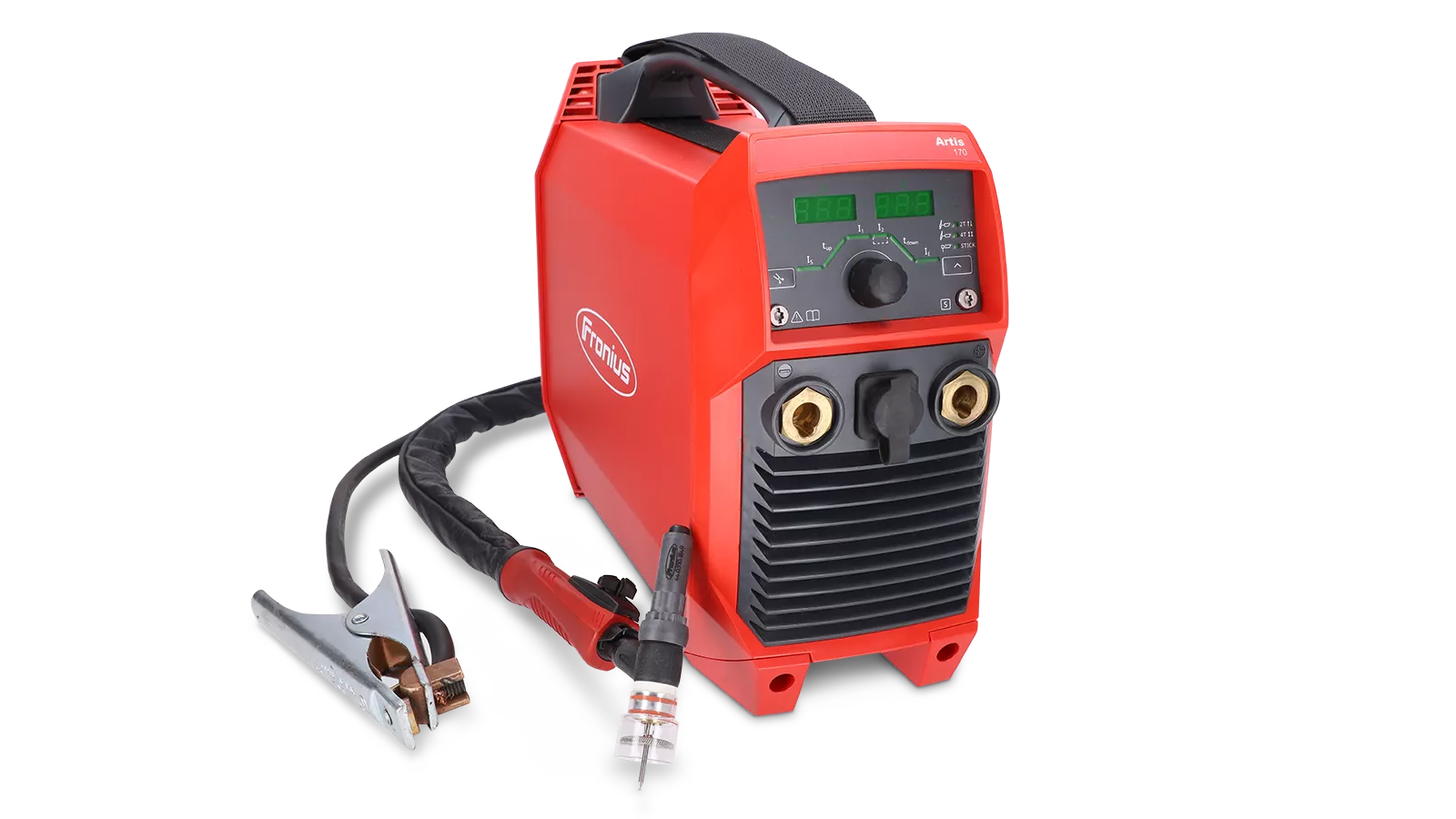

Artis
Product details
General Data
Welding current min.3 A
Welding current max.170 A
Operating voltage min.10,1 V
Open-circuit voltage101 V
Degree of protectionIP23
Dimension / length435 mm
Dimension / width160 mm
Dimension / height310 mm
Weight11,6 kg
Mains cable includedYes
Earth connectionDinse
Length of mains cable2500 mm
Maximum working voltage33 V
