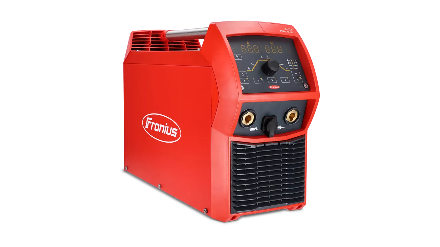

Artis 300 XT – economical and powerful A true all-rounder: the Artis Extended version is designed for mains voltages from 200 to 600 V and can therefore be used worldwide. Depending on the power category and mains fuse, up to 300 A is possible in single-phase operation. – Available for gas- or water-cooled variants – Can be used worldwide – Fully generator-compatible – Optimised welding performance thanks to higher output characteristic curve – CEL-compatible
Technical Data
General Data
Welding current min.3 A
Welding current max.300 A
Welding current / Duty cycle [10min/40°C]300 A / 40 %
Welding current / Duty cycle [10min/40°C]260 A / 60 %
Welding current / Duty cycle [10min/40°C]230 A / 100 %
Dimension / length558 mm
Dimension / width210 mm
Dimension / height369 mm
Weight19,35 kg
Degree of protectionIP23
