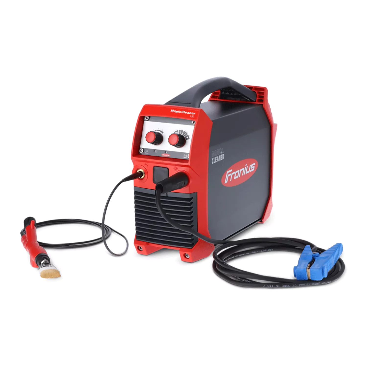

Cleaning and passivation in a single working step
Our MagicCleaner allows you to clean and passivate TIG weld seams and stainless steel surfaces in a single step.

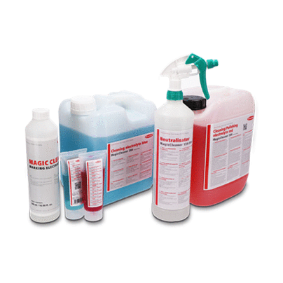

Cost-effective electrolyte consumption
Whether using the tube screwed onto the cleaning torch orthe included 1.8 l tank (MC300), electrolyte consumptioncan be precisely delivered in a sustainable and resource conserving manner.

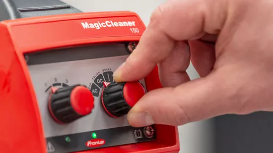

Set-up is quick and easy. All important parameters (operating mode, cleaning performance, electrolyte dosing) are adjustable on the easy-access front panel.

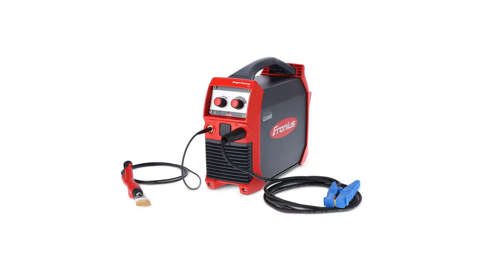

MagicCleaner 150
Ready to use in 2 steps and extremely lightweight at just under 4.5 kg, MagicCleaner 150 is the perfect companion on the construction site or in the workshop.

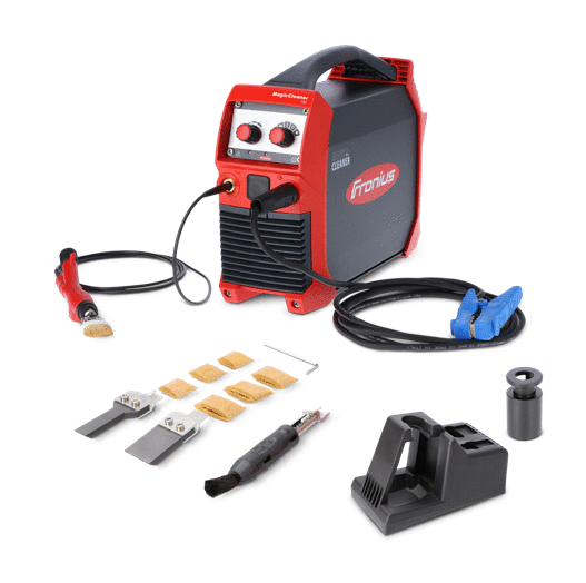

Scope of supply

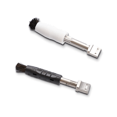

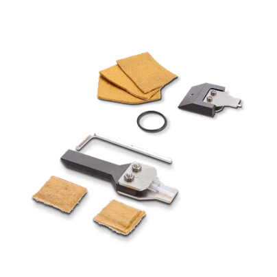

/ Cleaning torch MC150
/ Grounding cable 10 mm², 3 m
/ Torch holder MC150
/ Basic kit: electrodes/brushes/pads
Highlights
/ Ready for use in 2 steps
/ Lightweight at just under 4.5 kg
Easy to use
/ Direct selection of the desired process
Small cleaning torch
/ Manual electrolyte dosing
/ Attachable 100 ml tube
Torch holder
/ For easy securing of pads and storage of the torch
Housing
/ Tried-and-tested robust housing

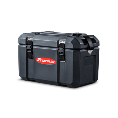

| ToolCase 60 | 🗸 | - |
| Toolcase 120 | - | 🗸 |
| ToolBox 210 | - | 🗸 |
