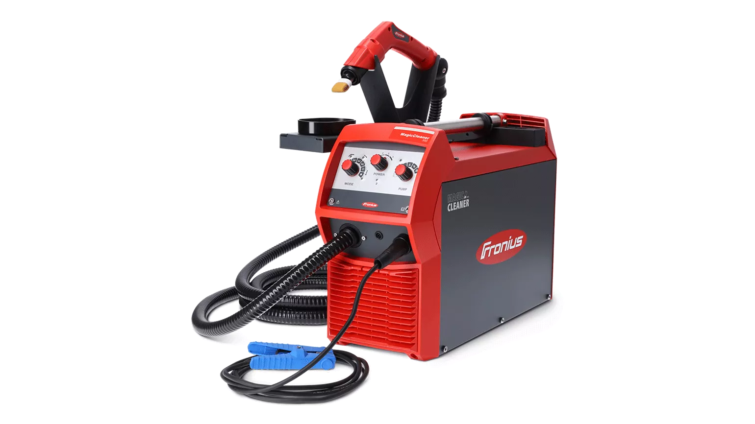

With the MagicCleaner device series, we provide you with innovative technology for the treatment of TIG weld seams and stainless steel surfaces. Cleaning, polishing and labeling of stainless steel are possible with it. In contrast to mechanical or chemical cleaning, the material surface is not affected. No exposure times are required. And an additional passivation process is no longer necessary.
The powerful cleaning device with patented compressed air blower for intensive applications and longer TIG welds. Ready to use in just 3 steps.

Clean and passivate in one step. MagicCleaner is the most advanced system for electrochemical cleaning units. With one machine, you can clean, polish, and inscribe stainless steel. Removepost-weld temper colouration and restore the protective passive layer at the same time.
After cleaning, the polishing process ensures a consistently lustrous surface and improves the steel passivation process. In addition, the MagicCleaner provides the option to permanently inscribe stainless steel surfaces - the perfect alternative to stickers or laser engraving.
Innovative technology
1. Cleaning
The electrochemical cleaning process uses alternating current (AC) and electrolyte fluid to remove post-weld temper colouration and perform passivation.
2. Polishing
Electrochemical polishing removes some of the base material from the workpiece and lightens surface colouration. This results in a consistent lustre after cleaning, providing an improved passivation process.
3. Printing
Permanently inscribe stainless steel with company logos, item numbers, barcodes, etc. Alternating current (AC) is used for black printing and direct current (DC) for white printing - the perfect alternative to stickers or laser engraving.
MagicCleaner 300
This powerful cleaning device includes a patented compressed air blower for intense applications and longer TIG weld seams. Ready to use in just 3 steps.
