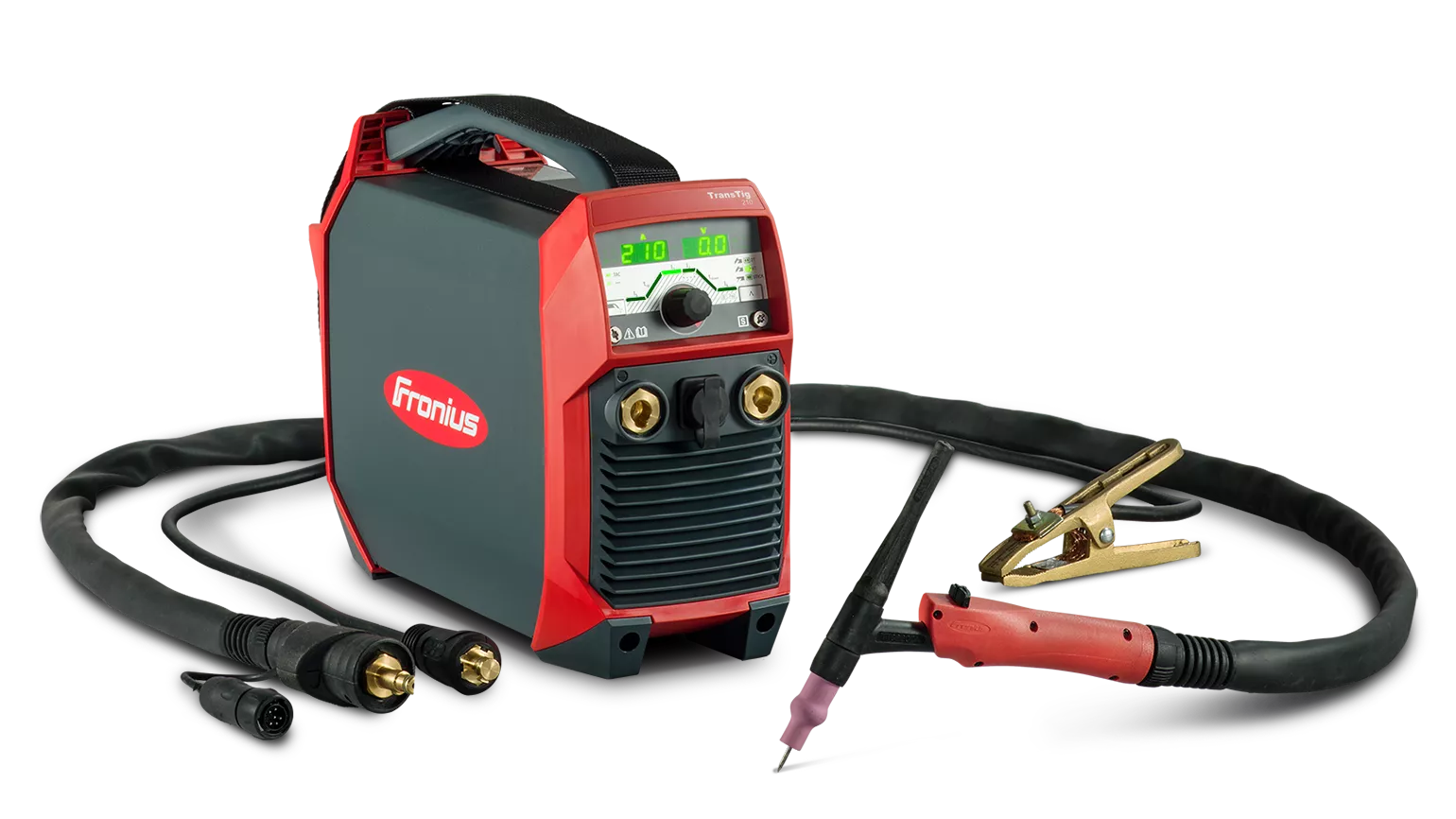

The TransTig is a completely digitised TIG DC power source. Alongside the different power categories from 80 to 500 A, the devices also vary in their mobility – from the mobile, portable device to the stationary, high-power complete system. However, they all have one thing in common – an extremely robust design for a long service life and an exceptionally self-explanatory operating concept.
When developing the TransTig 170/210, our focus was entirely on the benefit for our customers. What is needed is absolutely clear: a perfect, stable arc. The higher operating frequency of the inverter technology makes this stability possible - due to precise control. Other benefits of this optimized process technology are maximum efficiency in the duty cycle, the output power and the mains voltage supply. Last but not least, this increased efficiency also makes welding more enjoyable!

(1) KNOB AND PUSH BUTTON
to set the most important welding parameters on the function curve
(2) GAS-TEST BUTTON
to check the gas flow and purge the hosepack after a long period of downtime
(3) SETTING BUTTON
for welding processes, 2-step, 4-step, and electrode mode
(4) WELDING PROCESS STATUS INDICATOR
or 2-step, 4-step, and special 4-step mode
(5) STATUS INDICATOR
remote control mode, electrode overload, CEL mode, Trigger Mode Off, HF, TAC, pulse and spot welding mode
