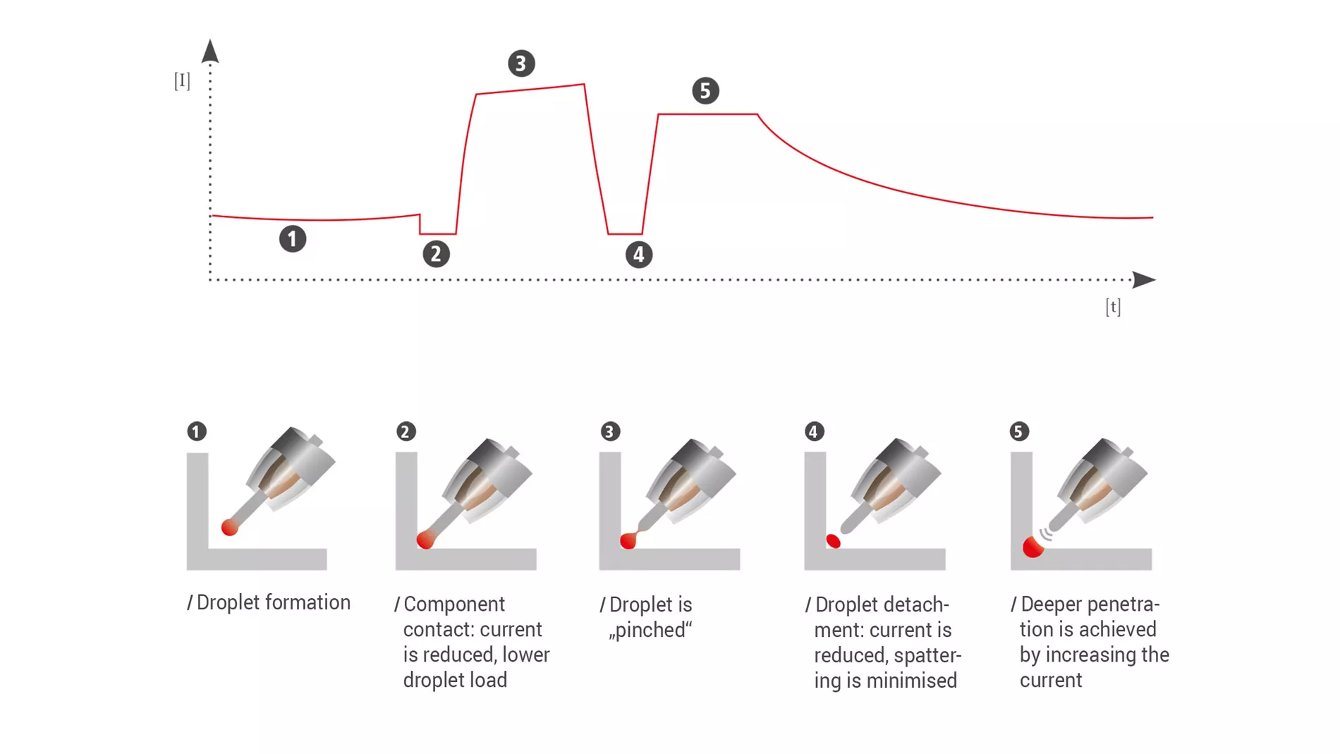

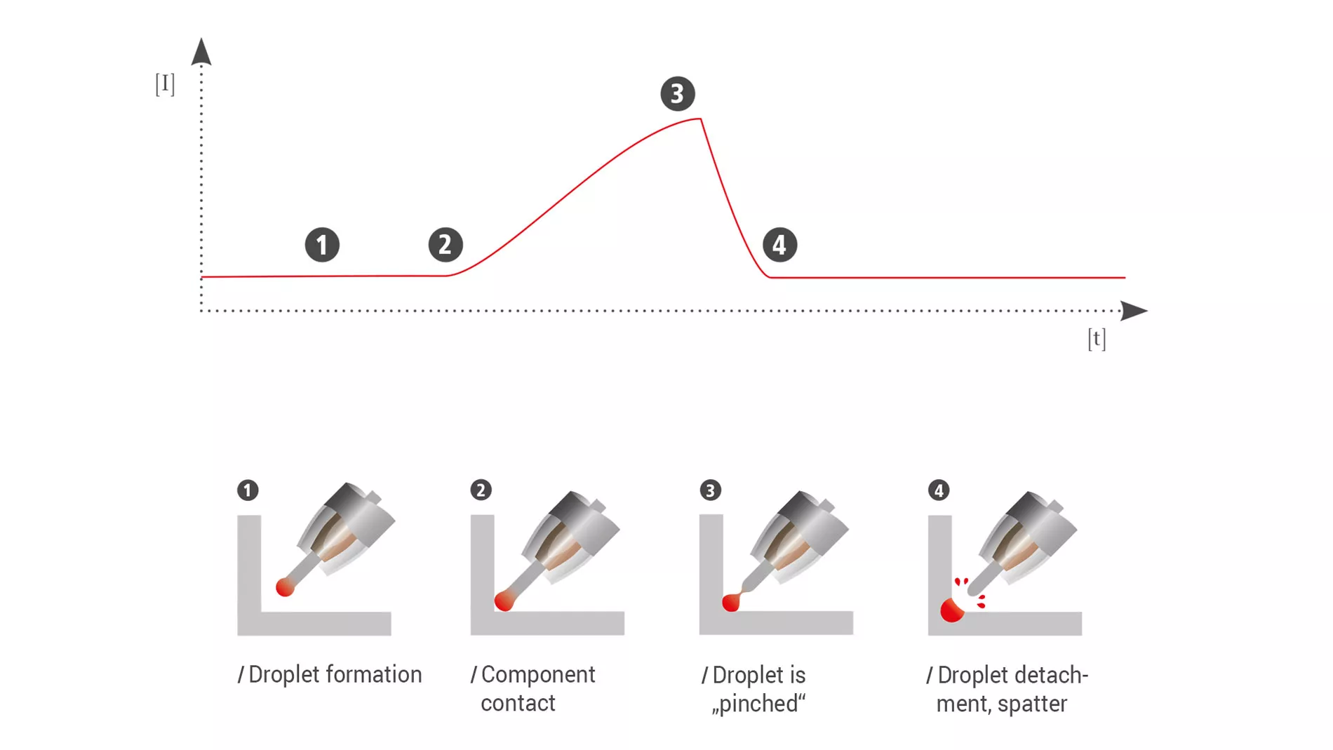

    Comparison of standard short circuit transfer and LSC short circuit transfer
    The short circuit is triggered at a low current level, resulting in a stable welding process.
    Drop replacement
    Standard short circuit transfer
    Drop replacement
    Excellent results can be achieved with the controlled standard arc. But why settle for the standard when virtually spatter-free welding is possible?
    The digital resonant intelligence ensures an absolutely stable arc.

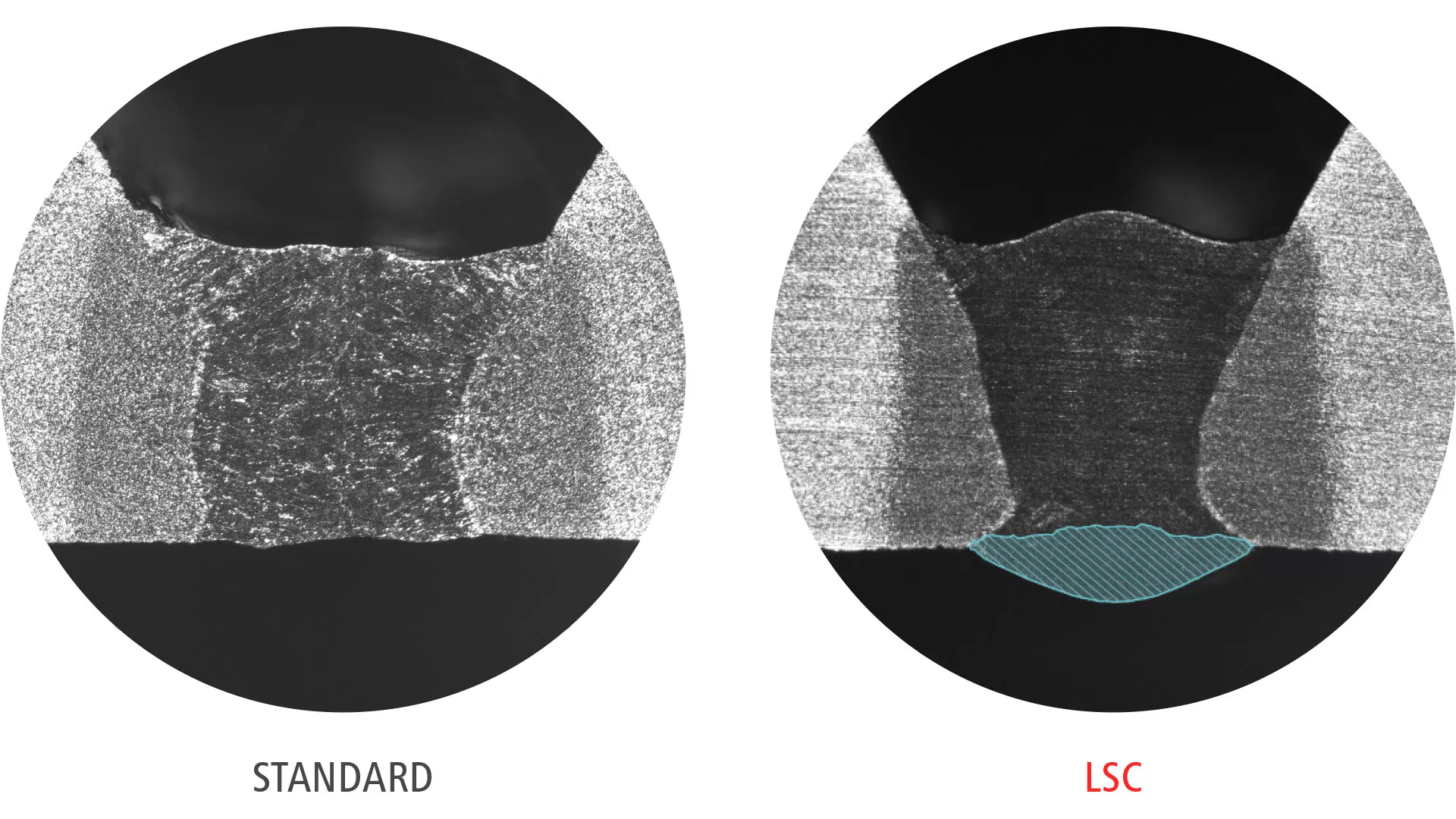

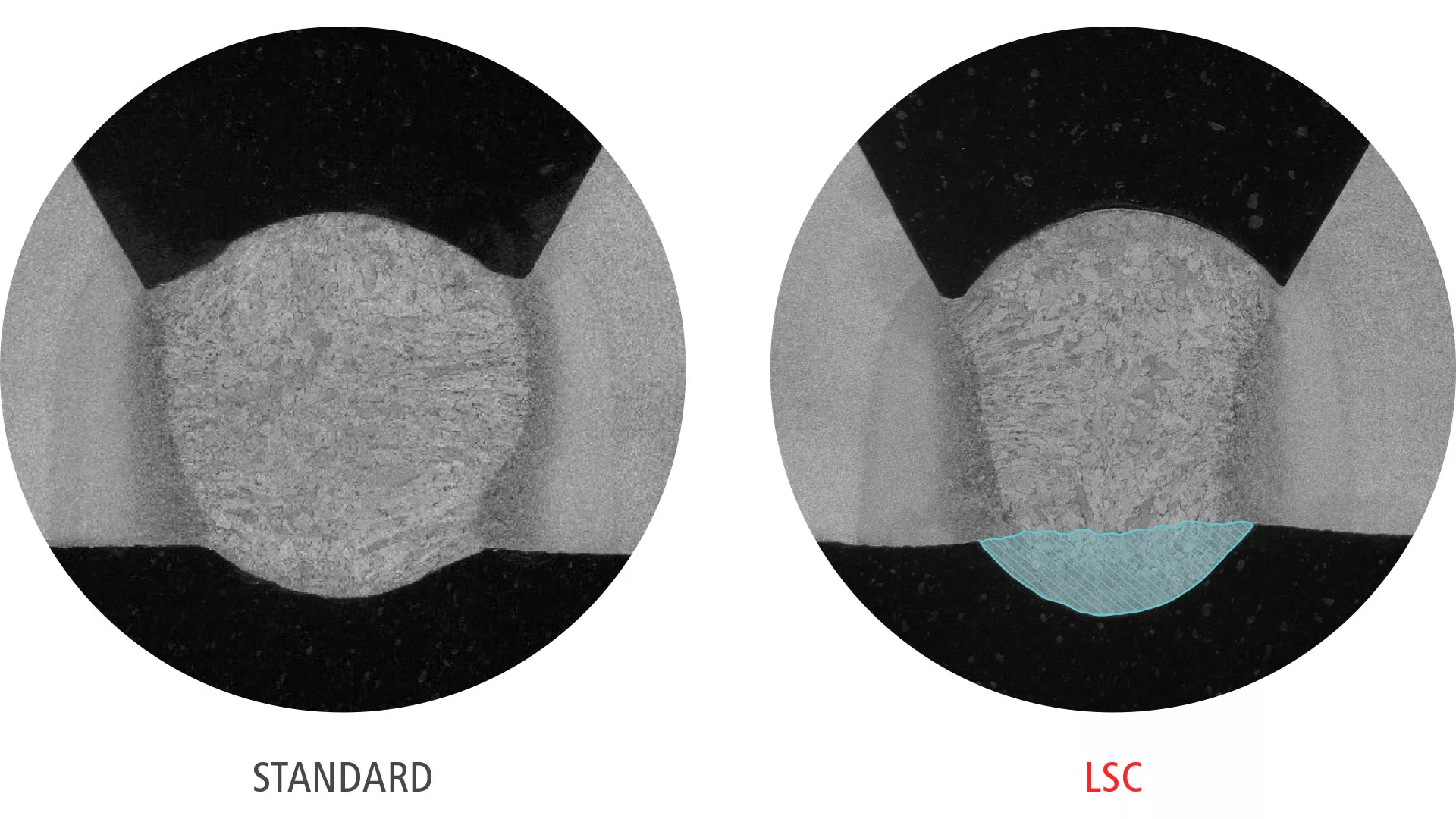

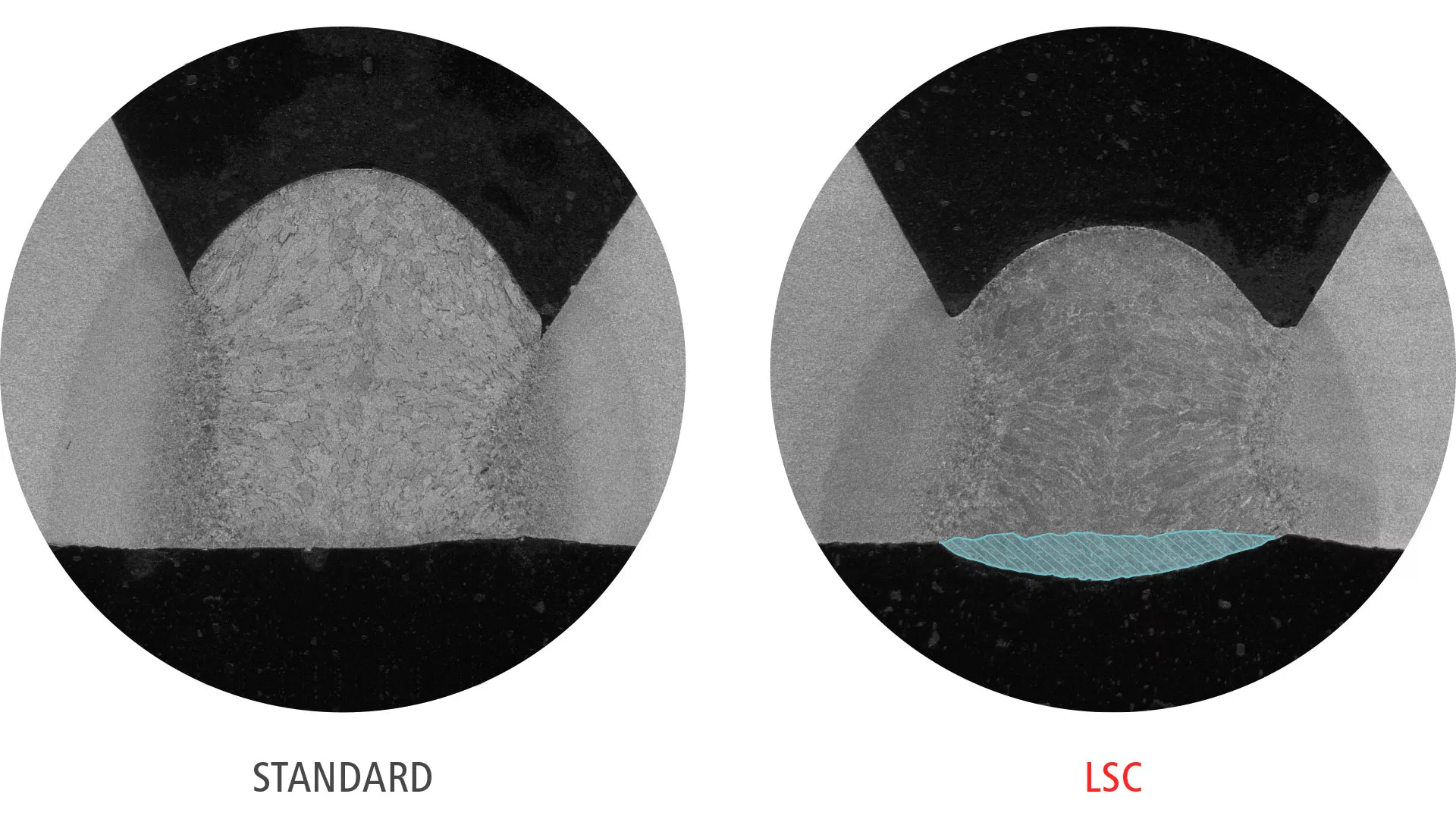

    Root pass process
    Up to now, the root pass usually had to be welded in an upward position in the conventional short circuit arc.
    In the downward position, there was a risk that a lack of fusion would occur. Typically, this was caused by the low arc pressure as the weld pool advanced. In contrast, the LSC Root characteristic means that welding can now be carried out in a downward position thanks to the high arc pressure. With LSC Root Advanced, a rate of 25 cm/min in a downward position can even be achieved.
    Standard-LSC-position
    1 / 3
    1) PF - Upward
    2) PG – Downward
    3) PH – Overhead
    Comparison of results standard – LSC
    1) PF - Upward
    2) PG – Downward
    3) PH – Overhead
