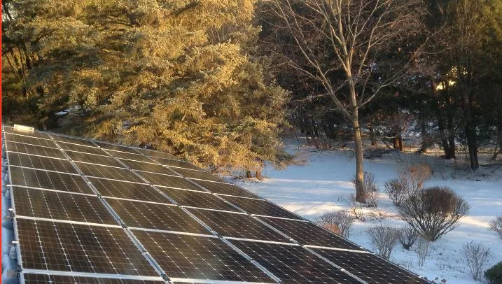

This install uses two Fronius Primo 6.0-1 inverters, 44 Solar World 285 Mono’s and the Ecolibrium EcoX rail-less mounting. What might not be obvious to the casual observer is that Scott Perry (the Master Electrician on South Pack‘s team) and owner, Greg Blake put a lot of thought into matching the design (including the string configuration) to the site. These installers put forth a lot of effort and thought into the overall design of the system to maximize the homeowner‘s electrical output.
String Configuration: This site has some evergreen trees to the East that cause some shading on this side of the array in the winter mornings. They divided the array into 4 strings that split the upper two rows of modules in half east:west. „It’s more work wiring but prevents this AM shading from taking down the output of the multiple strings,“ said Blake. „The problem is that the array will make a lot less energy over its service life, so its important to spend the time for a high quality install. “No Combining: Both the POS and NEG conductor of each of the 4 strings (8 conductors plus ground) are brought through a switched pass through box on the roof and brought through conduit (larger diameter to hold all the wires) to the basement into a breakout box. Although more expensive, this allows for future string-level troubleshooting from the ground which is really nice during snowy-cold New Hampshire winters, saving the homeowner money in the long-run. Breakout box near inverter and wiring trough: We pass the 4 separate strings (and ground) through a fused breakout box and then into a trough below the inverters in order to stay organized. Multiple MPPT channels: We use multiple inverters with multiple MPPT channels in order to maximize the electrical output of each string. This is why we always choose Fronius. It is considerably more expensive to build a system this way but it makes for a vastly superior system in terms of service life energy production for our customers.
