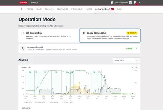

After the energy cost assistant has been activated in the Solar.web portal, there is a page called "Operating mode" where users can activate and deactivate the energy cost assistant for the system. Here the user can also see the (planned) behavior of the current day and can see when the energy cost assistant will perform which checks. A diagram also helps the user to understand the behavior. This page is visible to all users with system administrator or owner rights after initial activation.

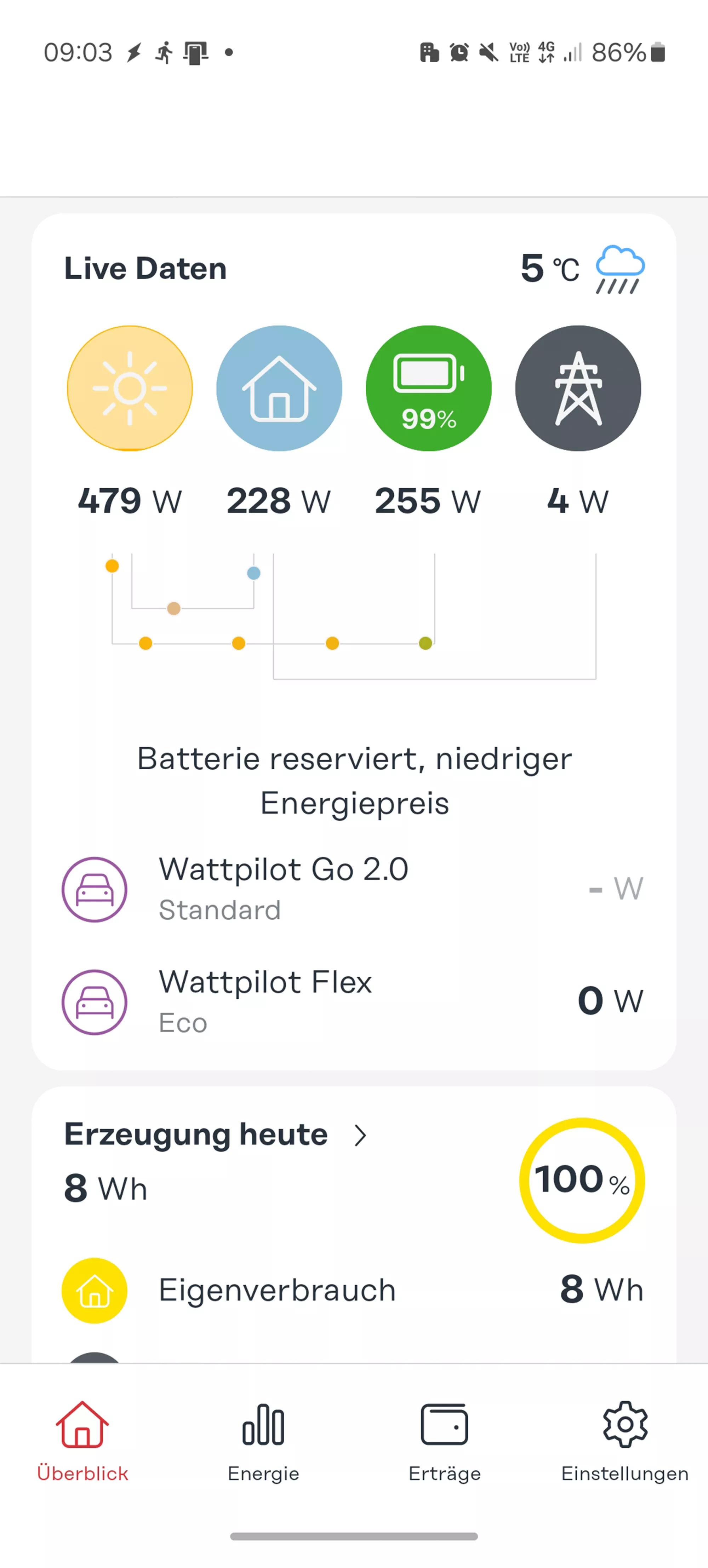

In the Solar.web app, users with owner or system maintenance rights can see the current status under the bubble chart on the dashboard to see whether the energy cost assistant is currently intervening in the system. This can be deactivated again under Settings -> Operating mode.
