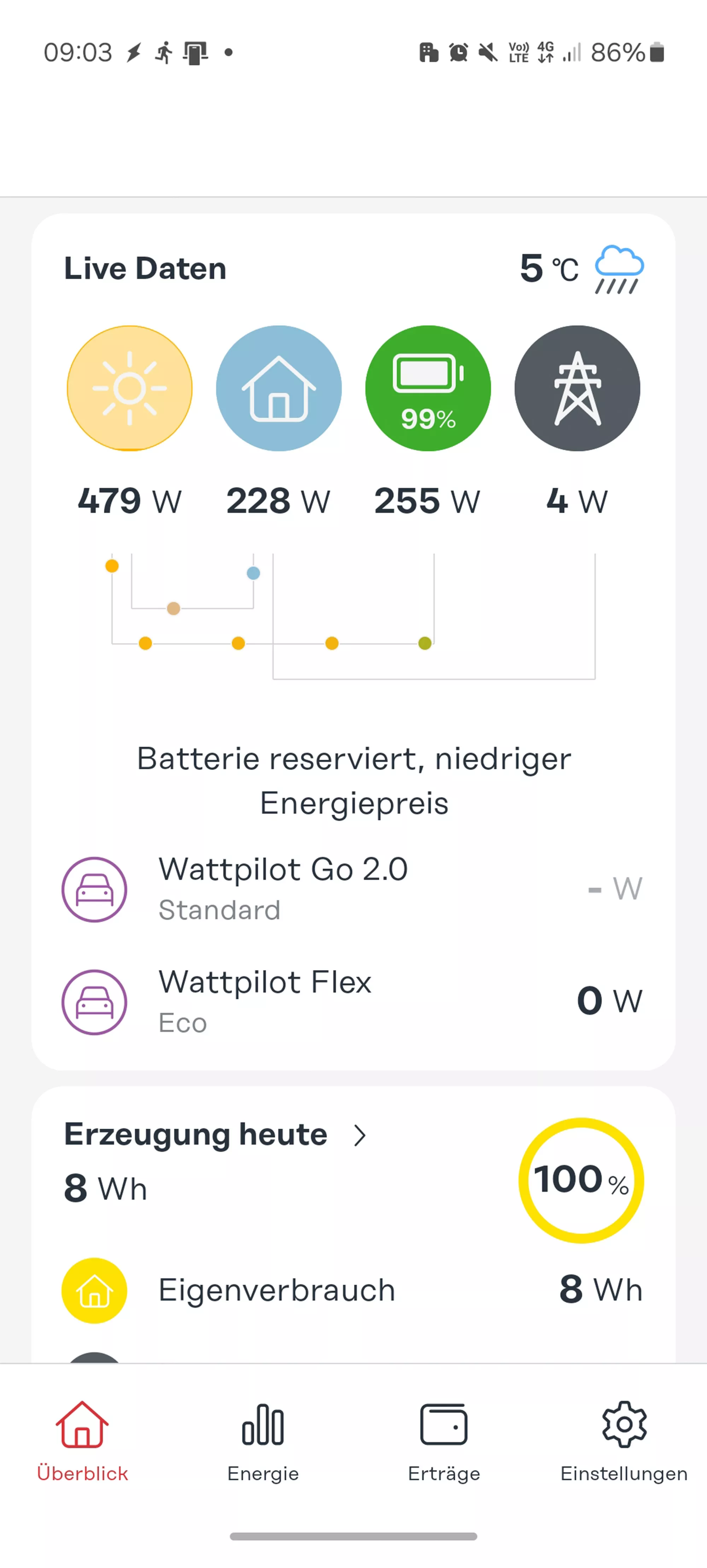

In the Solar.web app, users with owner or system maintenance rights can see the current status under the bubble chart on the dashboard to see whether the energy cost assistant is currently intervening in the system. This can be deactivated again under Settings -> Operating mode.
