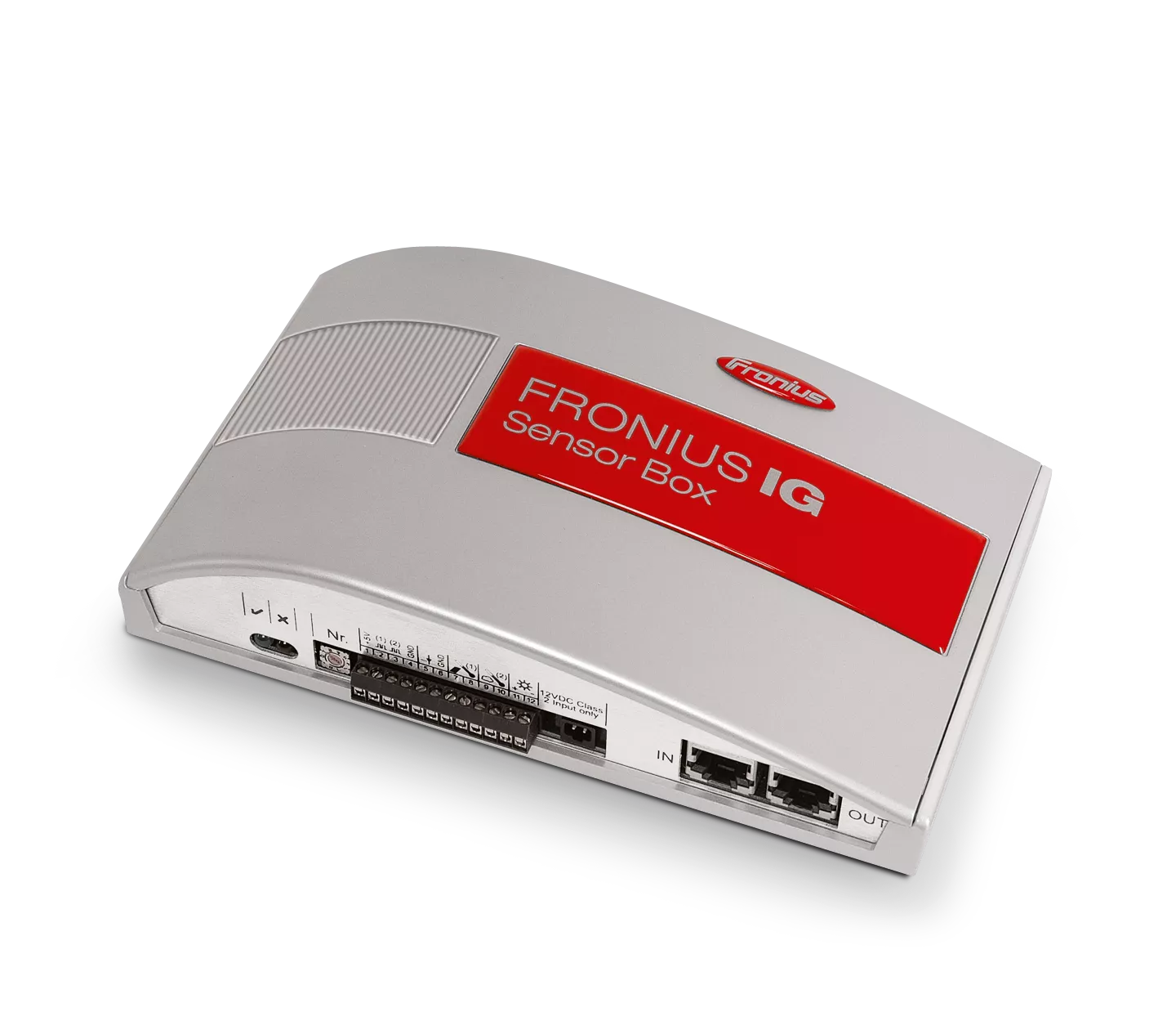

Technical Data
General Data
| Dimension / length | 197 mm |
| Dimension / width | 110 mm |
| Dimension / height | 57 mm |
| Weight | 0,37 kg |
| Supply voltage | 12 V DC |
| Energy consumption | 1,3 W |
| Degree of protection | IP 20 |
Interfaces
2 × RS422 (RJ45 socket) 4) | Fronius Solar.Net IN + Fronius Solar.Net OUT |
Channel irradiation
| Measuring range | 0 - 100 mV / 0 - 200 mV / 0 - 1 V |
| Accuracy | 3% from meter reading |
Channel power input
| Measuring range | 0 - 20 mA / 4 - 20 mA |
| Accuracy | 5% from meter reading |
Channels D1 D2
| Max. voltage level | 5,5 V |
| Max. frequency | 2500 Hz |
| Min. pulse duration | 0,25 ms |
| Operating point “OFF” (“LOW”) | 0 - 0,5 V |
| Operating point “ON” (“HIGH”) | 3 - 5,5 V |
Channels T1 T2
| Sensors | PT1000 |
| Measuring range | -25°C - +75°C |
| Accuracy | 0,5 °C |
| Resolution | 1 °C |
