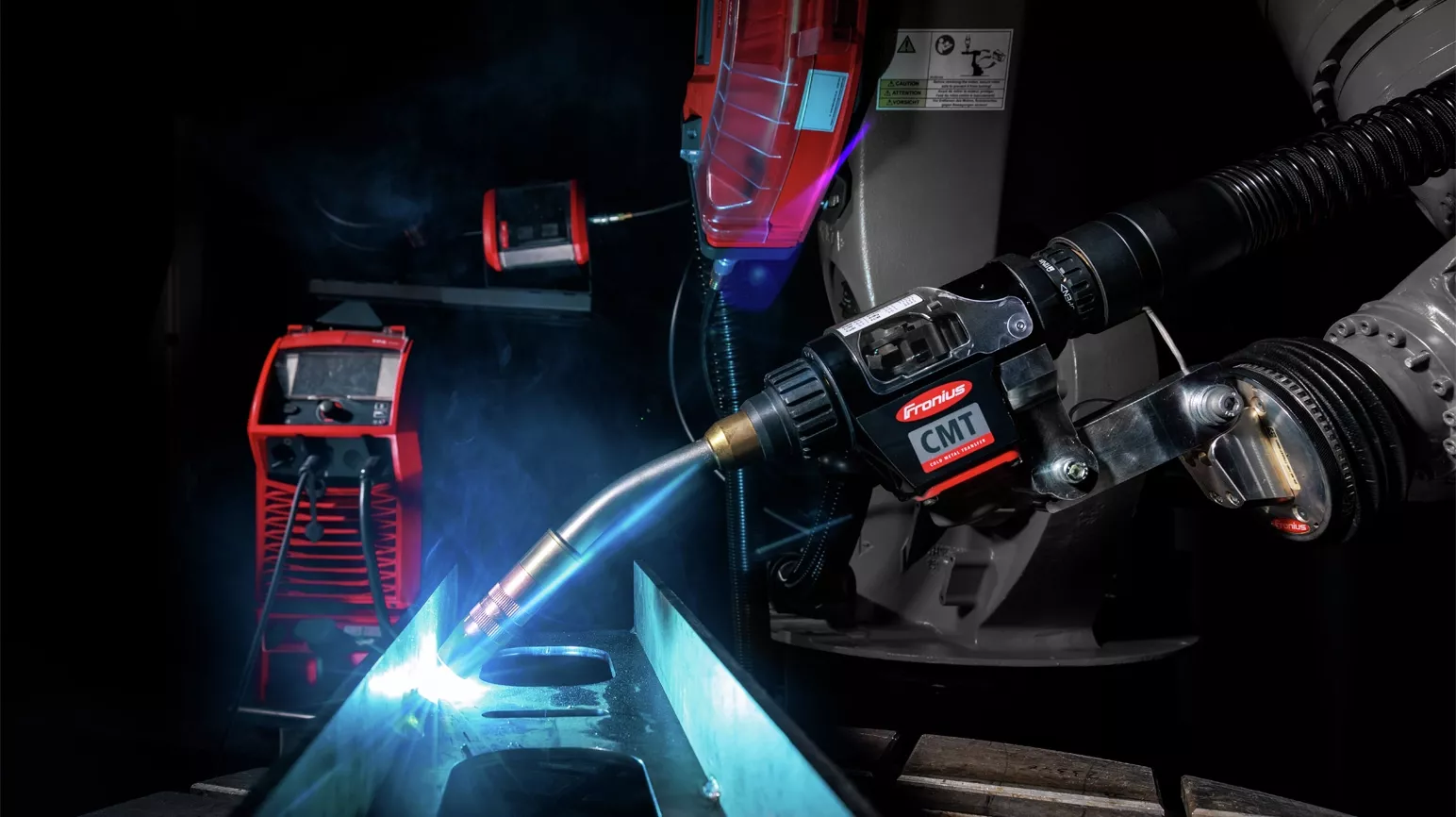

We are celebrating 20 years of Cold Metal Transfer (CMT)—a milestone in welding technology! Since its invention in 2005, our original process has stood for maximum precision, stability, and impressive versatility. This groundbreaking innovation came down to the reversing wire movement, which enables controlled droplet detachment, reduces heat input, and delivers virtually spatter-free welds.
20 Jahre CMT
What makes CMT so special?
CMT has a unique capacity to securely join a wide variety of materials such as galvanized steel and aluminum. An equally outstanding aspect is the low thermal load placed on the workpiece. This reduces distortion and deformation, which is an enormous advantage especially when working with sheets as thin as 0.3 millimeters and temperature-sensitive materials. These advantages continue to open up new possibilities for production in a wide range of industries. From the automotive industry to aerospace and 3D printing, our customers use CMT in creative ways to master individual welding challenges.
CMT is ready for the future
Thanks to our intelligent welding machines, the process can be easily retrofitted. Various welding characteristics—such as CMT Mix, CMT Cycle Step, CMT Cladding, CMT Braze, and CMT Additive Pro for 3D metal printing—show that we are continuously evolving this high-end process. LaserHybrid CMT, our solution combining laser and CMT technology, also sets new standards in terms of speed and weld quality.
