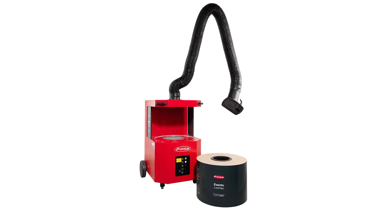

Exento LowVac: More filter surface area, maximum safety
The Exento LowVac mobile low-vacuum extraction system provides users with effective protection against welding fume and is extremely cost effective thanks to its long service life.
The flexible filter options include a disposable filter with a 25 m² surface area fitted as standard, which can be replaced by an extra-large 42 m² version if required. In addition, the filter is changed without contamination for maximum safety during handling.
The Exento LowVac is EN ISO 21904-1 W3-certified and therefore meets the highest quality and occupational safety requirements.

Exento LowVac technical data
  Exento LV 230V/EF Exento LV 115V/B Exento LV 230V/B Exento LV 400V Exento LV 460V Exento LV 600V
Mains voltage -10/+10% 1x 230 V / 50 Hz 1x 115 V / 60 Hz 1x 230 V / 60 Hz 3x 400 V / 50 Hz 3x 460 V / 60 Hz 3x 600 V / 60 Hz
Motor power 1.5 kW / 2.04 hp
Nominal current 9.1 A 17 A 9.2 A 3.1 A 2.6 A 1.9 A
Max. extraction capacity 1,100 m³/h / 647 cfm
Max. negative pressure 2,250 Pa / 9.04 in wc
Sound pressure level 70 dB(A)
Protection class IP 21
Dimensions l x w x h 836 x 795 x 1,169 mm / 32.9 x 31.3 x 46.0 in
Weight 127 kg / 280 lb
 Filter stages  2
 Filter process  Depth filter
 Filter area 25 m² / 38,750 in²
 Filter type  Safe change filter
 Filter material Polyester fleece
 Extraction efficiency rate ≥ 99.5%
 Filter class E12
 Additional filter  Pre-filter (aluminum mesh)
 Fan type Centrifugal fan
 Extraction arm type  Flexible hose design
 Extraction arm lengths 2 m / 3 m / 4 m
 IFA approval  W3-tested

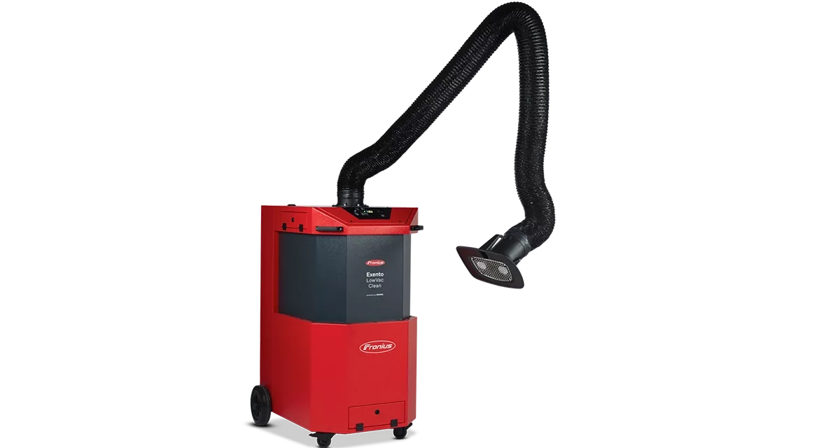

    Exento LowVac Clean: Self-cleaning filter system
    The Exento LowVac Clean is based on the proven Exento LowVac and offers an extra-large filter cartridge with automatic cleaning.
    This means that regular filter changes are no longer necessary—for maximum efficiency with minimum maintenance. W3 certification in accordance with EN ISO 21904-1 has already been applied for.
    The Exento LowVac Clean is available with practical extras such as an automatic start/stop function or an illuminated extraction hood for even greater convenience.
    Fronius Exento LowVac Clean welding fume extraction system
    Exento LowVac Clean technical data
      Exento LV Clean 400V Exento LV Clean 460V Exento LV Clean 600V
    Mains voltage -10/+10% 3 x 400 V / 50 Hz 3 x 460 V / 60 Hz 3 x 600 V / 60 Hz
    Motor power 2.2 kW / 2.99 hp  2.2 kW / 2.99 hp  2.2 kW / 2.99 hp
    Nominal current 4.4 A 4.4 A 2.9 A
    Max. extraction capacity 1,450 m³/h / 853 cfm
    Max. negative pressure 3,300 Pa / 13 in wc
    Sound pressure level 73 dB(A)
    Dimensions l x w x h 973 x 834 x 1,350 mm / 38.3 x 32.8 x 53.2 in
    Weight 197 kg / 435 lb
    Filter stages
    Filter process  Surface filter
    Cleaning process  Rotary nozzle
    Cleaning trigger  Automatic
    Filter area 15 m² / 23,250 in²
    Filter type  Filter cartridge
    Filter material  ePTFE membrane
    Extraction efficiency rate ≥ 99.9%
    Dust class  M
     Compressed air supply  5-6 bar / 73-87 psi
     IFA approval  W3 certification applied for
