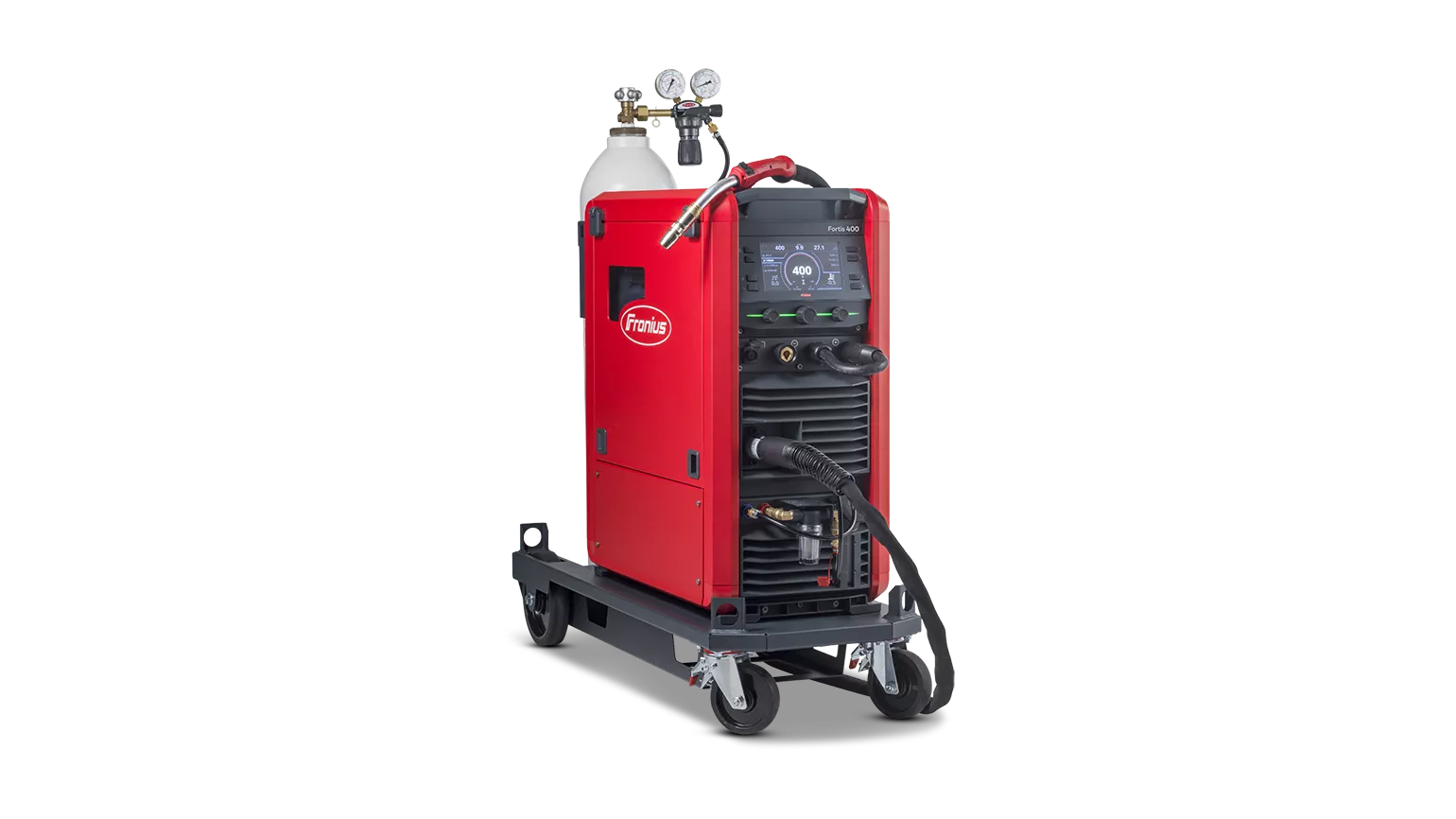

Fortis MIG/MAG
Selecione o produto desejado.
- Fortis 270 C /4R/FSC/G
- Fortis 270 C /4R/FSC/G/XT/nc
- Fortis 320 /GW
- Fortis 320 /GW/XT/nc
- Fortis 320 C /4R/FSC/G
- Fortis 320 C /4R/FSC/G/XT/nc
- Fortis 320 C /4R/FSC/GW
- Fortis 320 C /4R/FSC/GW/XT/nc
- Fortis 400 /GW
- Fortis 400 /GW/XT/nc
- Fortis 400 C /4R/FSC/GW
- Fortis 400 C /4R/FSC/GW/XT/nc
- Fortis 500 /GW
- Fortis 500 /GW/XT/nc
- Fortis 500 C /4R/FSC/GW
- Fortis 500 C /4R/FSC/GW/XT/nc
