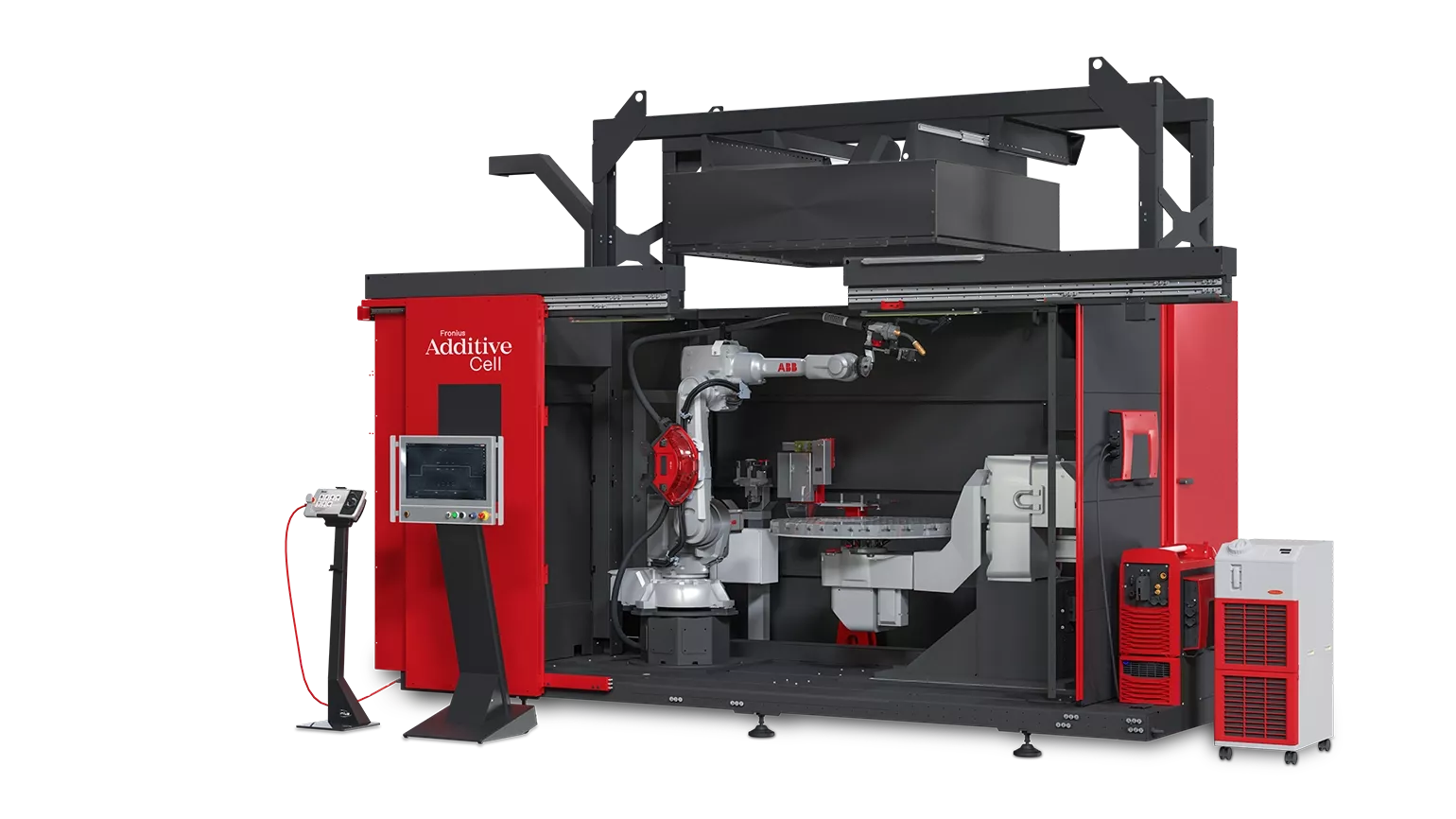

Fronius Additive Cell—flexibility for custom welding solutions
For many companies, additive manufacturing presents numerous challenges. Compared to traditional manufacturing techniques, however, material waste is significantly lower, and neither complex molds and tools nor long lead times are required. Thanks in particular to the new Fronius Additive Cell, production of the first components can begin quickly. The Fronius Additive Cell is a perfectly coordinated complete system developed by Fronius to meet the needs of industry. Inside the welding cell, the CMT Additive PRO and Fronius iWave ensure a precise welding process while the Polaris system remains in overall control. “The Additive Cell combines proven welding technology, intelligent control, and Fronius’s many years of welding expertise. Every component has been designed to complement the other, resulting in a stable manufacturing process,” says Anna Dieplinger, Key Product Manager Additive Manufacturing, Automation & Digital Solutions at Fronius International GmbH. The Fronius Additive Cell includes not only the hardware but also our proprietary software bundle Vectris, which brings together the machine tool service kit (MTSK) and the post-processor on a single central platform. Developed by a highly experienced team of Fronius specialists, the software is designed specifically for additive manufacturing with the Fronius Additive Cell. In addition to an integrated kinematic model, an adapted user interface, and validated welding operations for additive processes, it also supports geometry-based detection of different component regions. This allows for flexible process parameters, such as different settings for outer walls, panels, infills, or component joints. Thanks to the “FroArc” welding command integrated into the post-processor, these so-called “build styles” are translated directly into code for the welding robot, and the system switches to the correct welding parameters at the exact desired location without delay. Fronius’s integrated system, consisting of a welding machine and software, ensures a simple, stable, and reliable welding process.
