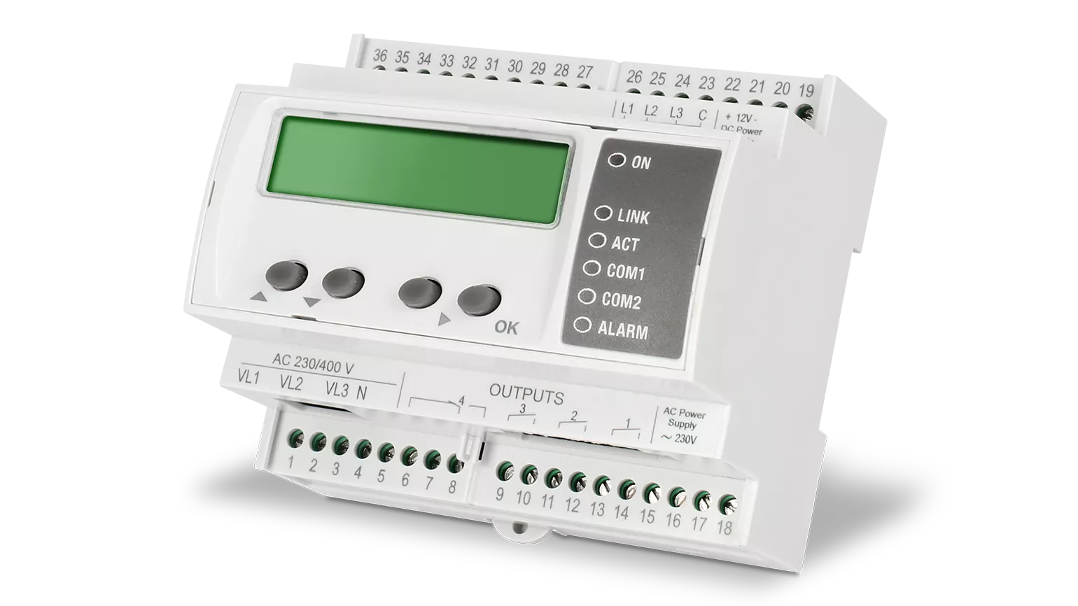

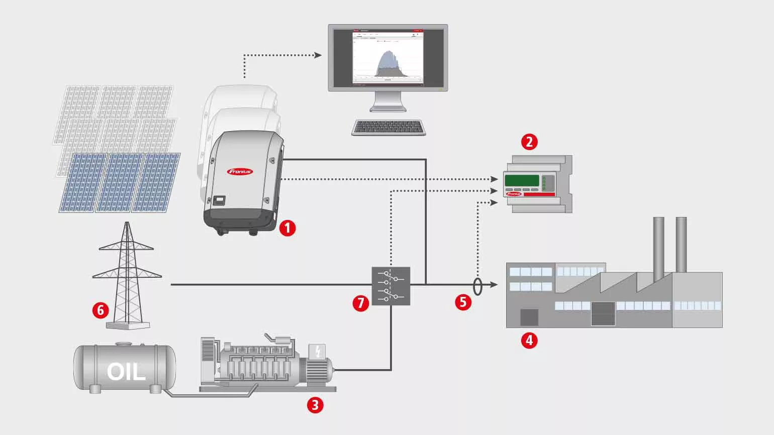

Integrating photovoltaic systems into diesel generator-powered grids requires quick and reliable control of the entire system. The Fronius PV system controller measures all power flows in the system, enabling it to control the PV power in the most optimum manner.

Dimension / length70 mm
Dimension / width105 mm
Dimension / height90 mm
Dimension / depth70 mm
Weight0,25 kg
Working temperature-25°C - +70°C
Storage temperature-40°C - +85°C
Humidity 1)
> 95 %
Certificates and compliance with standardsSafety regulations for electrical measuring, control, regulation and laboratory equipment EN 61010-1:2010, electromagnetic compatibility EN 61000-6-2:2005, EN 61000-6-4:2011
AC Power Supply
AC voltage230 VAC (80 % - 115 %)
Frequency45 - 65 Hz
Consumption6 VA
DC Power Supply
Nominal DC voltage12 V
Consumption6 W
Accuracy Class
Power measurement accuracy0,5 %
Energy measurement accuracy1 %
Voltage Measurement
Measuring range10 - 300 V
Frequency45 - 65 Hz
Current measurement
Nominal currentSecondary 250 mA
Max. currentSecondary 300 mA
Interfaces
User interfaceEthernet
Communication with the inverterRS232 / RS485 / RS422
Communication with other equipmentRS485
Display2 lines of 20 characters
Light indicators6 LEDs
Keypad4 silicone keys
Control outputs4 floating relays, 6 A
Fronius PV-Genset solution
