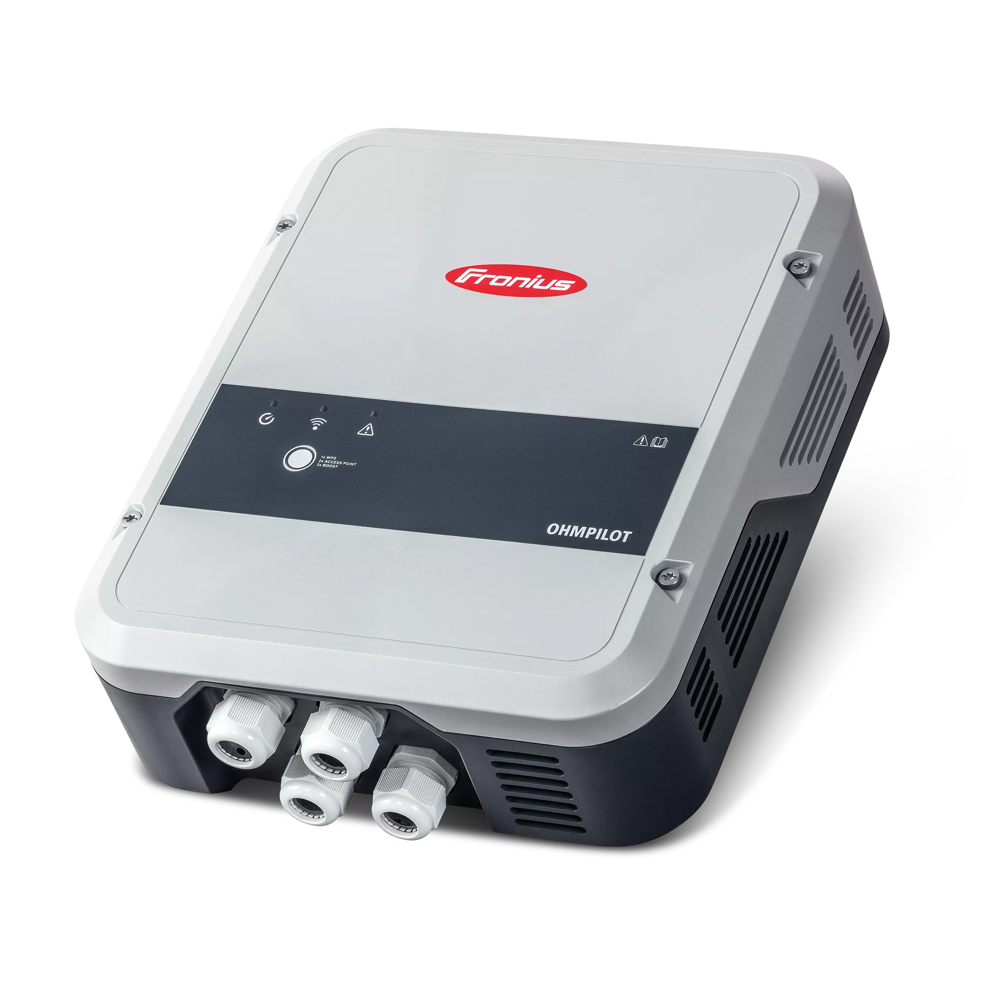

The Fronius Ohmpilot is a load regulator designed to use excess photovoltaic power to heat water.
Thanks to the dynamic variable control from 0 to 9 kW, it is possible to efficiently harness excess PV electricity and use it to power certain electrical loads in the household. The Fronius Ohmpilot is primarily used for the intelligent control of heating rods in boilers and buffer storage tanks. It can also be used for applications such as infrared heaters and towel dryers. In a single-family home with average hot water consumption, it can cover a large proportion of the hot water demand with solar power from April to October.

There can be several reasons why excess PV power is being fed into the grid instead of being used for heating.
Troubleshooting: Test boost mode
Press the key on the Ohmpilot three times to activate boost mode.
Boost mode activates control output L1 at 100 percent, while L2 and L3 are switched through. The heating runs at maximum output. Boost mode is deactivated after four hours or by pressing the button again.
Is the device still not heating when in boost mode?
If no heat is being delivered in boost mode, check the following:
  • Neutral conductor not installed or connected
    With three-phase heaters, the neutral conductor must be present and the heating element must be connected in a star connection.
  • Heating temperature limitation active
    Check whether the temperature switch of the heater has tripped. To test this, set the highest possible maximum temperature value and restart boost mode.
  • Heating element incompatible
    Single-phase heating rods from 0.3 to 3 kW and three-phase heating rods from 0.9 to 9 kW are supported. Only use purely ohmic loads. With three-phase heating rods, the load must be evenly distributed over all three phases.
Does the device heat in boost mode, but not in normal operation?
If the system heats in boost mode, but not in normal operation, check the following settings:
  • Maximum temperature set too low
    On the user interface, check under General whether the maximum temperature setting is too low to prevent heating.
  • No communication with the inverter
    Check the data connection between the Ohmpilot and inverter as well as the connection between the components. Modbus RTU via RS485 is recommended for stable communication.
