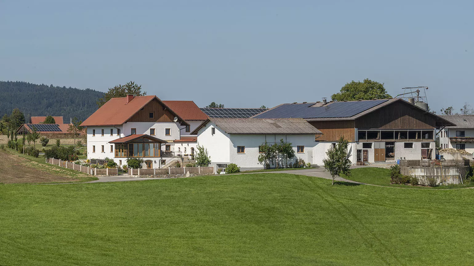

Sauwald Erdäpfel GmbH is well-known in the region and beyond for the unique flavour of its potatoes. In 2010, a new product – the Sauwald vodka – was born from an idea to make the most out of these potatoes and create more value from this natural product. Martin Paminger, managing director, is not only an agricultural pioneer when it comes to his products, he is also a trailblazer in matters of sustainability. He was an early adopter of solar technology, operating two PV systems with a total power of 140 kWp for his company and farm. Installing a PV system on the roof of the warehouse provided the perfect solution for covering the company’s electricity needs and saving money on annual energy costs. To make even better use of the solar energy generated, a PV system with a commercial energy storage solution has now been added: the Fronius Symo GEN24 Plus and two BYD Battery-Box Premium HVM batteries.

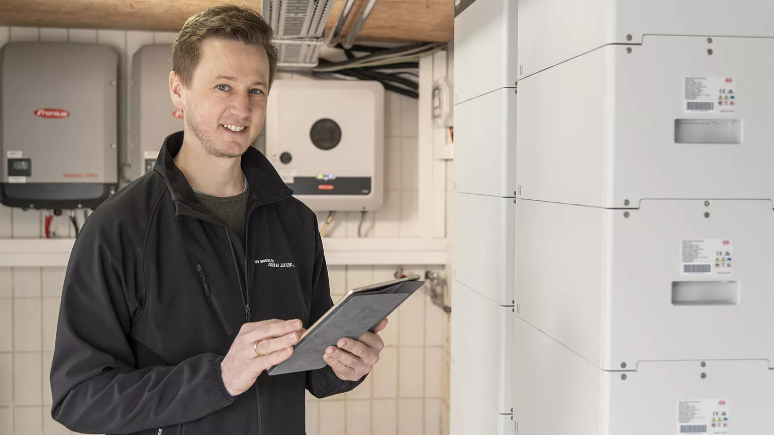

Our Fronius GEN24 Plus is the answer. This hybrid inverter of “made in Austria” quality has been consistently designed and produced with sustainability in mind. In its life cycle analysis, it performs very well in all phases with sustained outputs and outstanding features. The Fronius GEN24 Plus is also quickly installed and delivers optimum yields even when the PV modules are in the shade. We are proud that Martin Paminger opted for our Fronius GEN24 Plus with battery system. The capacity of the storage solution totals 44.2 kWh and now supplies the company with sufficient electricity at night as well. To do so, two battery storage systems (BYD Battery-Box Premium HVM 22.1) were installed. The energy storage device was quickly and easily installed on the ground. Up to three battery storage systems of the same type and size can be connected in parallel, enabling a maximum battery capacity of 57.9 kWh*. In addition to the high battery capacity, the advantage of this combination is that no additional hardware such as a battery inverter is required for this solution, which both saves additional costs and is kind to the environment.

The screenshot from our user-friendly monitoring tool Fronius Solar.web shows that the company can cover 100% of its energy needs. On average, the energy storage device starts in the morning with a residual capacity of 20% and is fully recharged throughout the day using the energy from the PV modules on the roof. At night, the battery system can cover all the demand and no energy is sourced from the grid. In the morning and evening, the energy is drawn from the battery (green) and during the day the generated solar energy is directly consumed by the respective loads (yellow) (see screenshot below)
