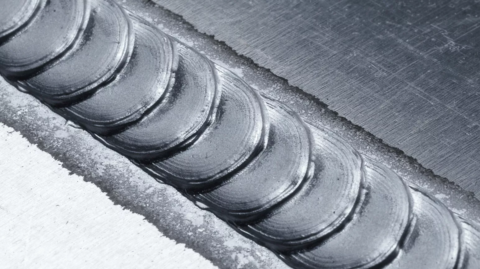

The CMT process is based on a reversing wire movement that enables controlled droplet detachment. This movement ensures a stable arc and minimizes heat input.
This results in almost spatter-free, clean welds that have a high quality and aesthetics. Another advantage of the CMT process is the low thermal load on the workpiece. This reduces distortion and deformation, which is an enormous advantage especially when working with sheets as thin as 0.3 millimeters and temperature-sensitive materials. Precise control of the welding process helps tackle demanding welding tasks with the highest degree of accuracy.
