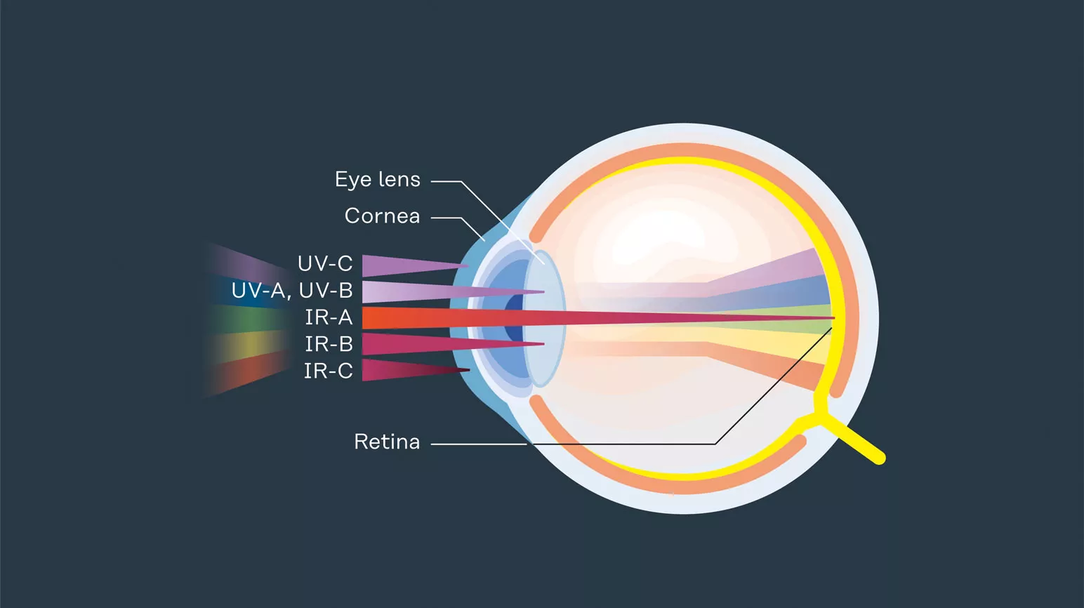

Light types and risk
The arc emits various types of radiation, each of which poses a variety of risks to the health of welders:
Visible light can cause dazzling, impairing the visibility of the welder and creating hazardous working conditions.
Infrared (IR) radiation can penetrate deep into tissue and cause thermal damage. It is often perceived as heat and, if exposed to it for a long time, may result in burns.
Ultraviolet (UV) radiation is particularly hazardous for the eyes and skin. It can damage the cornea and conjunctiva of the eyes, resulting in the aforementioned keratoconjunctivitis photoelectrica (arc eye). It can also cause burns on the skin and, in the long term, skin cancer.
