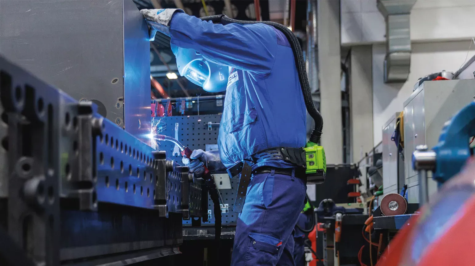

Whenever series production is not a consideration, welding is frequently carried out by hand. Welders often work in positions that strain the joints and muscles, for example when welding while forced to adopt awkward postures. This results in complaints such as sprains of the lower back or arms, which not only affect the health of welding professionals, but also come at the expense of the company’s productivity. Companies are therefore increasingly focusing on ergonomics during welding.

The same applies to welding workplaces. “These should be designed to meet the physical requirements of welders and enable predominantly focused work that does not cause fatigue,” emphasizes Peter Fronius, Head of Strategic Product Management Professional Welding Tools. “For example, by taking the height or arm reach of the welders into account. If workplaces do not satisfy ergonomic standards, the likelihood of sickness, injury, and absence through illness increases.” Of course, ergonomic risk factors cannot be eliminated every time and everywhere. This is the case for out-of-position welding, for example, whereby the aim must be to limit the time that the individual spends in the situation insofar as possible.

Time and again, welders are forced to adopt unfavorable postures for a variety of tasks—frequently over long periods of time. It is often easier for the welder to move around large, heavy components themselves than to move the component into the optimum welding position. Is it therefore paradoxical to talk about ergonomics and welding in the same sentence? Absolutely not. Because despite all the hindrances, there are plenty of ways in which welding companies can design workplaces and work equipment ergonomically. Effort that is generally rewarded by a healthier workforce, better morale, higher productivity, and enhanced product quality. For example, height-adjustable welding tables and stools are tried and tested means of adapting the welding height to the physical requirements of welders.
