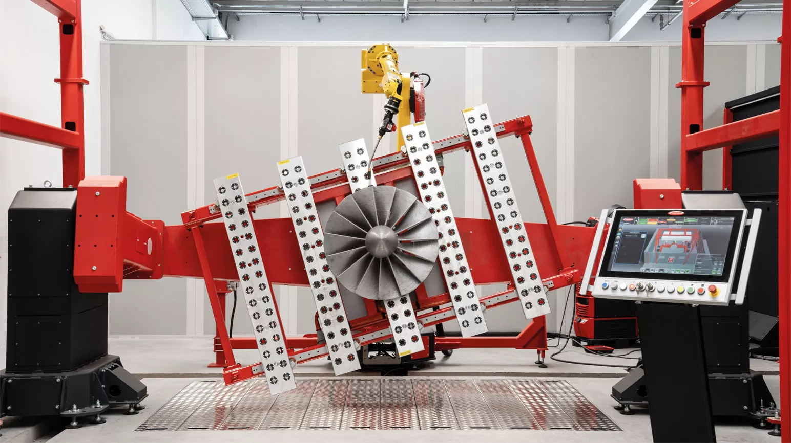

Prototypingcenter roboter
MIG/MAG (CMT) robotic welding cell. HMI-T21 system controls guarantee real-time views in 3D, while the high-resolution ArcView 2 weld seam monitoring camera provides a direct view of the weld pool.
