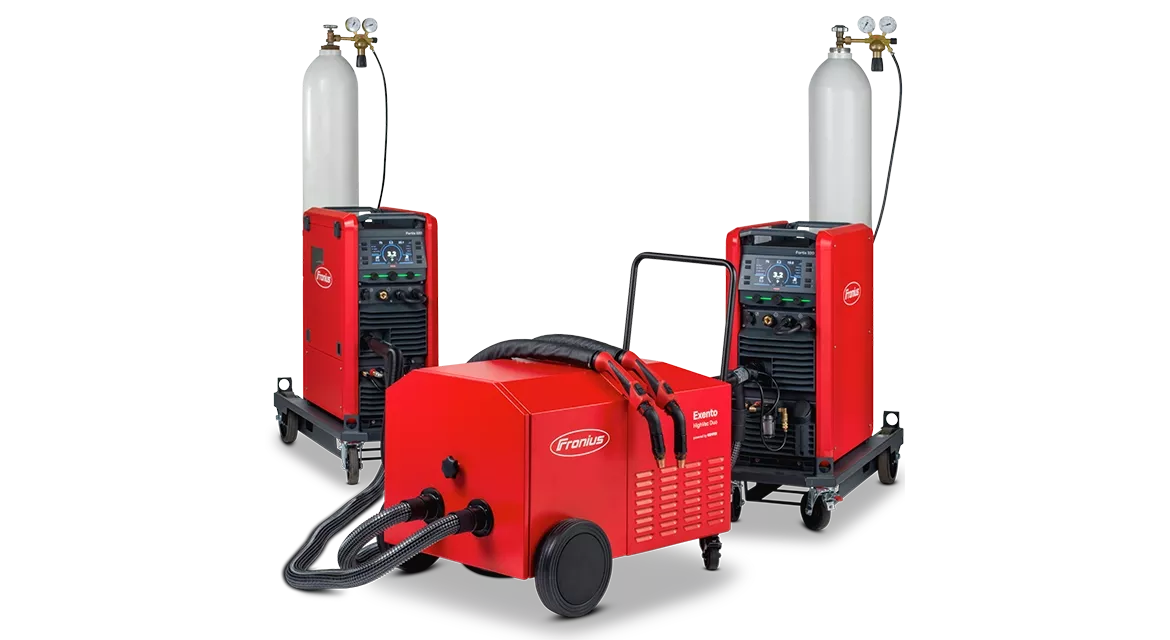

    Exento HighVac Duo: Extraction system for up to two workstations
    All the advantages of the tried-and-tested Exento HighVac can also be found in the Duo version—but with a decisive addition: it also allows the simultaneous operation of two fume extraction torches. W3 certification in accordance with EN ISO 21904-1 has already been applied for.
    Intuitive single-button operation makes the machine easy to use even when wearing gloves. Our Exento fume extraction torches can be directly and easily connected via two connections sockets (each with a nominal width of 45/63 mm).
    Like the single-location solution, the Exento HighVac Duo can also be equipped with useful options such as the automatic start/stop function.
    Fronius HighVac Duo welding fume extraction system and Fronius Fortis
    HighVac Duo technical data
      Exento HV Duo 400V Exento HV Duo 460V Exento HV Duo 600V
    Mains voltage -10/+10% 3 x 400 V 50/60 Hz 3 x 460 V 50/60 Hz 3 x 600 V 50/60 Hz
    Motor power 3.8 kW / 5.1 hp 3.8 kW / 5.1 hp 3.8 kW / 5.1 hp
     Nominal current 8.1 A  8.1 A  6.2 A
    Max. extraction capacity 280 m³/h / 165 cfm
    Max. negative pressure 32,000 Pa / 129 in wc
    Sound pressure level 75 dB(A)
    Protection class IP 21
    Dimensions l x w x h 1,018 x 691 x 878 mm / 40.1 x 27.2 x 34.6 in
    Weight 96 kg / 212 lb
     Filter stage 1
     Filter process  Surface filter
     Cleaning process   Rotary nozzle
     Cleaning trigger  Semi-automatic via button
     Filter area  6.7 m2 / 10,385 in²
     Filter type  Filter cartridge
     Filter material  ePTFE membrane
     Extraction efficiency rate  ≥ 99.9%
     Dust class  M
     Fan type Side channel compressor
     Compressed air supply  6-8 bar / 87-116 psi
     Automatic extraction capacity regulation Yes
     IFA certification  W3 certification applied for
