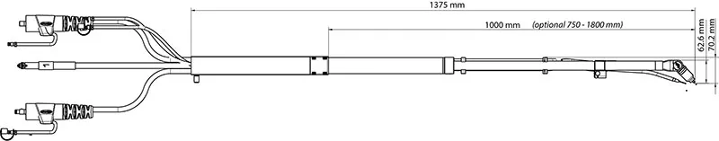

Slim welding torch – small internal diameter
The fully re-developed welding torch system allows you to weld significantly smaller inner component diameters.Send inquiry about SpeedClad 2.0

Technical data
| Welding torch | TTHW 6000 SC / Ø100 |
| DC welding current at 100 % D.C. | 600 A |
| Electrode diameter | 4,8 mm |
| Standard working length | 1000 mm |
| Optional working length | 750–1800 mm |
| Standard total length | 1483 mm |
