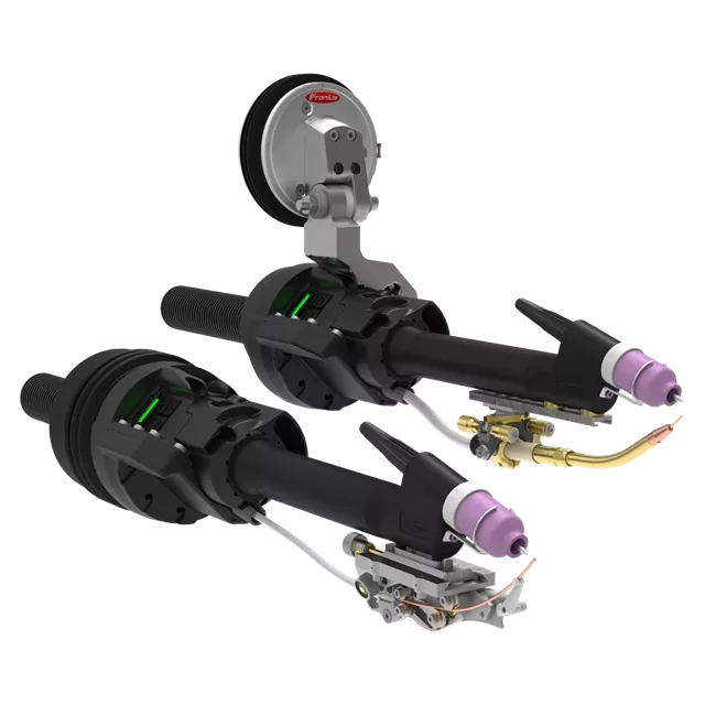

Specially developed for robotic applications, our “i” series sets new standards in flexibility and efficiency. It combines outstanding technological performance with ease of maintenance, facilitating clean and precise control and monitoring of the welding process—perfect for demanding industrial processes.
WIG welding body "i"
“i” torch body
  • Torch bodies in a range of shapes and sizes
  • Integrated connection for trailing gas and water cooling
  • Detachable wirefeed
  • Suitable for hollow-arm robots and conventional robotic applications
  • Integrated BID (welding torch ID) for detection and tracking during the production process
TIG torch hose package
“i” TIG welding torch hosepack
A particularly high degree of efficiency is achieved through the use of an internal wirefeeding hose for hollow-arm robot systems. The four buttons integrated on the hosepack permit intuitive control, while the status LED provides immediate feedback on the operating status. The direct control of important functions – such as forwards/backwards movements of the wire, gas flow/gas test, and cooling circuit on/off – means that operation from the power source is no longer necessary.

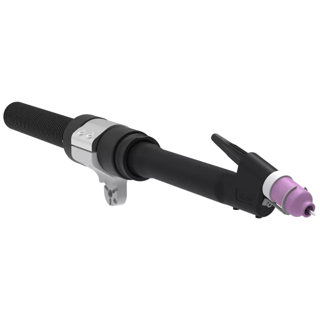

The “s” series is the ideal solution for more straightforward applications and strikes the perfect balance between performance and cost effectiveness. Whether for cost-effective applications or collaborative robot systems (cobot cells), the “s“ series delivers precise results at maximum levels of efficiency.
“s” torch body
  • Two torch bodies in a range of shapes and sizes
  • Ideal for conventional robots, mechanical applications, and cobot cells
“s” TIG welding torch hosepack
The “s” series welding torch hosepack is designed specifically for conventional applications. It is characterized by its ruggedness and flexibility. It offers reliable performance for mechanical applications and supports all the functions necessary for efficient, standardized welding processes.
  • Robust hosepack for conventional applications
  • Ideal for mechanical processes
  • High reliability and flexibility for simple welding tasks

TIG torch Standard M
Cold-wire feed “Standard M”
  • Slimline design for a clear view of the weld pool
  • Mechanical locking for constant wire position and stable wire feeding
  • Easy handling when changing the gas nozzle
  • Can be locked in place at any angle
TIG torch standard r
Cold-wire feed “Standard R”
  • Adjustment mechanism positioned along the guide rail
Wire Feeder
Cold-wire feed “Low Friction”
This cold-wire feed is ideal for welding tasks that require a steeper and shallower wire feeding angle.
  • Welding torch angle adjustable according to the application
  • Fine adjustment possible for precise applications
  • Can be retrofitted and removed
  • Mountable on standard torch bodies
