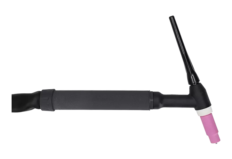

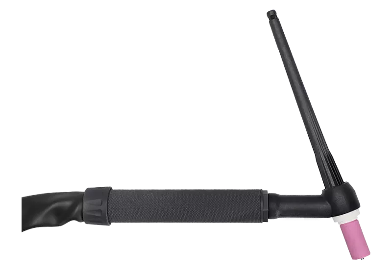

Fronius welding torches represent the perfect symbiotic relationship between technology and ergonomics. The ergonomic handle with anti-slip components lies comfortably and securely in the hand, allowing the torch to be guided with ease. Various operating concepts take care of the most varied welding requirements.
