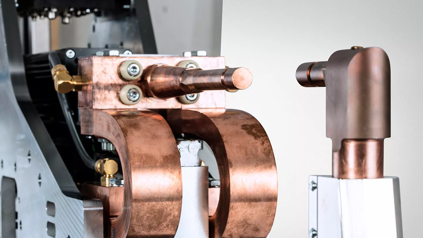

DeltaCon C-gun electrode
DeltaCon
DeltaCon is an electrical resistance spot welding system with conventional spot welding technology.

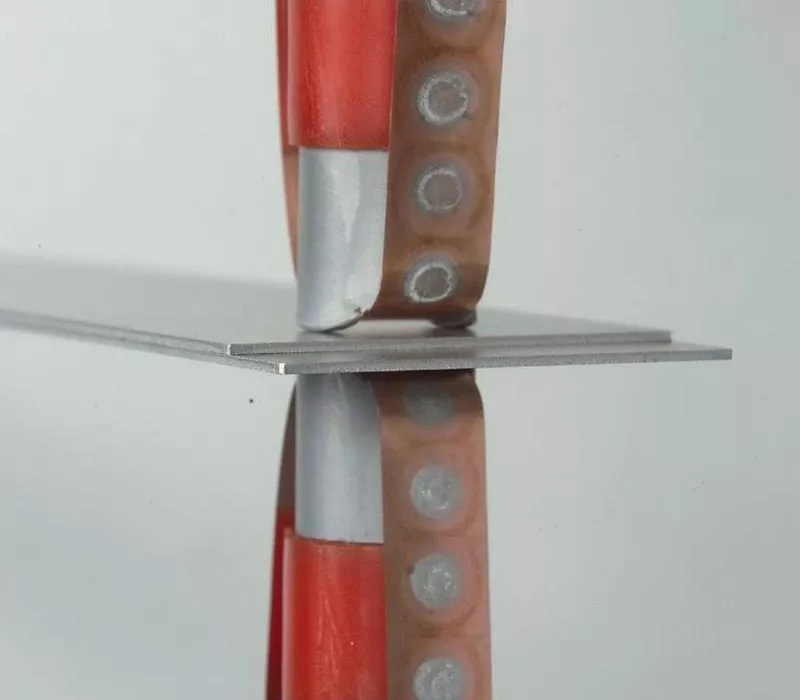

DeltaSpot, resistance spot welding, electrodes
DeltaSpot
DeltaSpot is a globally unique resistance spot welding process, which allows aluminum and various other challenging materials to be welded together. The system is based on a rotating process tape.

Process tape
The process tape of the DeltaSpot electrical resistance spot welding system is a continuous process tape that presents a key welding parameter thanks to its resistance while simultaneously protecting the electrode against pick-up and contamination. Each welding spot is welded under the same contact conditions.

Resistance spot welding
The principle of resistance spot welding is based on current, resistance, and time. When maximum resistance is applied, the material fuses. Due to the high contact pressure, exerted by the effect of the electrode force, the components are welded together at their points of contact.
More on the topic of resistance spot welding
