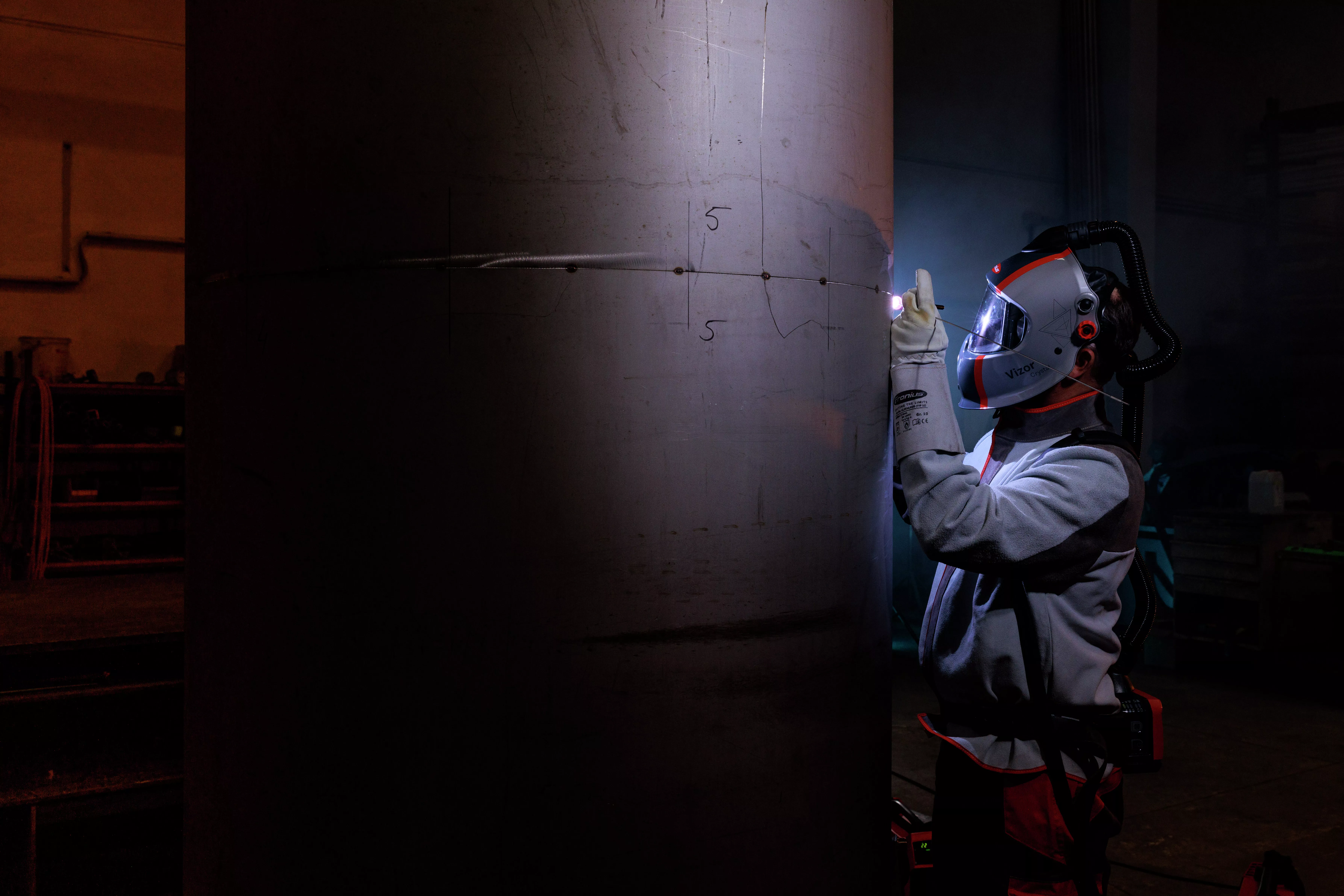

What is
TIG welding

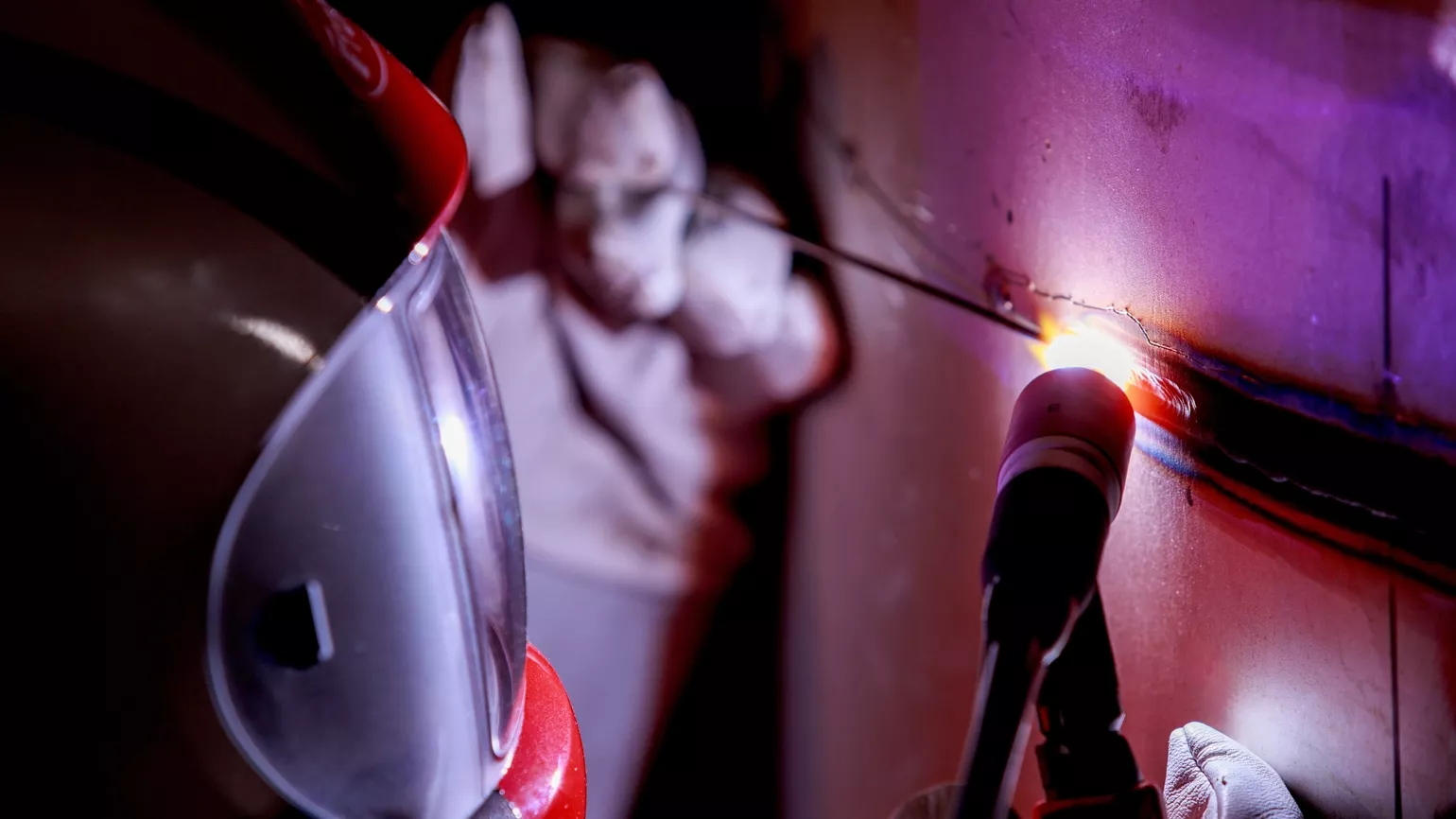

Welding is done with the Artis welder
TIG welding:
clean weld seams, secure bonds
Tungsten Inert Gas welding (or TIG welding for short) is a gas-shielded welding process and is classified as a fusion welding method. Used wherever top quality, spatter-free seams are a must, TIG welding is suitable for materials including stainless steels, aluminum, and nickel alloys, and thin sheets of aluminum and stainless steel.

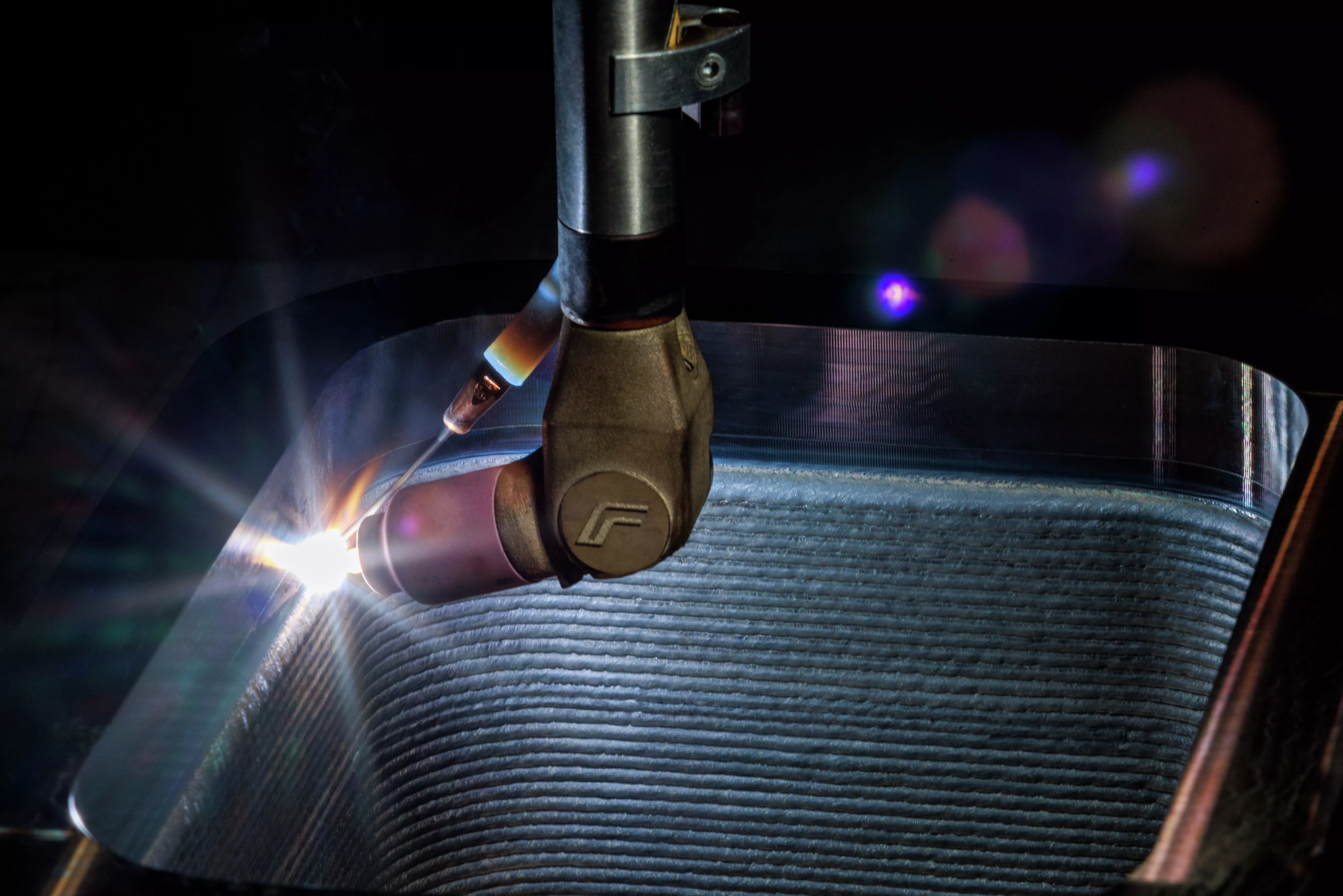

Versatile process for manual and automated welding
The TIG method can be used for both manual and automated welding, offering unbeatable precision and consistent quality. Typical applications include pipeline and container construction, gantry construction, and the aerospace industry.
WIG-welding

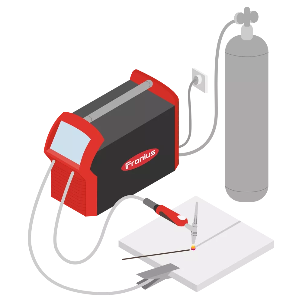

How it works
With TIG welding, the current is supplied through a heat-resistant tungsten electrode that does not melt. The resulting electric arc melts the material within a protective gas shield. The shielding gas (such as argon or helium) is supplied via a nozzle and protects the weld pool against reactions with the air and ensures high-quality weld seams. Since the electrode does not melt, the filler material is fed separately either by hand or via a wirefeeder.

Setup of a TIG welding machine

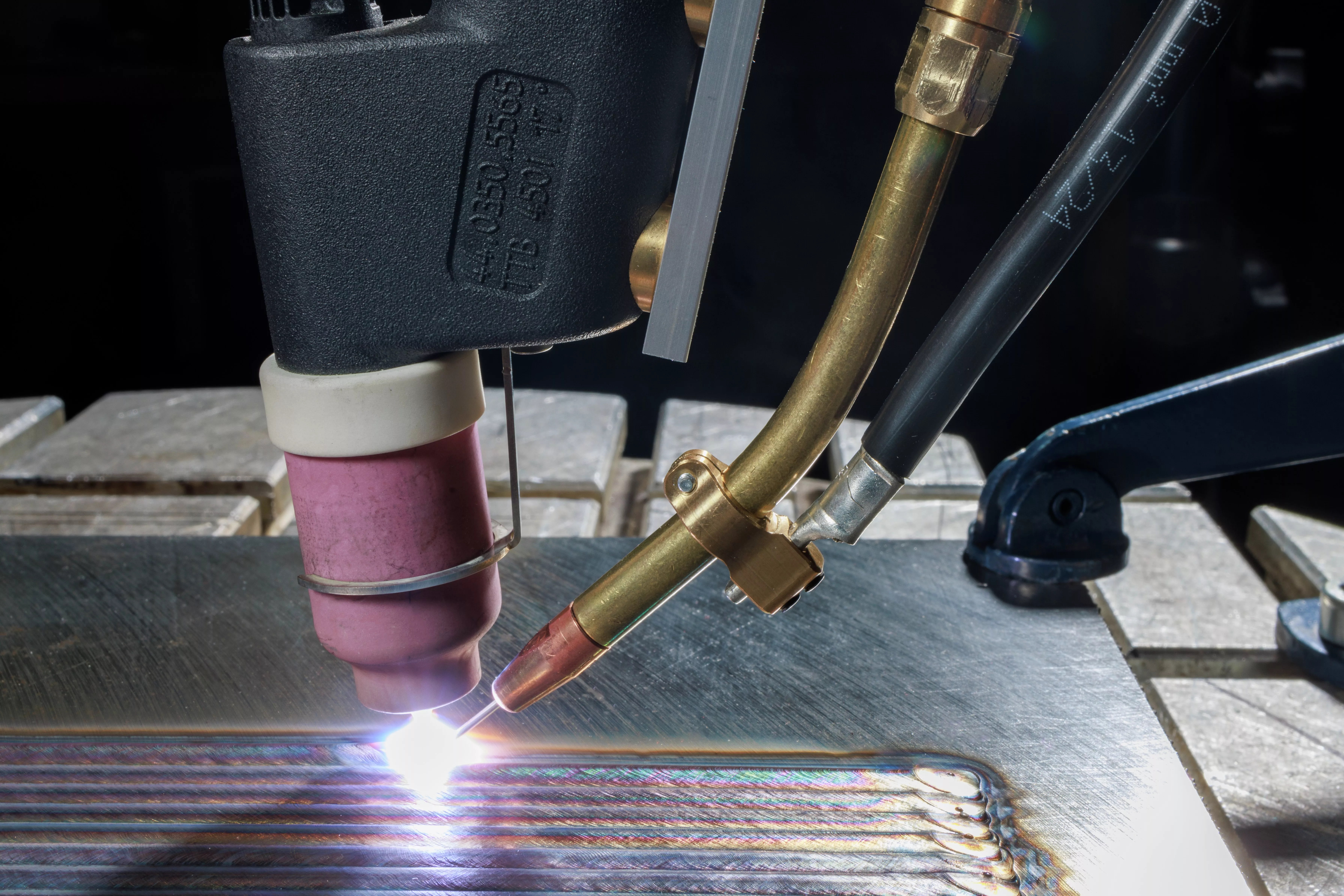

TIG cold-wire welding
A cold-wire feed increases productivity. The filler metal is fed evenly into the weld pool with absolute precision and at a higher welding speed, enabling even less-experienced welders to achieve outstanding results.
Hot-wire welding
TIG hot-wire welding is a further development of TIG cold-wire welding, whereby the filler metal is heated before being introduced into the weld pool. This offers several advantages, such as a higher burn-off amount and rate, increased welding speed, and reduced dilution.

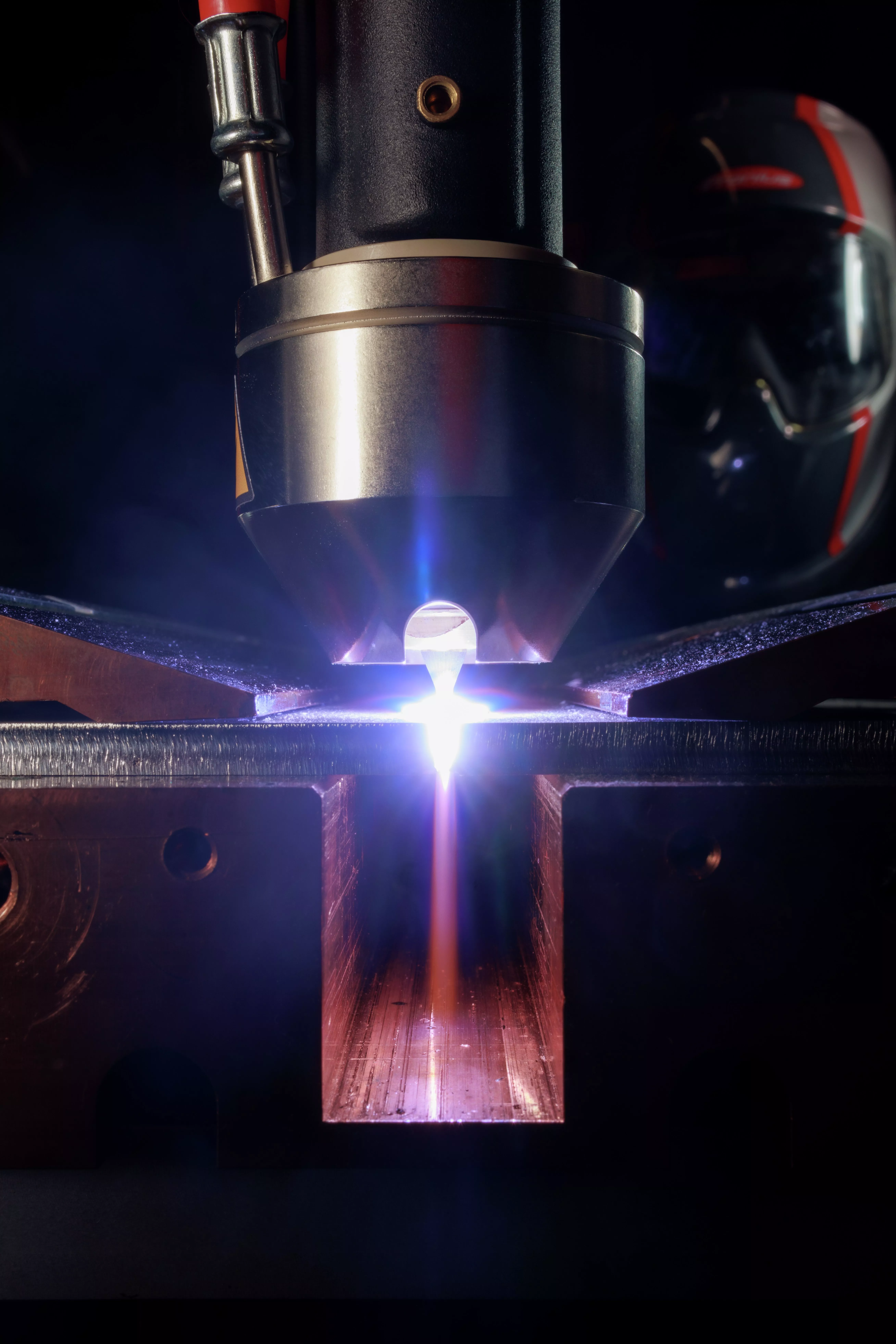

Plasma welding
Plasma welding is a precision welding process for mechanized applications that enables both keyhole and conventional welding, while also offering the advantages of high speed, spatter-free weld seams, and a wide process window.

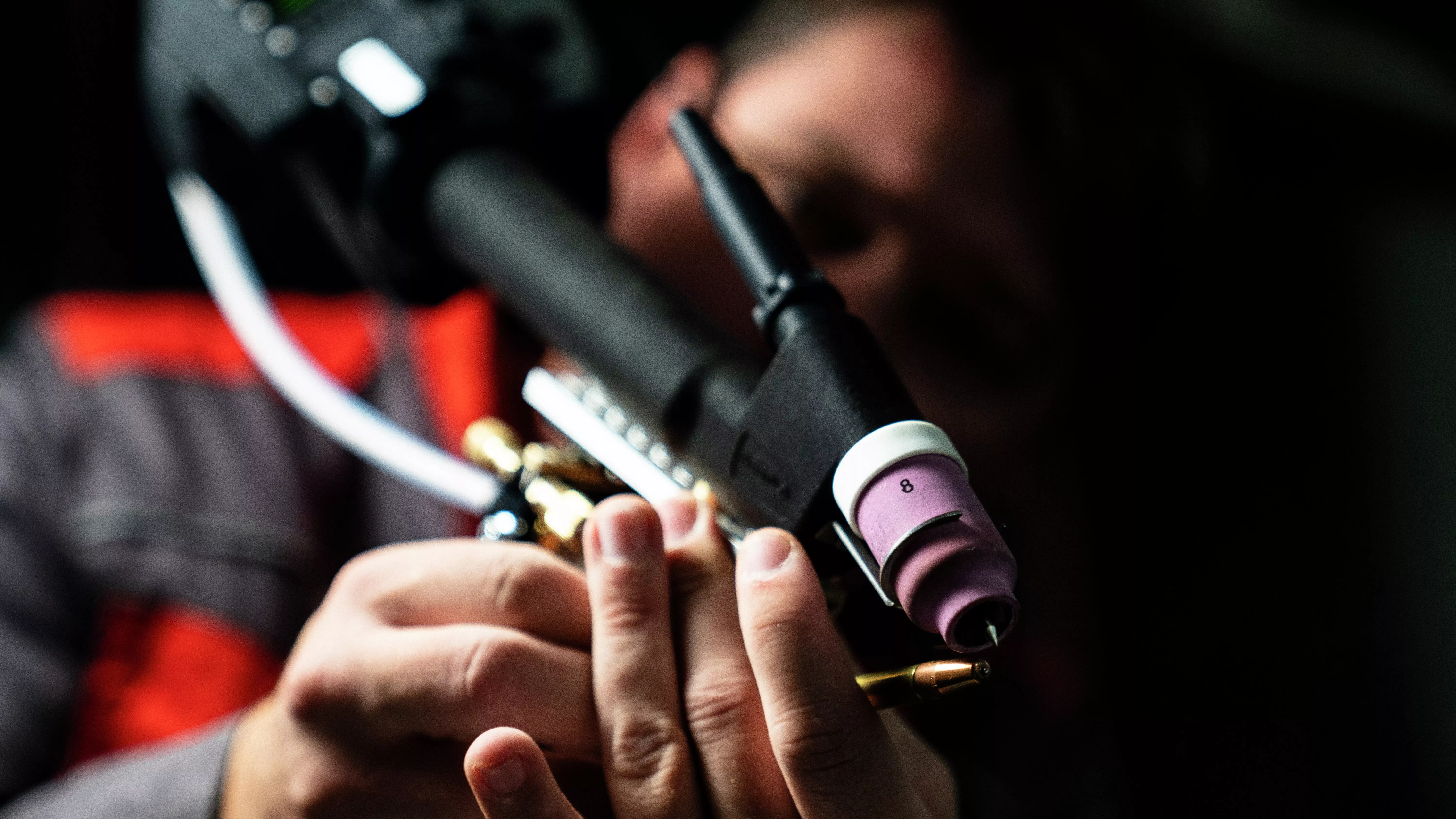

TIG welding torch for manual applications
Fronius welding torches strike the perfect balance between technology and ergonomics. Various operating concepts take care of the most varied welding requirements.
