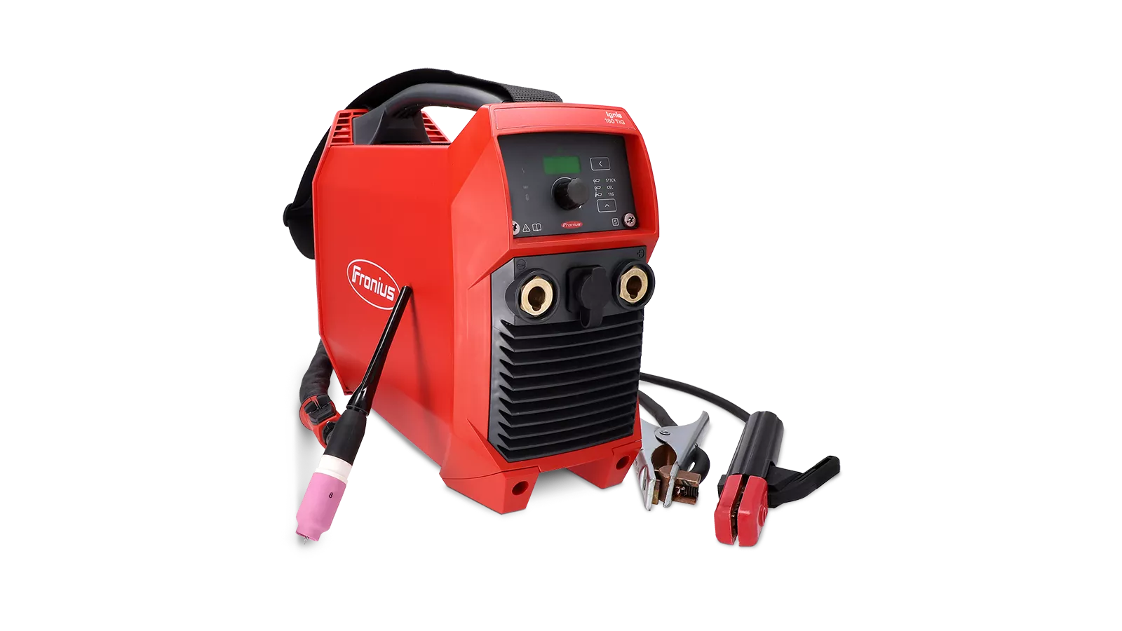

Ignis TIG
Technical Data
General Data
| Welding current min. | 10 A |
| Welding current max. | 180 A |
| Operating voltage min. | 20,4 V |
| Open-circuit voltage | 101 V |
| Dimension / length | 435 mm |
| Dimension / width | 160 mm |
| Dimension / height | 310 mm |
| Weight | 9 kg |
| Mains cable included | Yes |
| Earth connection | Dinse_small |
| Length of mains cable | 2500 mm |
| Maximum working voltage | 29 V |
Contact
Find out more about the features of the Ignis welding machine.
Current firmware and software updates for the Ignis.
Function overview
| Functions |
Ignis 150 | Ignis 150 TIG | Ignis 180 / 180 XT |
Ignis 180 TIG / 180 TIG XT |
| HotStart | x | x | x | x |
| SoftStart | x | x | x | x |
| Anti-stick | x | x | x | x |
| MMA Pulse | x | x | x | x |
| TAC tacking function | x | x | ||
| TIG Comfort Stop | x | x | x | x |
| TIG Pulse | x | x | ||
| TIG Multi Connector | x | x | ||
| TIG welding torch operation | x | x | ||
| Remote control operation | x | x | ||
| Time shutdown (300 s/900 s/off) |
x | x | x | x |
| TrackingArc | x | x | x | x |
| XT variant | x | x |
