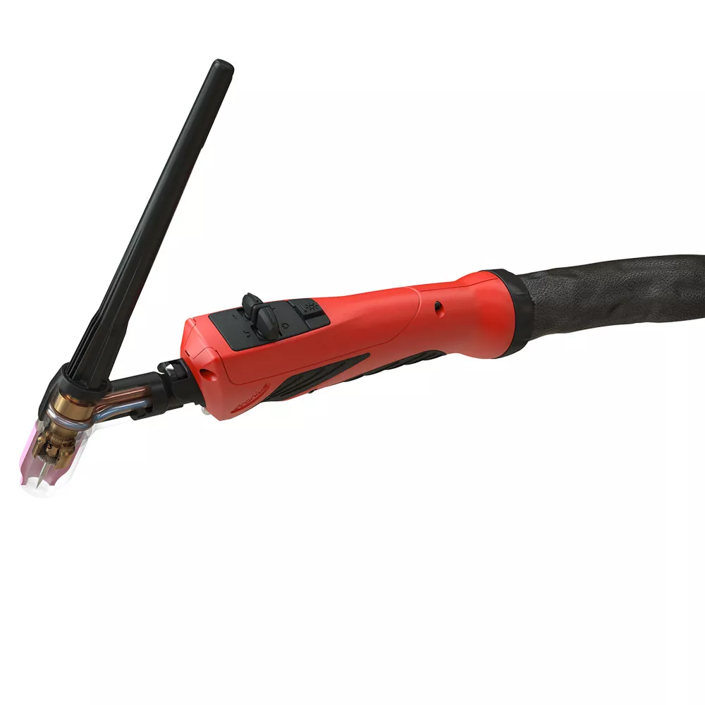

    Operation
    Fronius welding torches represent the perfect blend of technology and ergonomics. The ergonomic handle with non-slip components sits comfortably and securely in your hand, allowing the torch to be guided with ease. Various operating concepts take care of the most varied welding requirements. Depending on the application, welders can choose between a standard or a small handle hosepack.

    Standard handle
    one handle for all versions
    Simple conversion* from the user interface, only one screw needs to be unscrewed.
    1. UpDown
    2. JobMaster
    3. Potentiometer
    *) Option only applies to standard handle

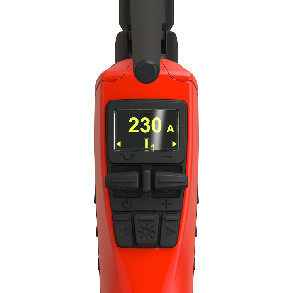

    JobMaster

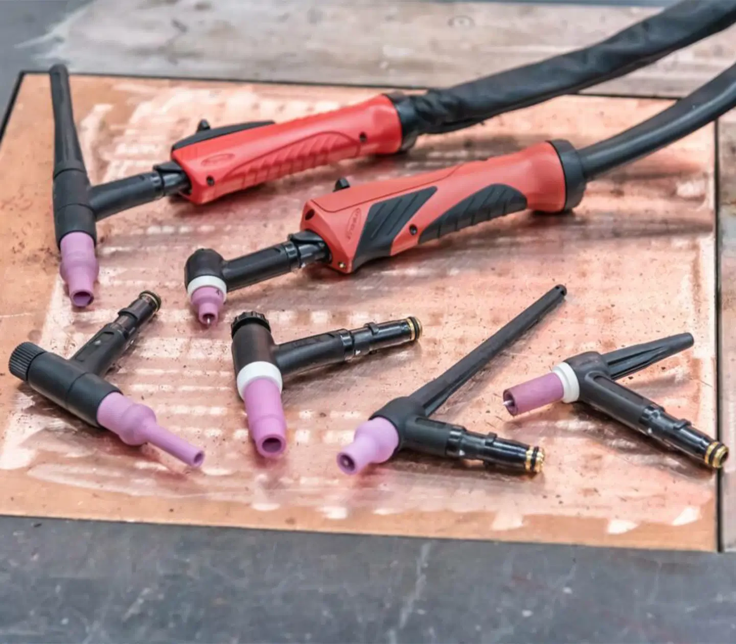

    Flexible welding made easy: the modular construction of the new TIG Multilock welding torch allows the torch to be customized to suit practically any customer requirement. Multiple torch cap sizes as well as a rotatable torch body available in several lengths help overcome challenging accessibility situations and make handling the torch a breeze.
    Multilock
    for fast torch body changes
    • Patented interface
      The torch body can be changed quickly, easily and without the need for tools – no matter what the welding task.
    • 360°
      The torch body can be turned through 360° for an optimum welding position every time.

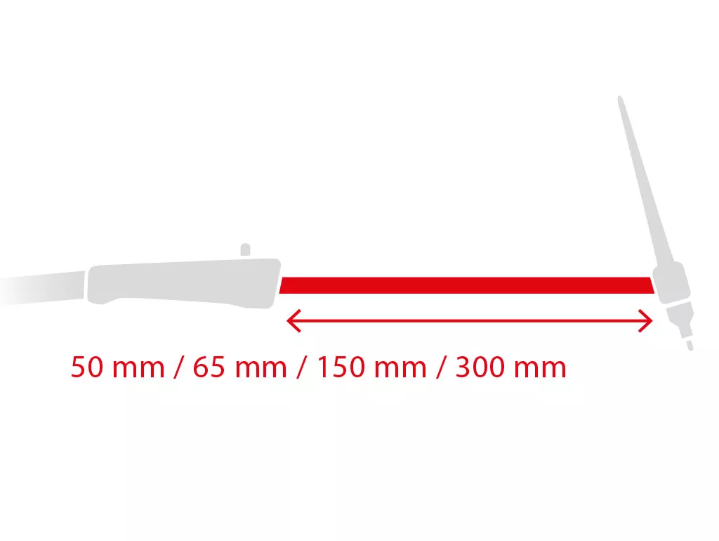

    Torch body lengths
    Different torch body lengths ensure maximum flexibility while welding.

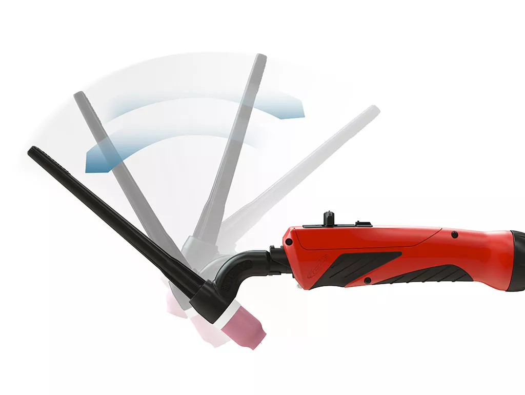

    Flexible torch bodies
    The flexible torch bodies can be bent into the desired position for difficult to access welding points.*

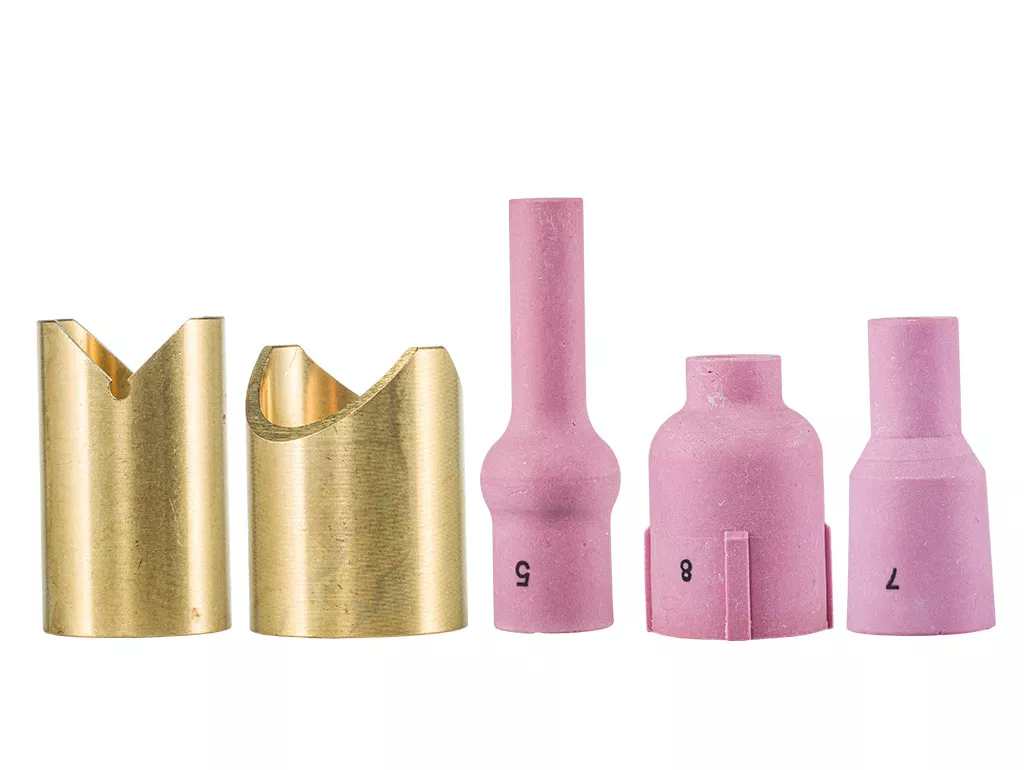

    Gas nozzles
    More than 80 gas nozzles available.
