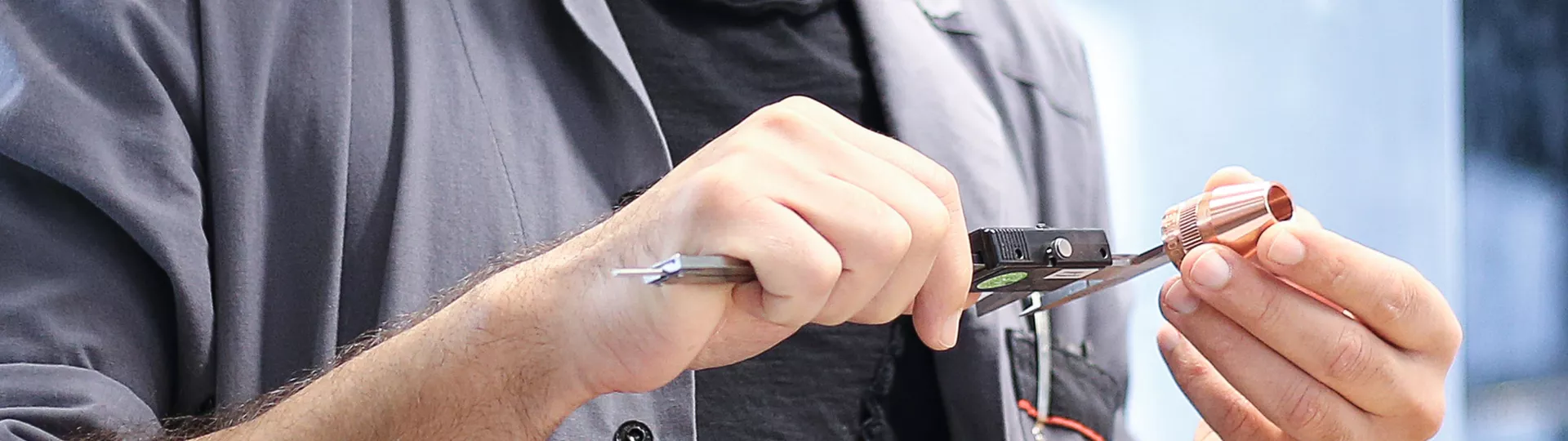

Close-up of wear parts for a welding torch.
