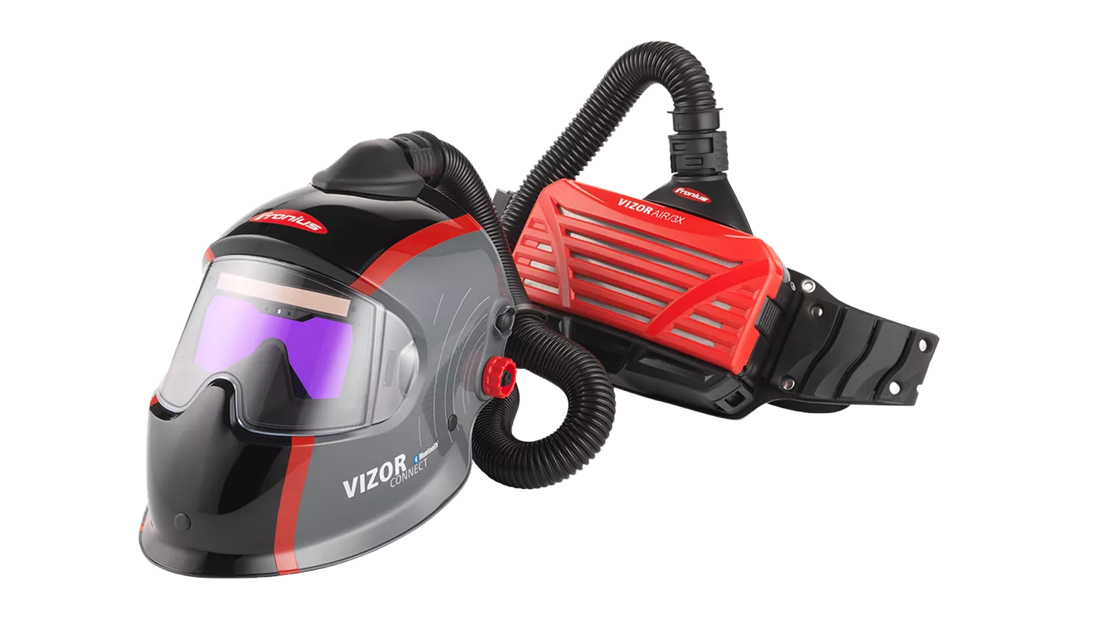

Vizor Air/3X
AUTOMATIC EYE PROTECTION WITH FAN FILTER DEVICE
Vizor Air/3X is a protection system for the eyes and airways that makes no compromises in occupational health and safety or comfort. In addition to proven glare protection technology, a unique air flow system within the welding helmet offers infinitely variable air distribution between the forehead and breathing zones. Vizor Air/3X is therefore a truly “clean” solution for the user, as 99.8% of particles are filtered out and pleasant cooling is provided for the welder.
The lithium-ion battery delivers an operating time of up to 18 hours. An acoustic and visual alarm is triggered if the battery is low, the filter is clogged or missing, or in the event of low air flow.
The system is used where the environmental conditions do not allow for optimum extraction of the welding fumes, for example for flexible welding work, or work in confined spaces and highly polluted ambient air.
Product details
General Data
Shade level range2,5/7-12 (man.) bzw. 2,5/5-12 (auto)
Maximum air flow / fresh-air supplyLevel 1: min. 170 nl/min Level 2: min. 210 nl/min Level 3: min. 240 nl/min
Switchover time / darken0,1 ms
Switching time dark / light0,1s-2,0 s
Cartridge size [LxBxH]58x125mm
Ergonomics +
  • In order to do justice to work ergonomics, a 4-point Ergo shoulder strap is available in addition to the breathing protection system
  • This relieves the user and the weight is more evenly distributed over the upper body
  • 4-point shoulder carrying system for balanced weight distribution!
