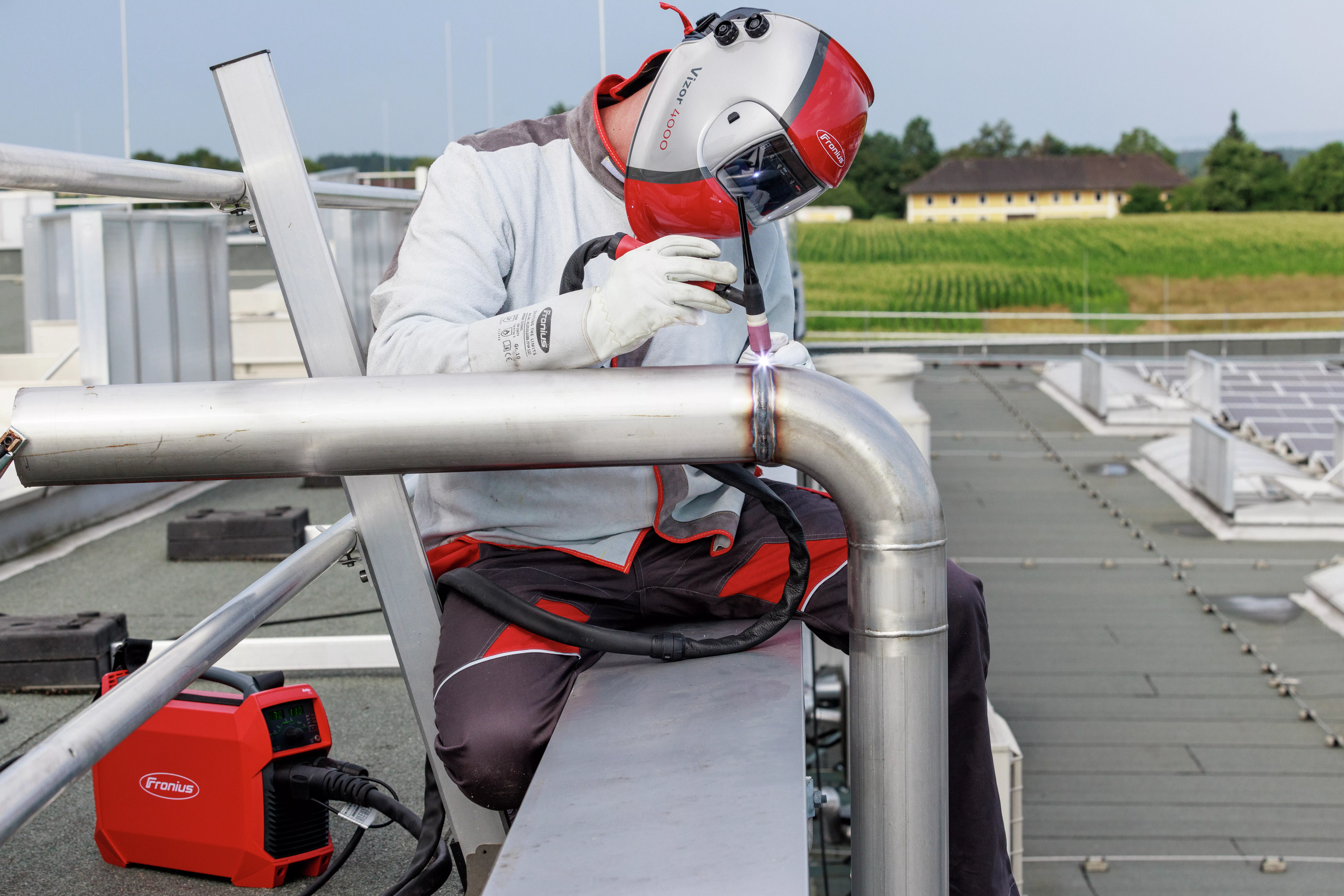

What needs to be considered during stainless steel welding?
Welding stainless steel
Almost any welding process can be used for welding stainless steel. When choosing the process, you should be guided by the type of component and the requirements for the weld seam. Pay particular attention to the choice of filler material: If the wrong filler metal is used, there is a risk that the welding point will not achieve the same strength as its surroundings. This may result in the steel at this point not only rupturing, but also rusting. Before welding, you must therefore be sure about what kind of stainless steel you are using and select the filler metal accordingly.
