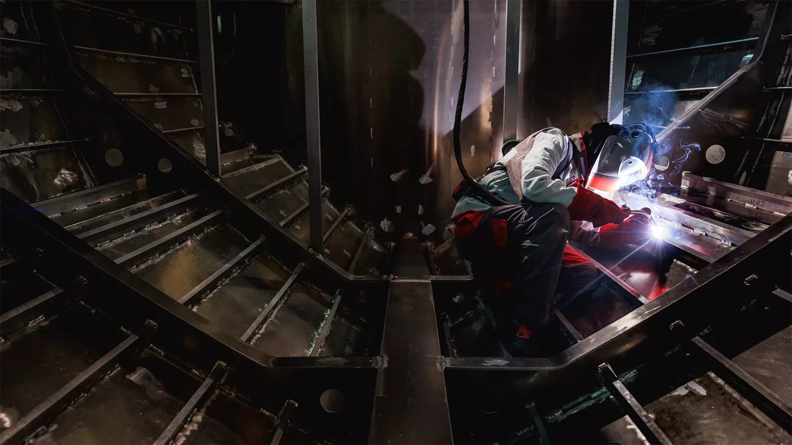

What hazards and dangers do welders face due to welding fumes?
All welding processes produce fumes, gases, and vapors that affect welders. How harmful the welding fume released actually is depends on the welding process, the base material, the filler metals—from the filler rod and wire electrode—and the shielding gas.
Most of the welding fume particles produced come from the filler metals used during welding. Without adequate protection, welding fumes can lead to acute symptoms such as headaches and nausea, and over a longer period of time can even cause chronic respiratory illness and lung disease, damage to the nervous system or cancer.

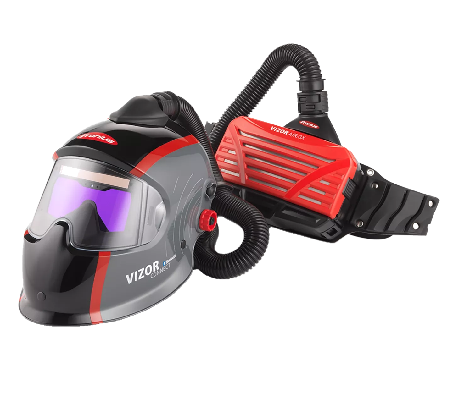

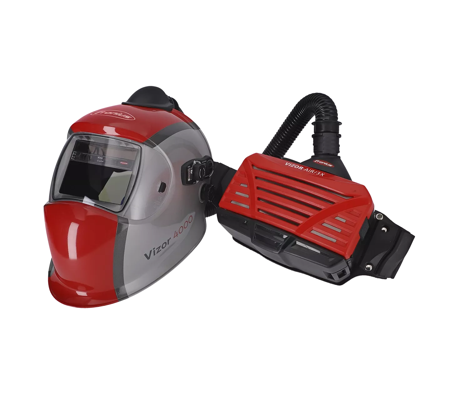

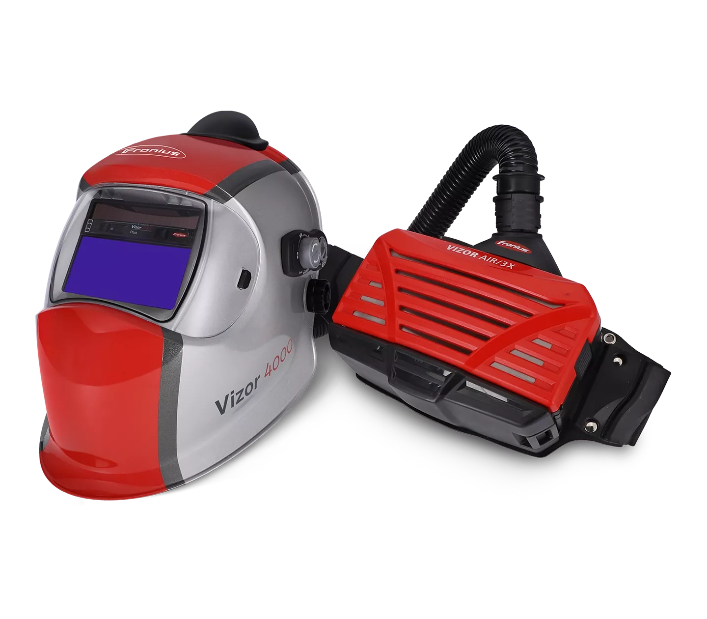

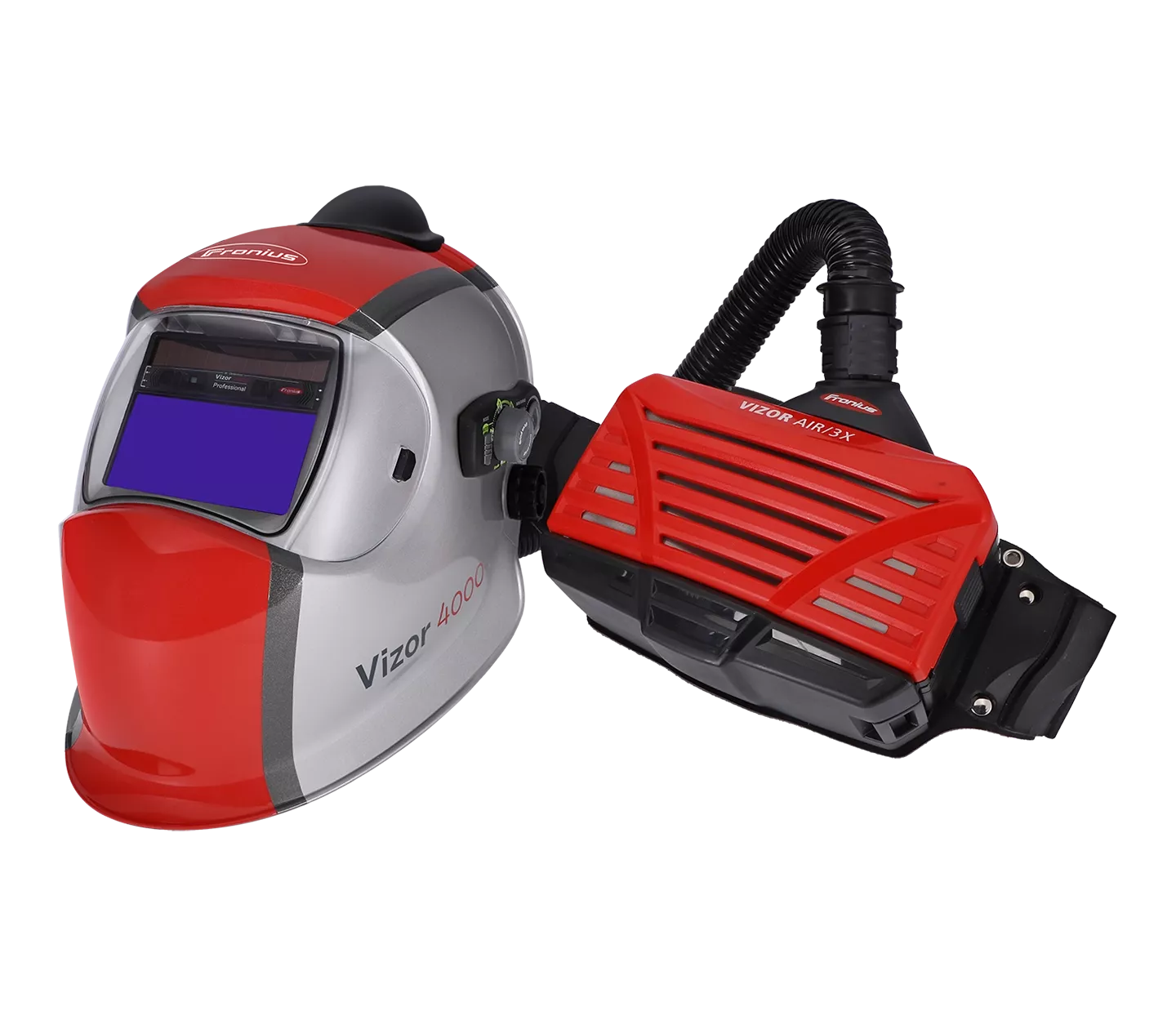

Vizor Air/3X respiratory protection system—for filtered air and crystal clear vision
Our Vizor Air/3X PAPR system provides reliable respiratory protection during welding. It consists of a powered air-purifying respirator, air hose, and carry strap.
In combination with one of our compatible welding helmets, the system filters up to 99.8% of welding fume particles out of the ambient air. This is made possible by a TH3P-R-SL particle filter, the highest protection classification for respiratory protection filters.
The purified air is fed directly into the welding helmet via the connecting hose—for fresh air and unbeatable protection during every welding task.

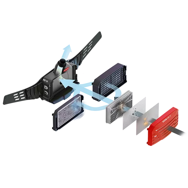

Design of the powered air-purifying respirator

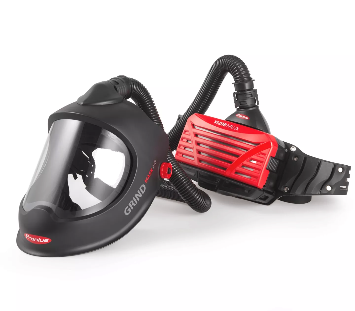

Grind Mask Air/3X

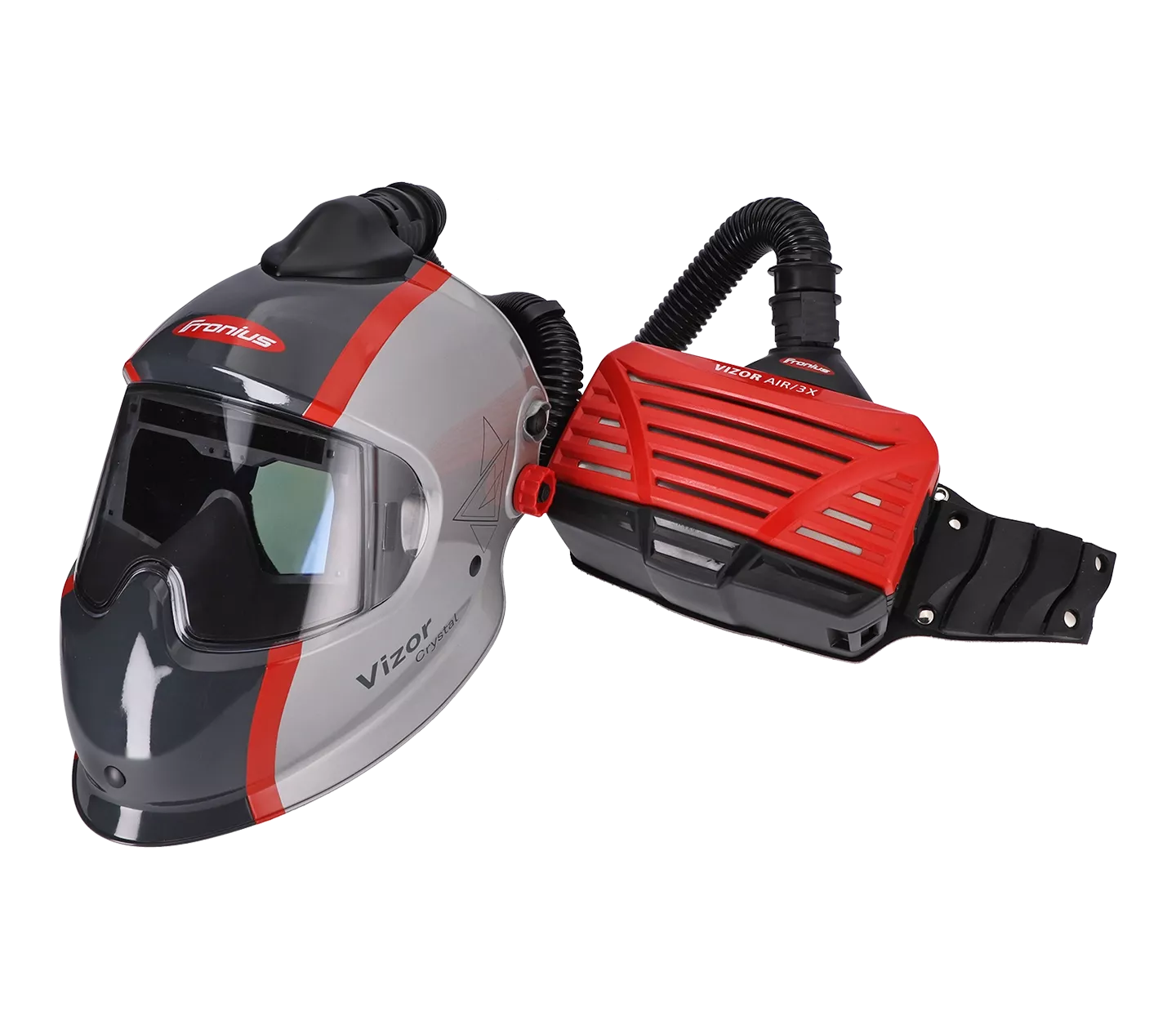

Vizor 4000 Air/3X Crystal
Vizor Crystal
Vizor Air/3X Crystal helmet with fresh-air supply

Vizor Air/3X technical data
Air delivery
 Level 1  min. 170 nl/min
 Level 2  min. 210 nl/min
 Level 3  min. 240 nl/min
 Filter  TH3P-R-SL filter for TH3P system (EU)
 Battery
 Voltage / capacity  14.8 V / 3.25 Ah
 Charging cycles  > 500
 Charging time  approx. 8 h
 Operating time level 1  18 h (at room temperature with new filter)
 Operating noise  max. 70 dB(A)
 Total weight  1575 g (without helmet)
 Standard  EN 12941:1998 TH3
 Certification  CE, NIOSH-approved
