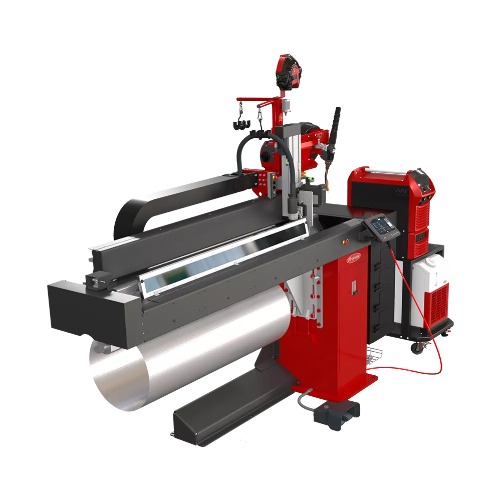

Fronius modular clamping bench iSeamer
iSeamer

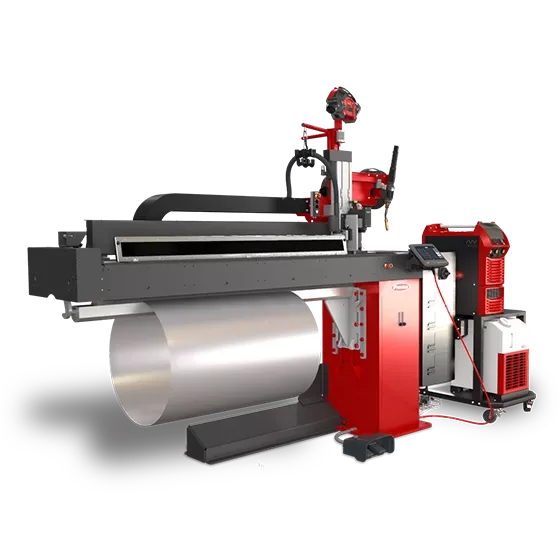

The iSeamer is a modular seam welder that combines solid mechanical engineering with powerful system controls. It is capable of processing cylindrical and conical components using configurable variants and conventional welding processes. This allows dependable, high quality welding of pipes with diameters of 80 to 1250 mm and straight sheets with component lengths of up to 4100 mm.
The advantages for you
Integrated platform
Reproducible weld seams thanks to the combination of robust machine design, modular mechanics, and standardized system controls.
Intuitive system controls with Polaris
Central user interface for all welding and clamping functions, and for adapting to different applications.
Exact clamping and precise positioning
Optional positioning aids and material-specific clamping jaws facilitate shorter tooling times and a simplified setup procedure.
Multiprocess
Supports all common welding processes including MIG/MAG, CMT, TIG, plasma, and ArcTIG.

Modular system concept
iSeamer versions at a glance
 iSeamer types 600 1100 1600  2100 2600 3100 4100
 Weld length (mm) 600 1100 1600 2100 2600 3100 4100
 Material thickness (mm) 0.5 – 8.0
 Min. component inside Ø (mm) 80 80 150 190 200 250 350
 Max. component outside Ø*(mm) 1050 1050 1050 1150 1150 1250 1250
* Excluding machine base, larger diameters possible with height adapter (optional)
Custom adaptations for extended component dimensions
We supply customer-specific seam welder solutions for non-standard applications. Based on tried and tested technology, the iSeamer is tailored to your geometries and welding processes from a component length of 4100 mm. This means that even large-format or specialized components can be processed reliably with repeatable results.
