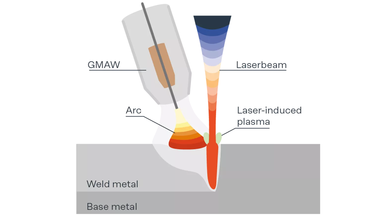

How the LaserHybrid welding process works
During LaserHybrid welding, the laser beam and arc act on the workpiece simultaneously. The laser ensures deep energy penetration, while the GMAW arc feeds filler metal and stabilizes the weld seam profile. The laser-induced plasma helps to guide the arc.
Depending on the application, various arc characteristics are used, such as PMC (Pulsed Multi Control) or CMT (Cold Metal Transfer). When combined with CMT in particular, it’s possible to significantly reduce the heat-affected zone, which means that the mechanical properties of the welded joint are largely preserved compared to those of the base material.
