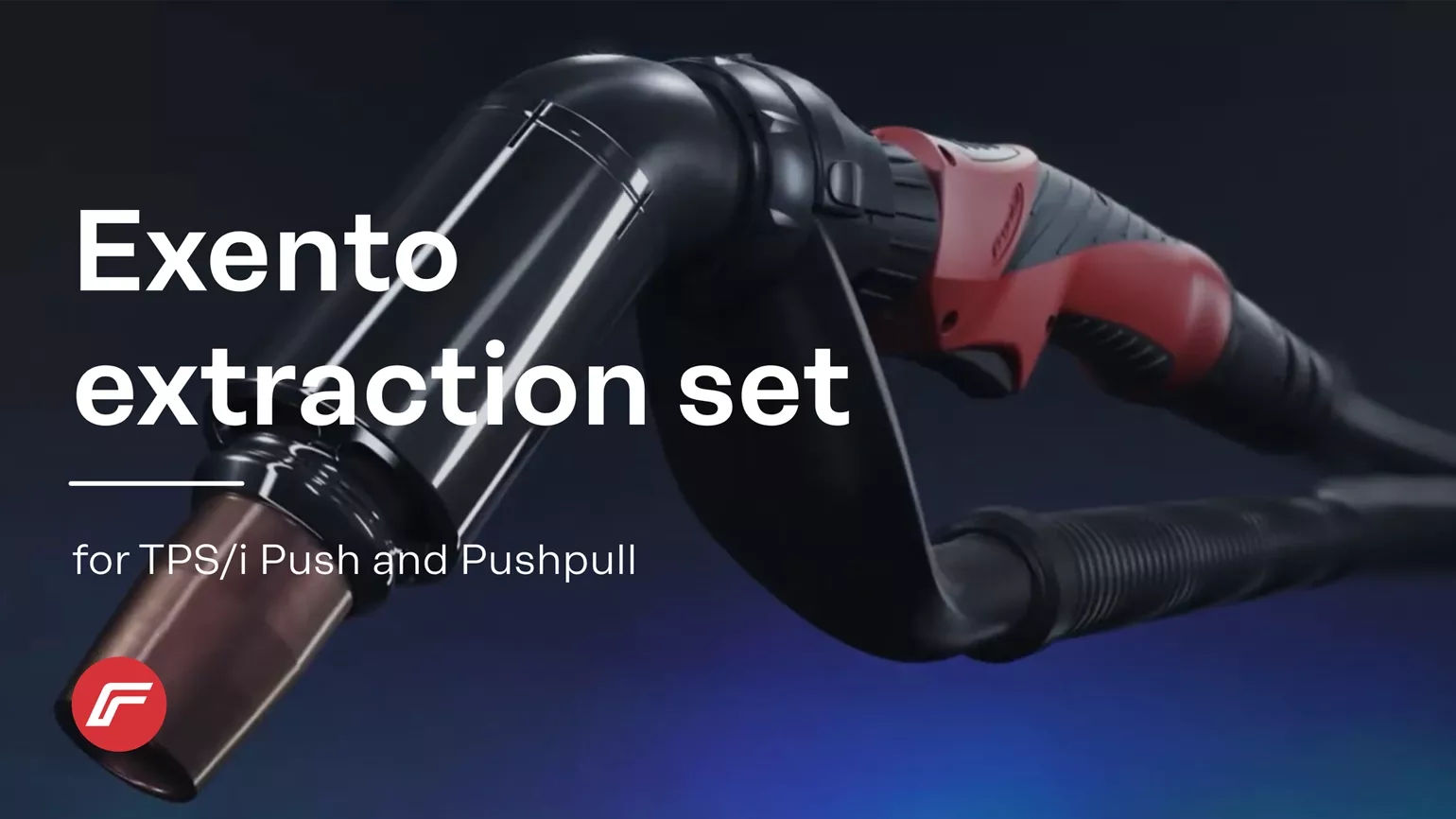

Exento extraction kit
Welding fume extraction
With the Exento extraction kit, you can quickly and easily retrofit your Fronius MIG/MAG torches—including all PushPull models. The system ensures highly efficient extraction of welding fumes right where they are generated.
Your benefit: A clean work environment and a clear view of the weld seam, without compromising the precision you’ve come to expect from your torches.
Compatibility with Fronius welding torches
Compatible with every Fronius MIG/MAG welding torch including the PushPull variants
Special geometry of the extraction nozzle
for optimal fume capture without affecting the gas shield
Up/Down and JobMaster possible
Continuously adjustable extraction nozzle
LED light function
LED light function may still be used, depending on the position of the extraction duct
LED light function
