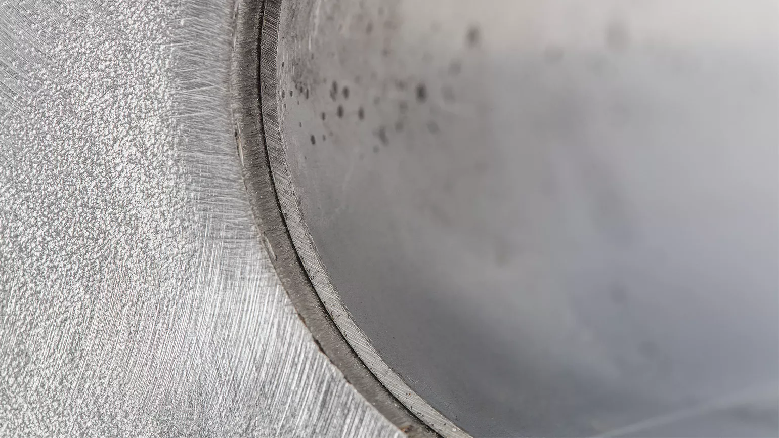

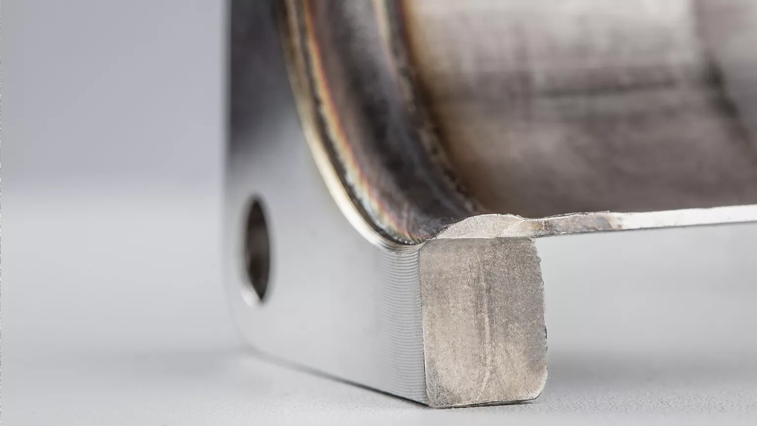

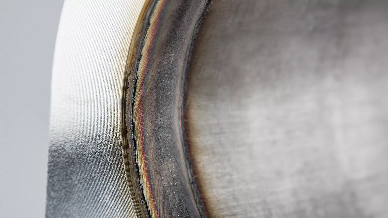

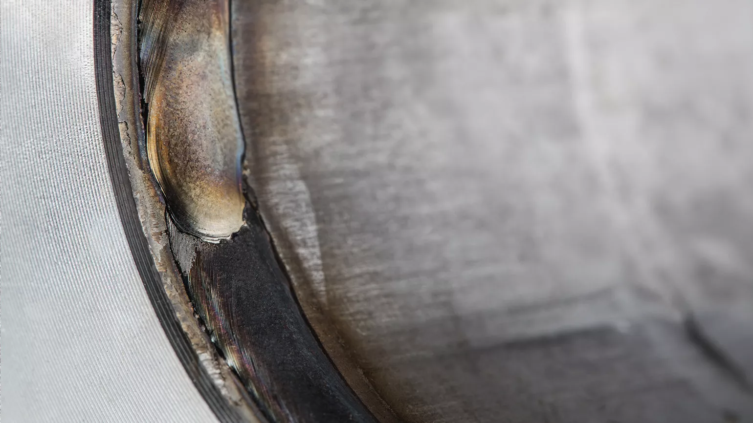

APPLICATION: FLANGE - EXHAUST SYSTEMS
/ Process: CMT
The focus here lies on the practically spatter-free welding process at a high welding speed and with high-quality results.

WELDING PARAMETERS
Base material Chromium
Material thickness 10 mm (flange) / 1 mm (pipe)
Filler metal  CrNi 19 12 3: 1 mm
Gas Ar+2.5% CO2
Vs  150 cm/min
Vd  12.7 m/min
Amperage 208 A
Voltage 18.4 V
