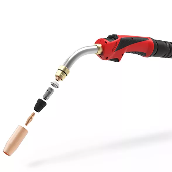

Wire problems
  1. Check the welding system and all its components (welding torch, wirefeeder, connections, cooling circuit, etc.) to ensure they are in good condition and free from external defects (pinched cables, leaks).
  2. Use wearing parts of torches and feed rollers that match the wire diameter.
  3. Ensure that the contact pressure of the wire feed rollers of the wirefeeder is set correctly. Check them for wear. Please refer to the operation manual.
  4. If it has been a long time since the inner liner was last changed, we recommend replacing the wearing parts of the torch hosepack. Instructions (how-to videos) for water-cooled and gas-cooled variants can be found on YouTube. Wear part kits (BasicKits) can be obtained at any time from our sales outlets, from a Fronius Service Partner near you or from the online shop (Austria and Germany).
  5. Blow out the inside of the wirefeeder with compressed air (max. 6 bar). Metal dust can accumulate and cause a blockage in the inner liner.
  6. If your welding torch is more than 10 years old, we recommend purchasing a Fronius welding torch of the latest generation. Welding torches for all Fronius welding machines and wear part kits (BasicKits) can be obtained at any time from our sales outlets, from a Fronius Service Partner near you.
  7. Spare and wear parts can be found in our online spare parts catalog.
