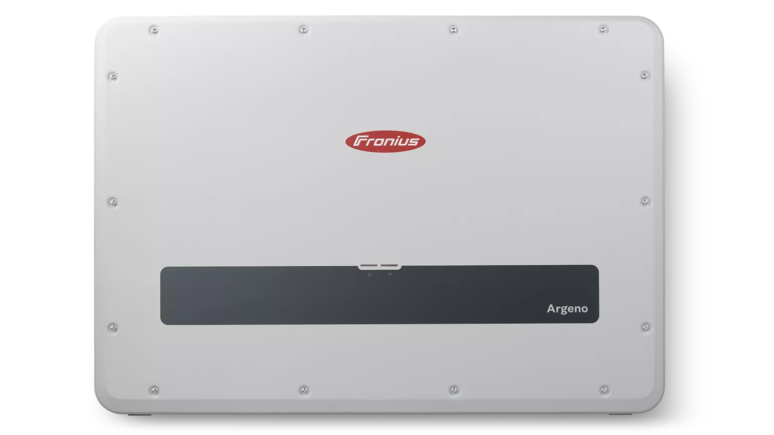

Argeno
Technical Data
Input Data
| Number of MPP trackers | 10 |
Max. short circuit current, module array* | 25A |
Feed-in start voltage (Udc start) | 250 V |
Nominal input voltage (Udc,r) | 620 V |
| Number of DC connections | PV1 - PV10: 2 |
| Min. MPP voltage (Umpp min) | 550 V |
| Max. MPP voltage (Umpp max) | 850 V |
Max. input current string (Idc max, String) - 30 A Option | 20 A |
Output Data
Max. output power (Pac max) | 125 kVA |
AC output current (Iac nom) | 180,4A |
Grid connection (Uac,r) | 3~ NPE 380/220 , 3~ NPE 400/230 V |
AC voltage range (Umin - Umax) | 305-560V (phase/phase) |
Frequency range (fmin - fmax) | 45-65Hz |
Power factor (cos φac,r) | 0,8 ind./cap. |
General Data
| Nominal voltage | 400/230V, 380/220V |
| Mains Frequency | 50 Hz 1/s, 60 Hz 1/s |
| Dimension / length | 330 mm |
| Dimension / width | 1070 mm |
| Dimension / height | 755 mm |
| Dimension / depth | 330 mm |
| Weight | 85,15 kg |
| Degree of protection | IP66 |
| Protection class | 1 |
| Night-time consumption | 4,8W |
| Min. permissible ambient temperature | -25 °C |
| Max. permissible ambient temperature | 60 °C |
Max. altitude 2) | 3000 m |
| Interference emission class | A |
Efficiency
| Max. efficiency (PV - grid) | 99,1 % |
| European efficiency (ηEU) | 98,7 |
η at 5% Pac,r 3) | 97,04 |
η at 10% Pac,r 3) | 98,68 |
η at 20% Pac,r 3) | 98,03 |
η at 25% Pac,r 3) | 98,95 |
η at 30% Pac,r 3) | 99,07 |
η at 50% Pac,r 3) | 98,93 |
η at 75% Pac,r 3) | 98,63 |
η at 100% Pac,r 3) | 97,74 |
| MPP adaptation efficiency | 99,81 |
Technical Data
| Grid connection | NPE, NPE |
