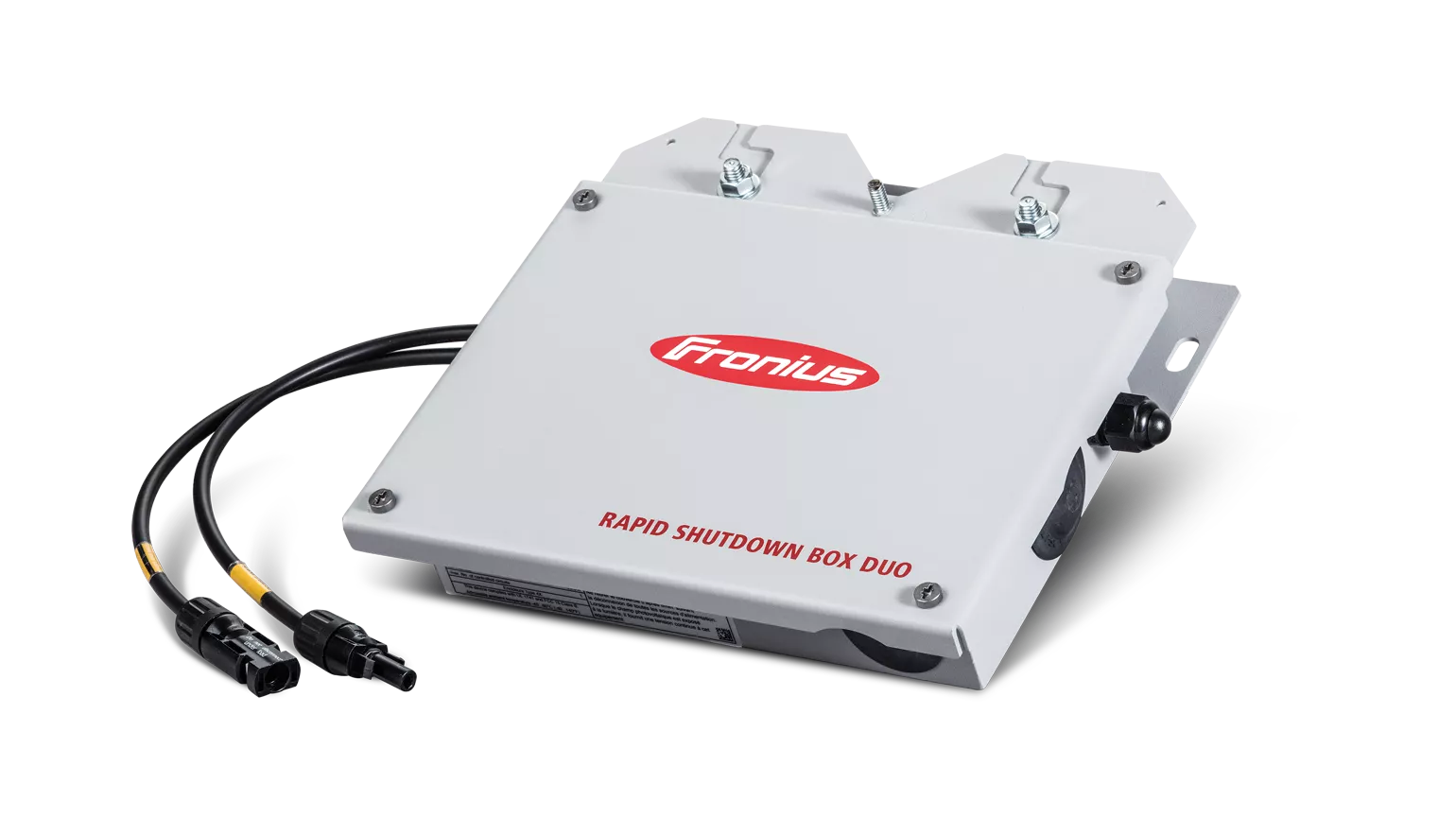

Technical Data
General Data
| External hardware required | No |
| Dimension / length | 71,5 mm |
| Dimension / width | 286 mm |
| Dimension / height | 246,5 mm |
| Dimension / depth | 71,5 mm |
| Weight | 1,8 kg |
| Max. usable input current | 25A |
| Max. input voltage | 600 V |
| Ambient Temperature Range | -40°C - +65°C |
| Degree of protection | NEMA 4X |
| Power supply | DC (from the PV array) |
| Compatible inverters | Fronius Galvo, Fronius Primo, Fronius Symo (excluding the Fronius Symo 15.0-3 208) up to 600V |
Technical Data
