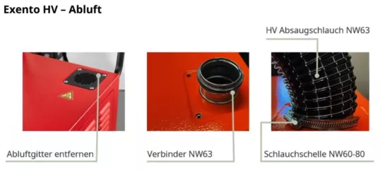

Choose the 3-phase configuration of the Exento HighVac for such exhaust air solutions. This ensures sufficient reserve capacity when the filter gradually becomes saturated. For further information, please contact your Fronius consultant at the Technical Competence Center (TCC). We will be glad to help you with the setup.

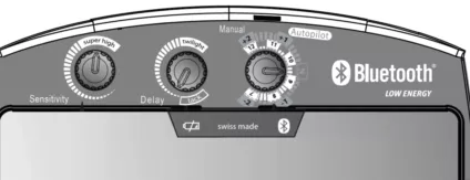

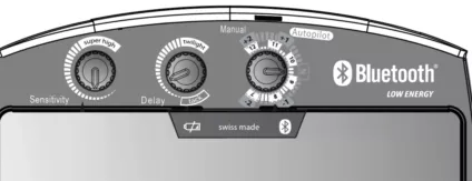

There is no need to worry. Your eyes are protected by the permanent UV and infrared filter.
Our recommendation for the default setting:
Set the control to “Autopilot”
 Safety helmet settings
If the helmet does not darken sufficiently, increase the degree of darkening with the “Sensitivity” control. The setting goes up to “super high”.
Do you have a Vizor Connect? First charge the helmet via the USB-C connector. If you have a different Fronius helmet, please insert new batteries (CR XXXX).
Note: When changing batteries, remove the plastic film from the battery.

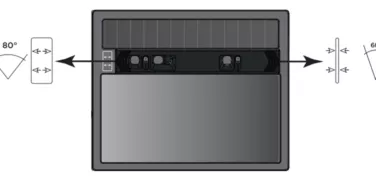

The sensor slider can be set to two different positions. The angle for detecting ambient light is reduced or increased depending on the position.
 Helmet sensor slider  Positions

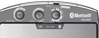

Slider to Autopilot

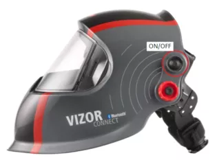

The grind mode button serves as an on/off switch for the connect mode.
In the off position, the welding helmet works conventionally (no LED indicator).
In the on position, the welding helmet reacts by wireless control via the welding machine (after successful pairing, the blue LED indicator lights up continuously).

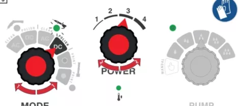

To polish, place a new cleaning felt on the cleaning electrode. Fill the tank with the red cleaning electrolyte.
Polishing power standard values (POWER):
  • Cleaning electrode 10 mm / 0.39 inch: 1 - 2
  • Cleaning electrode 22 mm / 0.87 inch: 1 - 3
IMPORTANT! The 45 mm / 1.77 inch cleaning electrode is not suitable for polishing.
 Settings for polishing
